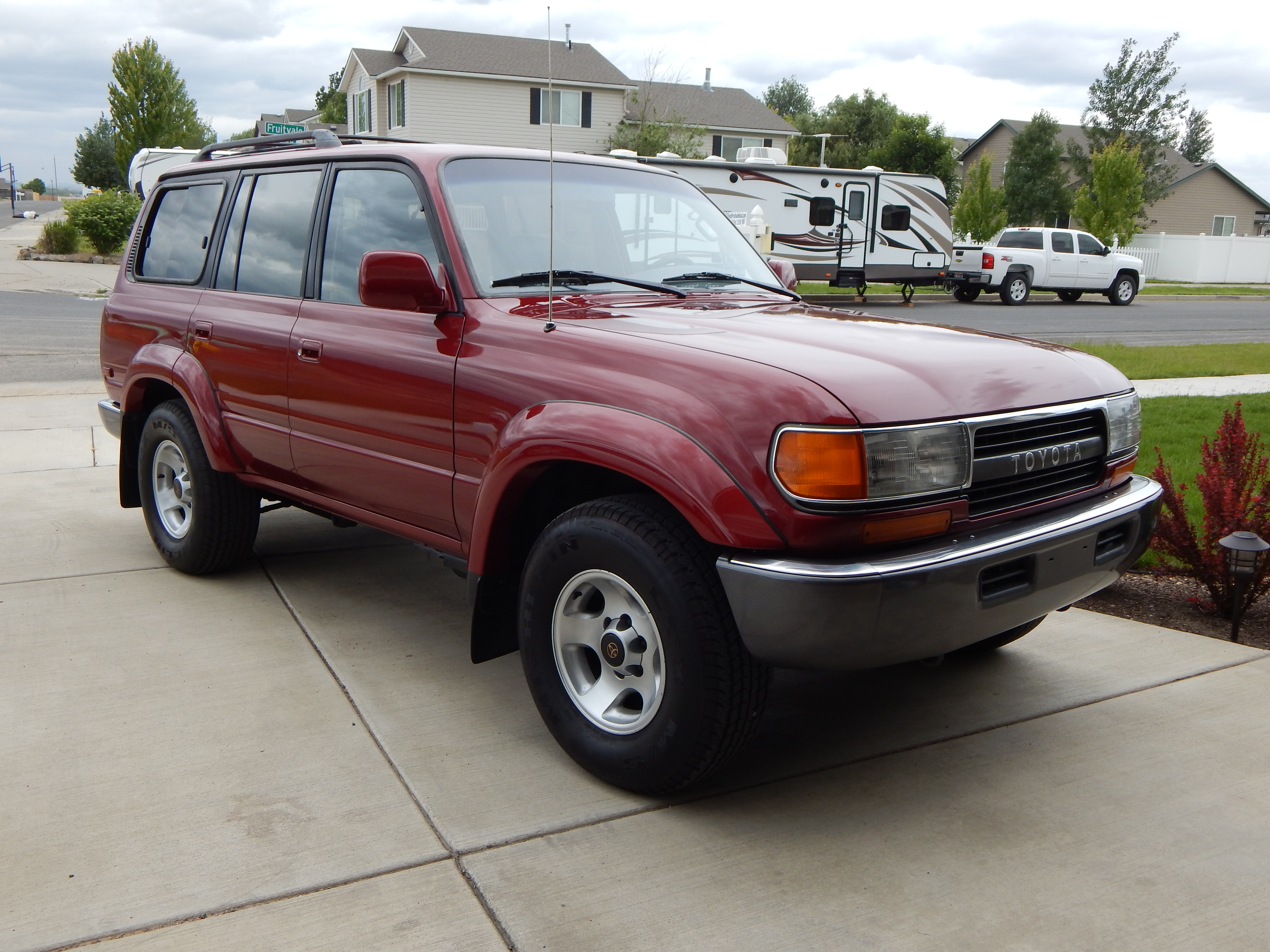

Well after I rolled my 95 Tacoma wheeling in Oregon this beautiful 1993 Land Cruiser fell into my lap and now I guess I have to make another forum account and build thread. Maybe I'll remember to update this one more than my Taco. It is a triple locked, automatic transmission, 6cyl short bus. She runs like brand new and looks like it too. Came from it's first owner in California straight to me. :)

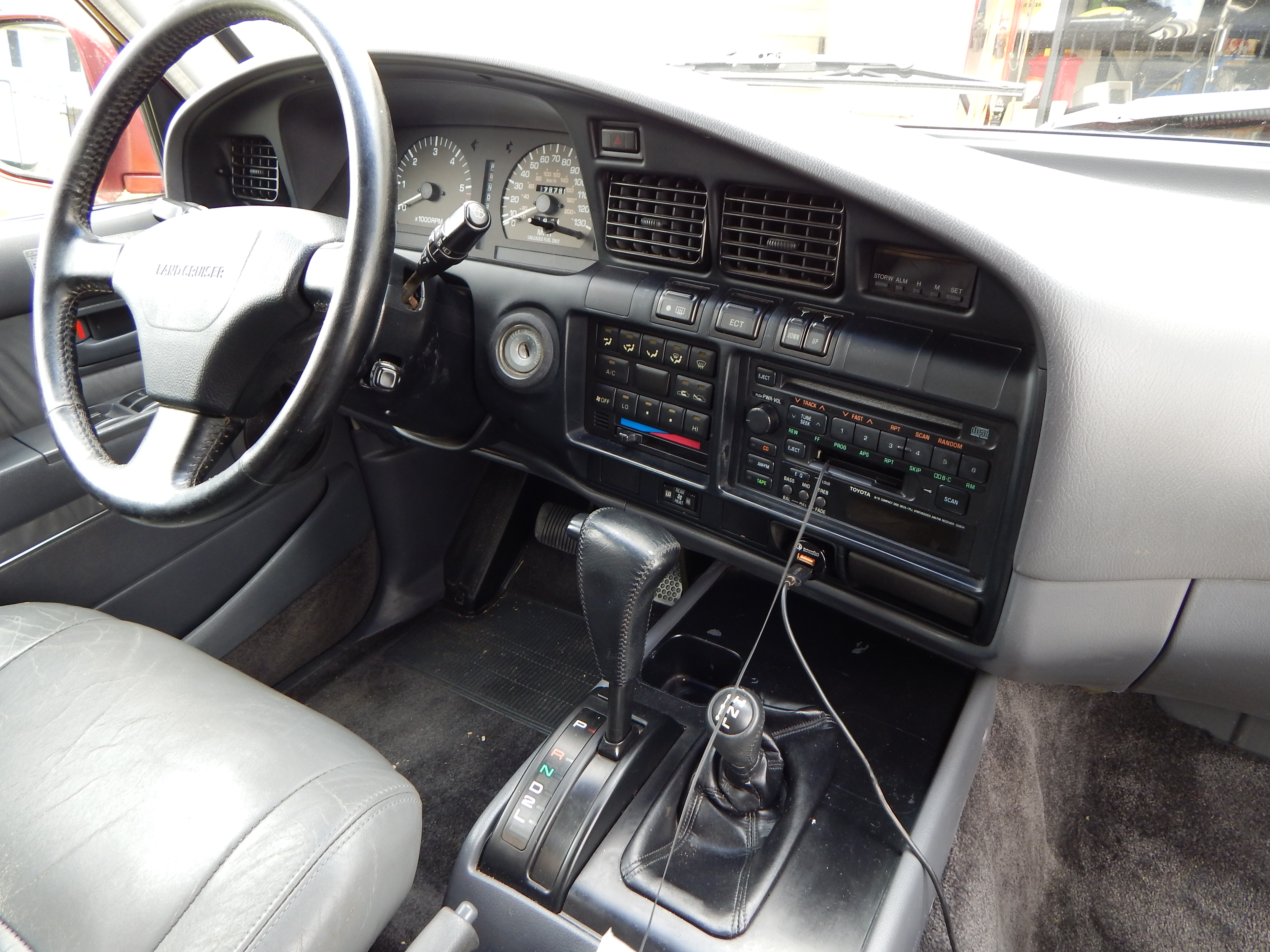

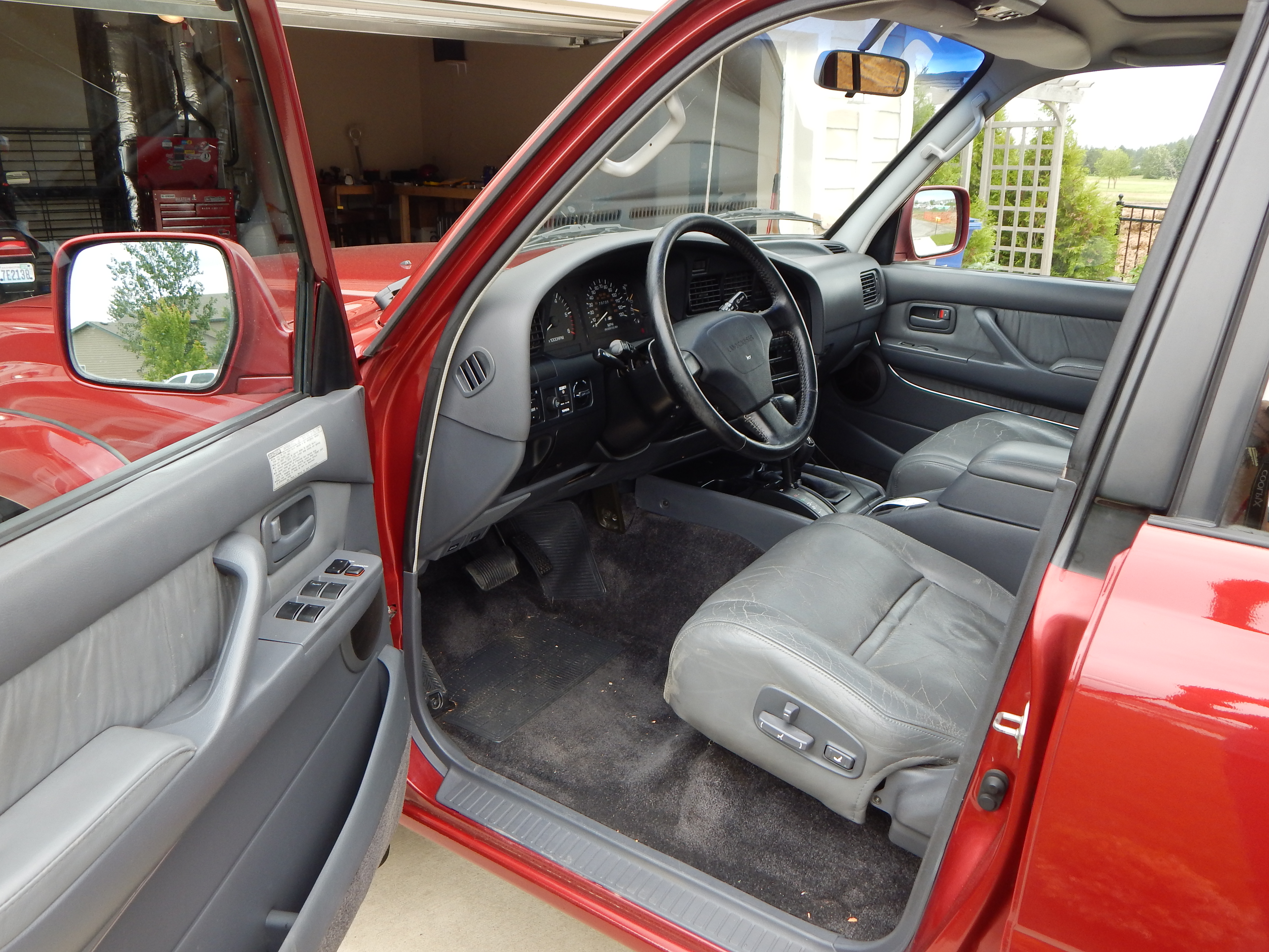

I don't think my cruiser is feeling good, the dash puked out a whole bunch of rotten 90s hifi nonsense.
img_20170703_185609584-jpg.1595443
That thing's redder than a puppy dog's ding dong.
Beautiful truck! Great score!

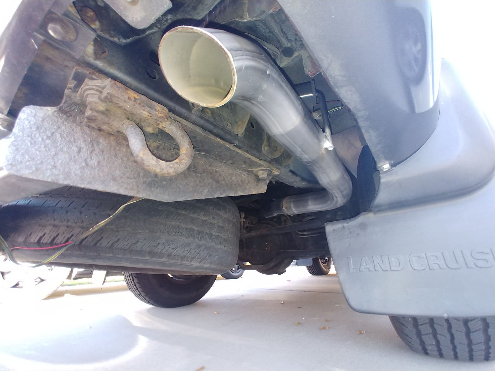

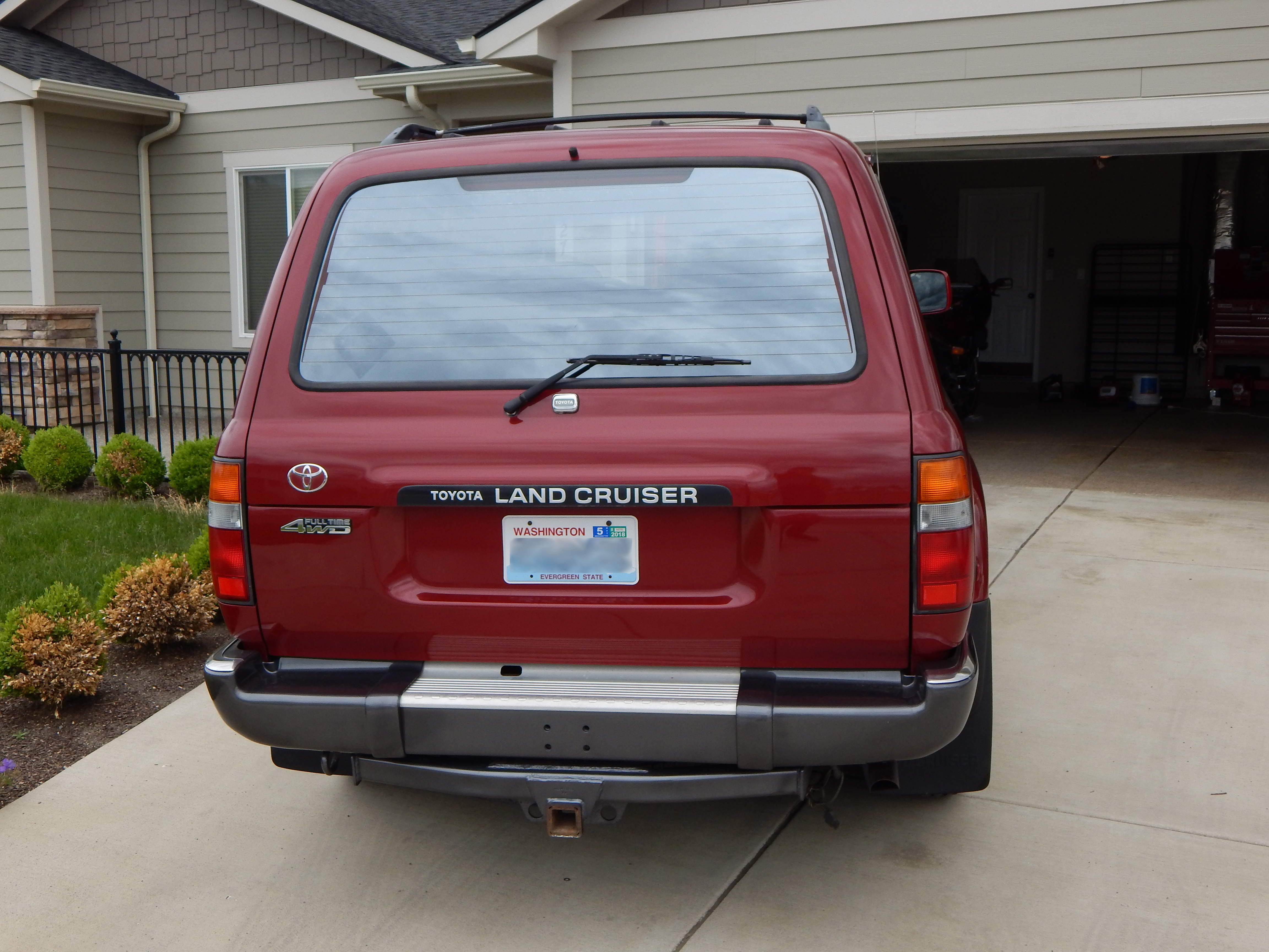

Have you tried getting those bolts off that hold your hitch on? Mine look about like that and they will not budge. I want to drop my hitch to replace some of the inner bumper parts with non-rusted parts, but I don't want to cut them because I use the hitch to carry my bikes with.
Thanks! When I installed my brake controller I used an 18" ratchet to break one loose so I had a place to ground the trailer socket. They're pretty high grade bolts so I don't think they're a huge risk for twisting off. For some reason the rear of my truck from the axle back is kinda all rusty like that. I'll probably take the whole hitch off eventually to clean some of that up, it came from and lived it's whole life in CA so not sure what that's about.

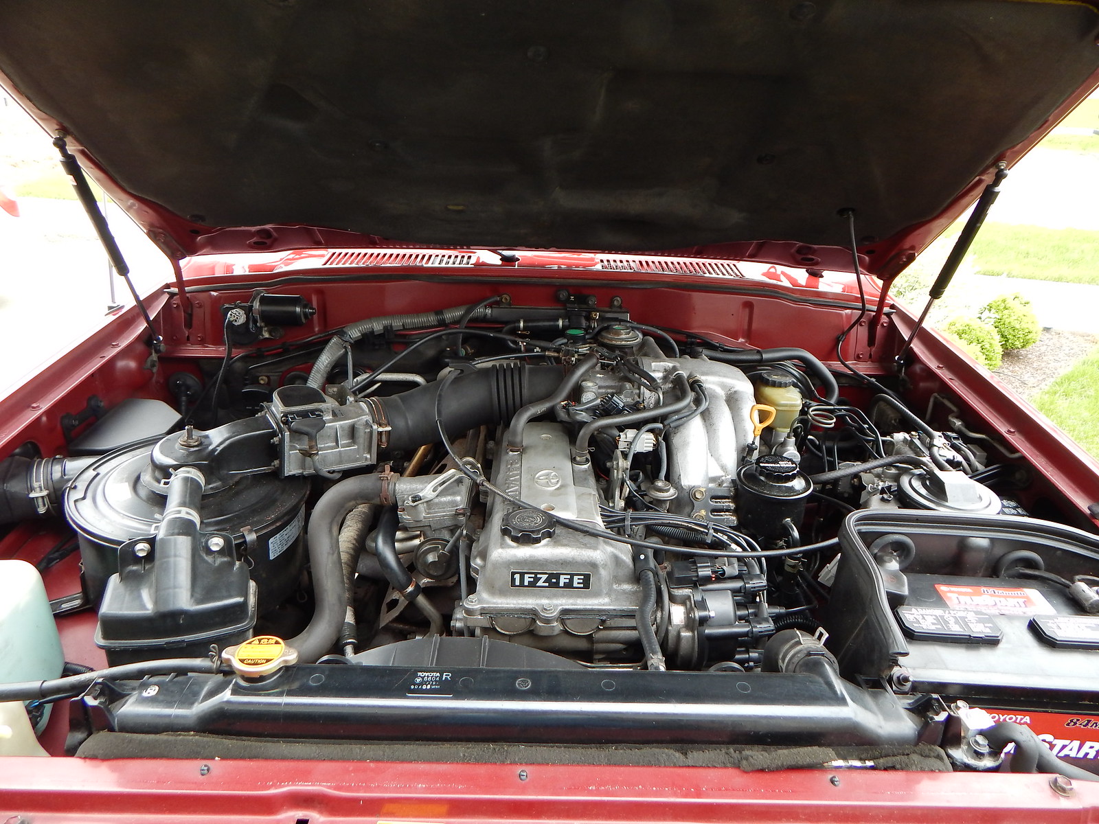

Well after three years of driving it and doing most of the regular maintenance I think it's time to service the engine in depth. I want to take it out and clean it up physically since it has a front and rear main leak the likes of which I've never seen and I think the oil pump cover is leaking too. Figure I'll pull her all apart and get the engine up on a stand to change all that out. I don't really want to rebuild the engine yet, it seems fine, but I'm considering doing the HG just because it'll be easy with the whole shebang out of the truck. I'll change all the rubber in the engine bay to some that hasn't turned to plastic yet and delete the smog stuff (EGR already killed part of my wiring harness), and I'll be refurbishing the wiring harness. I was considering just making a new one but feeling how pliable the wires underneath are I don't think that is necessary, they're only crusty where they laid near the EGR. Just need to take some time to gather parts, this will be my end of summer project that needs to be finished by hard winter (Jan) when we get all our snow. I don't want to drive my tacoma in the snow if I don't have to.

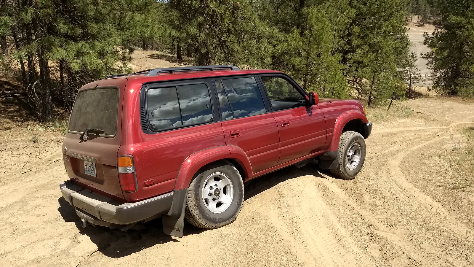

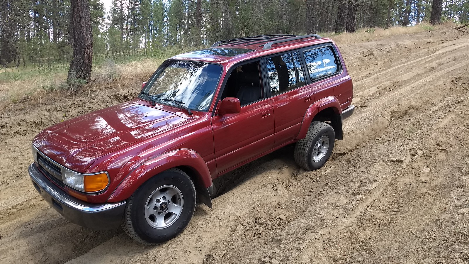

Oh and I guess I should throw a picture or two in since for a little bit I used my tent on the cruiser until I could buy another Tacoma and I also threw some 33s on.
Untitled by Zane, on Flickr
I've since pulled the tent back off and put on some new shocks.
These oil leaks are most likely the oil pan arches. The rear main seals are not a common issue. Mine has 302k miles and no leak. The front crank seal is easily replaced while you replacing the oil pump cover O-ring.
I, and many others, have done everything you want to do without removing the engine. Room to work is one of the great things about an in-line six.

I'll give it a really close look, I would much rather leave the engine in, it's been leaking pretty hardcore for the last three months and I can't quite see the front leak but the rear always ends up dripping right off the front of the trans bellhousing. I was just going to make my time worth it if I pulled it, I need to delete the rear heater and the emissions junk anyway. But other than dealing with the EGR pipe, most of that is still easy in the truck.

Once the engine is at operating temperature, remove the inspection cover from the bottom of te bell housing, start the engine and then use a mirror and flashlight to look up inside the bell housing directly at the rear crank seal and rear of the engine block below the seal. This is how I determined that mine was not leaking a few years ago.
Be mindful that the ring gear is rotating right there and will destroy a mirror instantly.

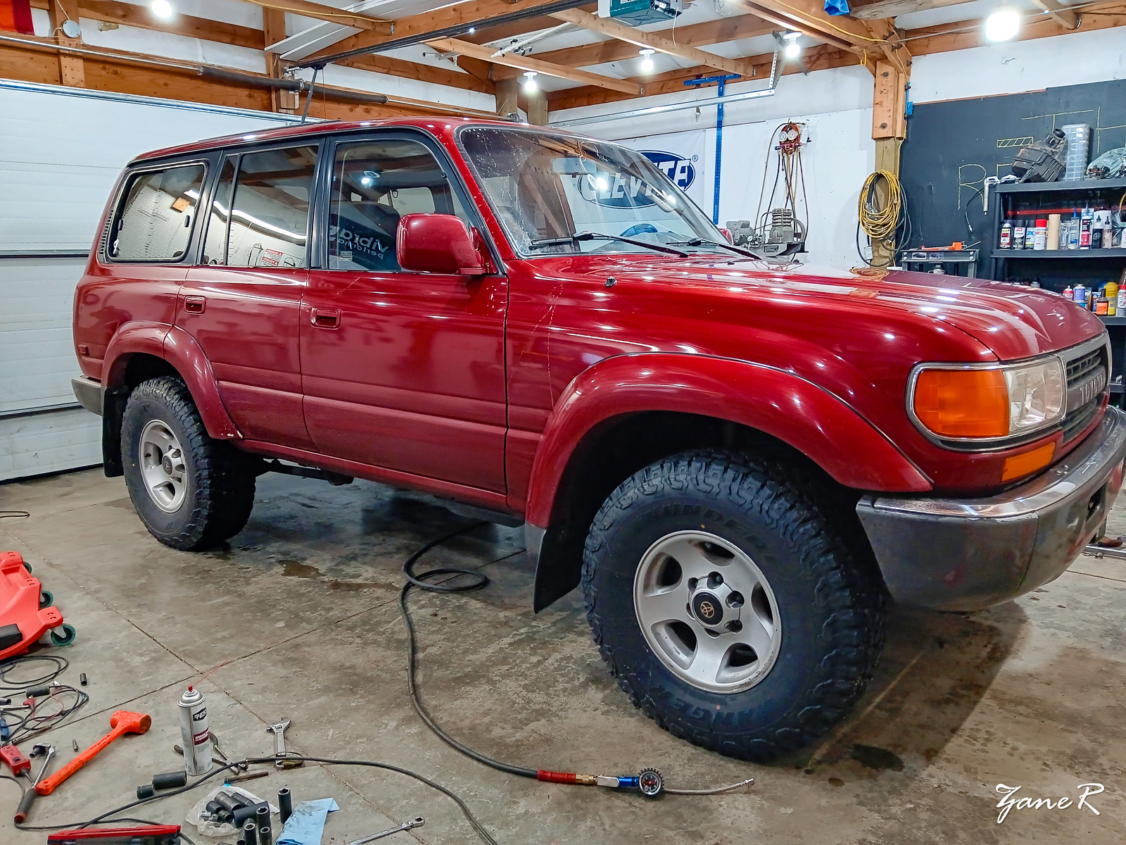

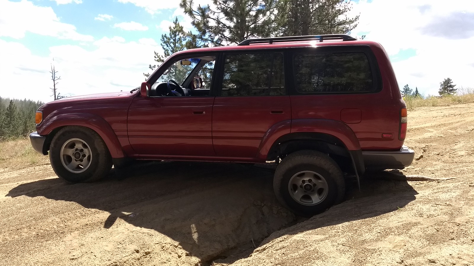

I never update this thread, but I'm also fairly confident no one reads it haha. 99% of the time my Land Cruiser takes a backseat in the garage over my Tacoma or my little daily s***box Corolla. But I've had a big burst of motivation and energy to work on the LC lately (thing just feels tiring to work on compared to the others, and it is all boring maint vs actual fun parts). But nevertheless I had some pretty pressing stuff to take care of, the CDL had stopped functioning, so I pulled it and miraculously it works perfect now, I think the connector was just not making good contact. I was totally prepared to swap in a 100 series CDL actuator, guess that's a spare part now. Didn't take any pics of that but I did when I put some new tires on the old pig, I mostly use it in the winter since it is such a good snow rig. So I got some three peak snow rated ATs and so far I'm very happy with them.
