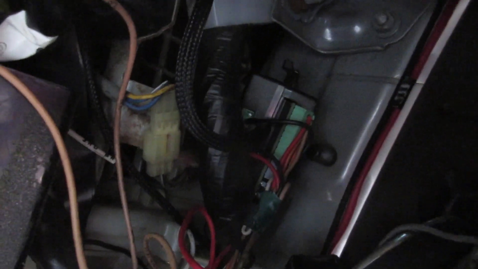

I've been watching videos about how to hook up my radio and I think that speedometer box is right behind the factory amp . Here is a photo of it . You might have unplugged that wiring harness.
