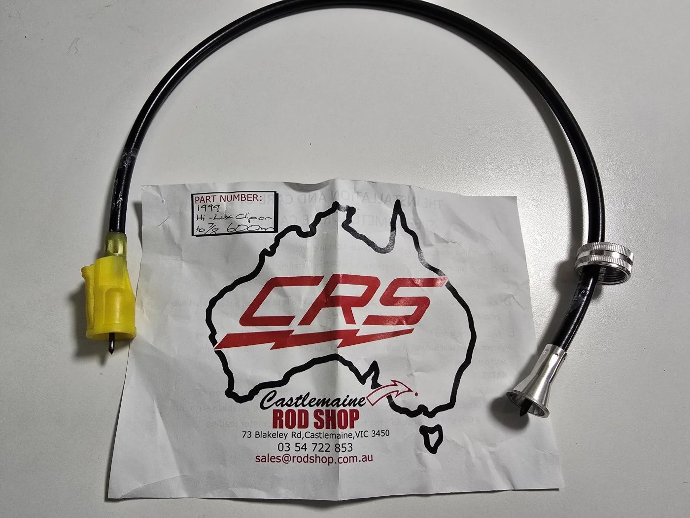

Yeah. My biggest issue is the price. I would love to just change a gear, but this would definitely be the next best option. D0you happen to know what the size cable is for a Hilux?
I hear ya on the $ side of things - mate, I have to deal with USD:AUD exchange.
In terms of "size", what are you after?
The cable that came with the package that I bought was fabricated by the supplier (refer pic). The cable itself is 600 mm long. You can see from the pic that the Speedbox connector (refer Speedhut / Speedbox web page for tech specs) is on the right and the connector to the installed instrument cluster speedo is on the left (yellow housing).
Does that cover your question?

In terms of "size", what are you after? View attachment 3975345The cable that came with the package that I bought was fabricated by the supplier (refer pic). The cable itself is 600 mm long. You can see from the pic that the Speedbox connector (refer Speedhut / Speedbox web page for tech specs) is on the right and the connector to the installed instrument cluster speedo is on the left (yellow housing).
