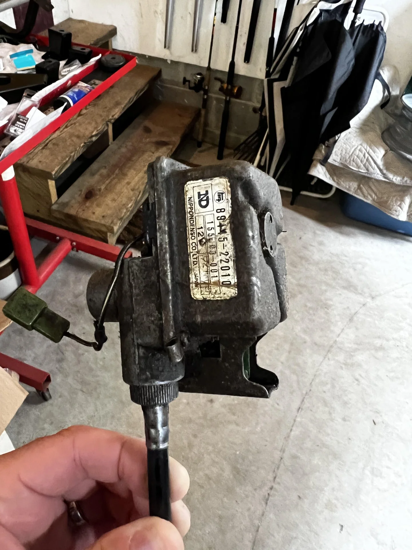

I'm building back my '76 FJ40, and I question whether there are pros and cons to installing the original speedmarker that was mounted on the firewall. (Pic below) It uses a 2 piece speedo cable and I need to replace the cable.
I would rather get a single cable to run directly to the speedo without the speedmarker in between.
What exactly is a speedmarker? Does it provide an electrical signal to other components? I read where it provides an alternate means of determining how many miles are on the truck, which I really don't care about.

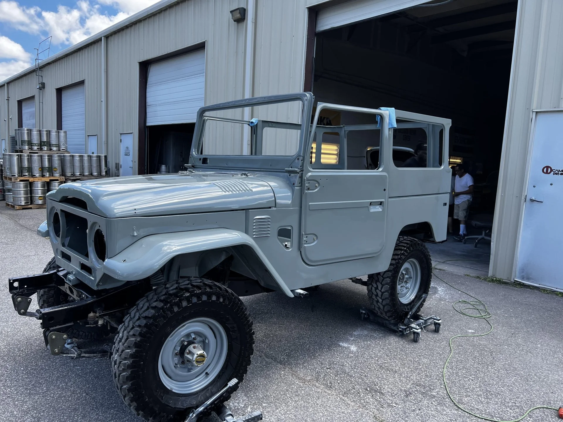

Also below are a few build pics. I know it's not a purist paint color, but it is Toyota Lunar Rock.

It's just another odometer inside and isn't crucial to any electrical components I'm aware of. Left mine on anyway last time I replaced the speedometer cable.
Your 40 looks great so far, love that gray.
Since I am a purist, I would restore it and have it function. Also, I believe the second odometer was reference for maintenance intervals. A piece of history. The very least I would go single cable and still restore the unit and keep it.
there is a paw inside that trips a switch every 50k(?) miles, that illuminates the egr service light.
nothing wrong with running it, if you can find decent cables....i got tired of replacing $or one pc cables every 9months.
Can't wait to see that Toyo in day light. It looks more like Cement than Lunar Rock in the garage.
