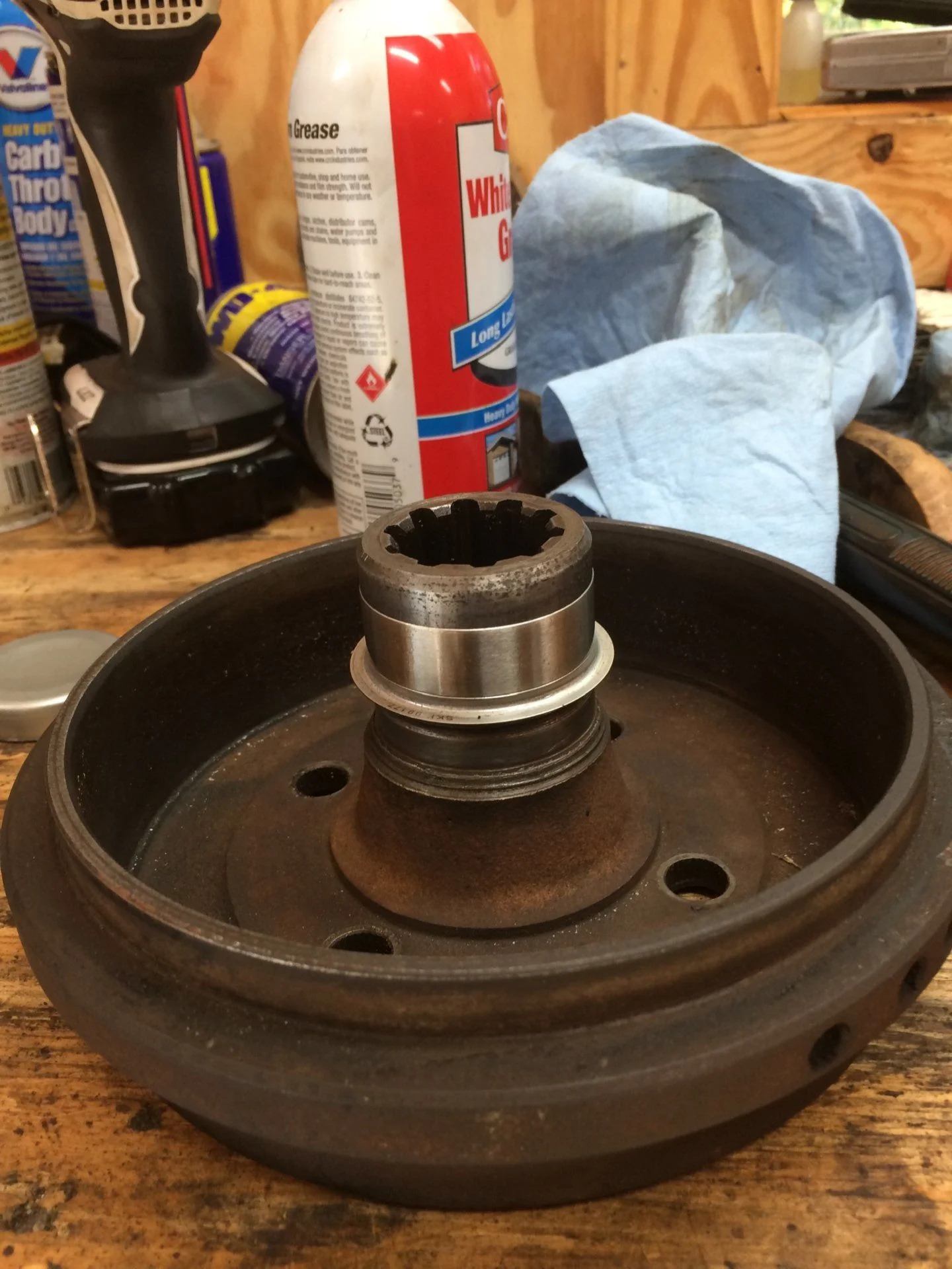

Putting speedi sleeve on parking brake hub. Used the install tool provided after putting jb weld on shaft. Bottomed out the install tool and sleeve still needs to go approximately 1/4 inch. So I got the sleeve off of hub, cleaned the hub back up and ordered a new sleeve.

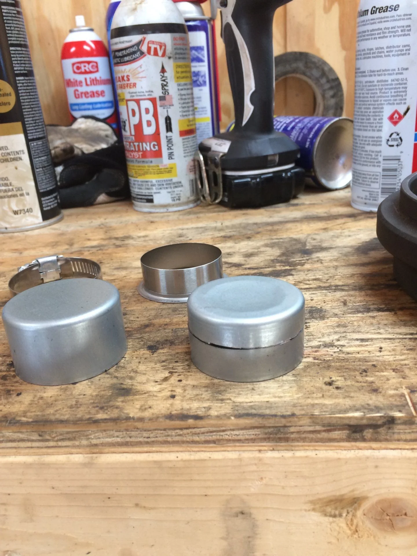

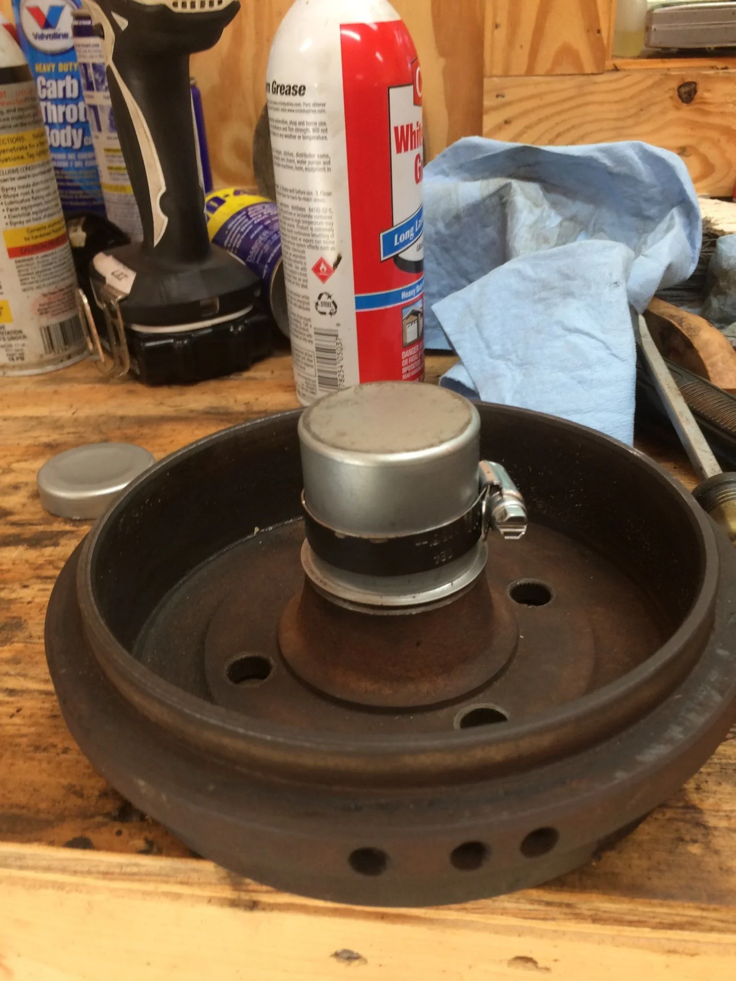

Thanks for your input. No, the lip broke off when I tried a square tubing to knock her down. So I have removed the new sleeve and ordered a new one. I have a plan though, I took the old installation tool and cut about a 1/4 inch off of the closed end. That gives me about 5/8 inch of sleeve. When I install new sleeve I will use the install tool that comes with it. When that bottoms out, I will remove it and slide the cut install tool sleeve then stack the newest install tool and place a radiator clamp to hold alignment and hopefully knock her to the right place.
I will post a picture when I get it together.

Successfully got it in the right place. Here are the pictures of how I did it.
