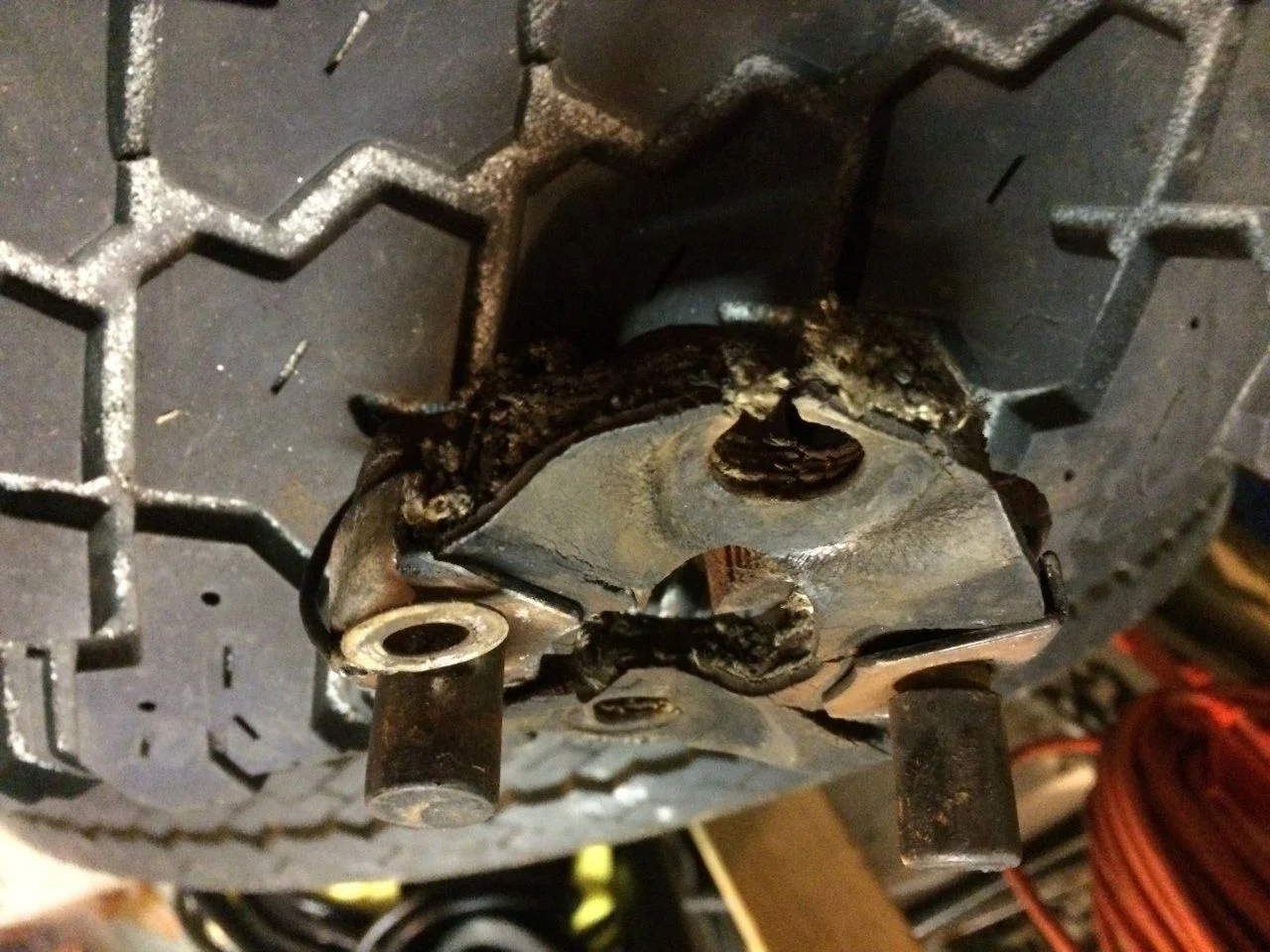

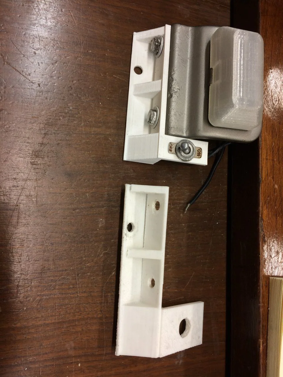

My prototype light bracket failed :)
Problem is the 3D printer only fills 10% of interior of object... had to up it to 50% and increased the gussets
Looks good ... be putting it in for kid test soon lol

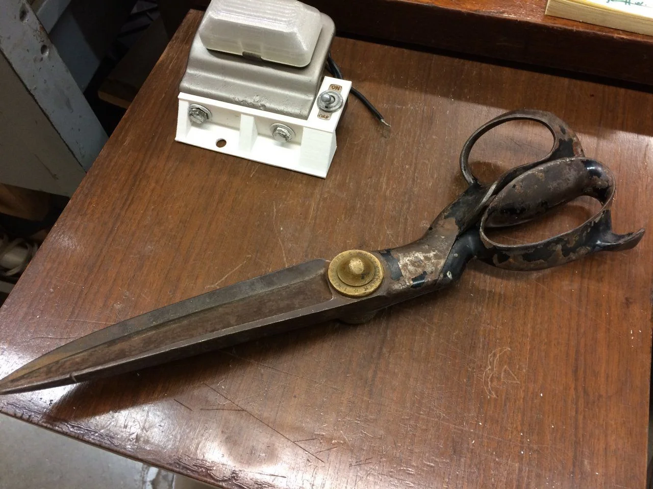

Also gifted to me was a pair of J.Wiss & sons tailors shears ... about 1900-1910

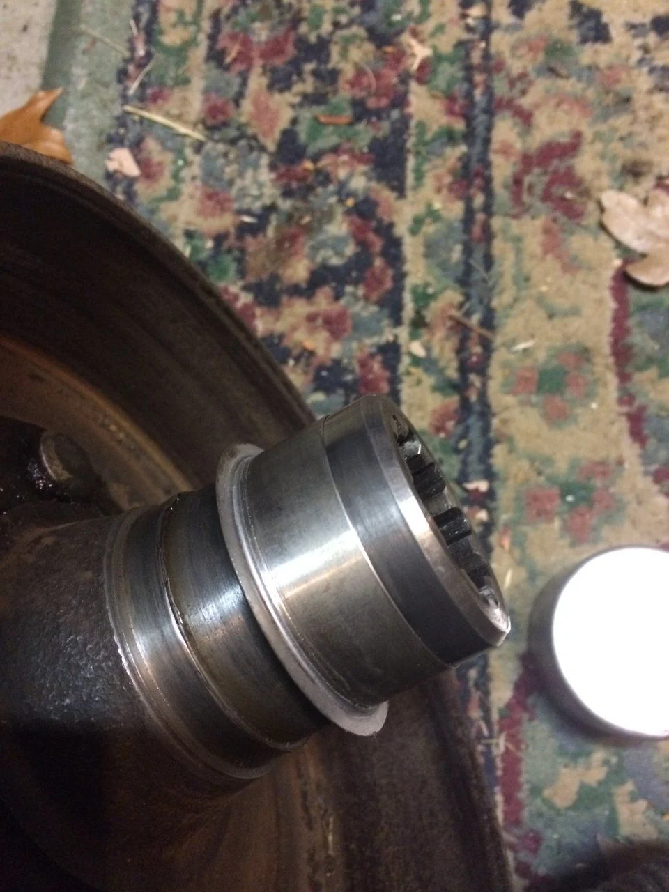

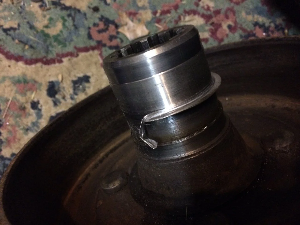

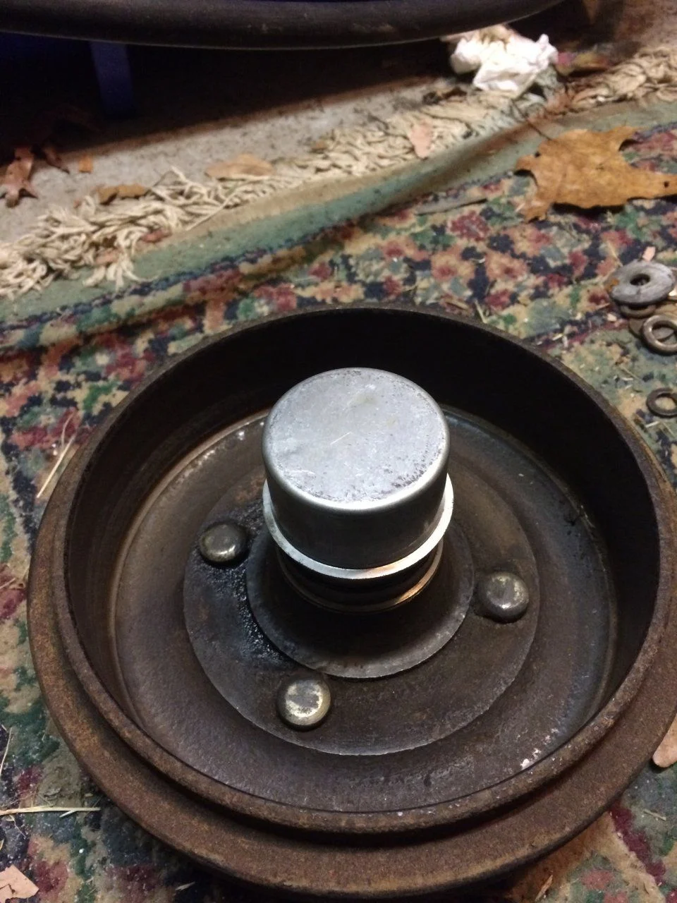

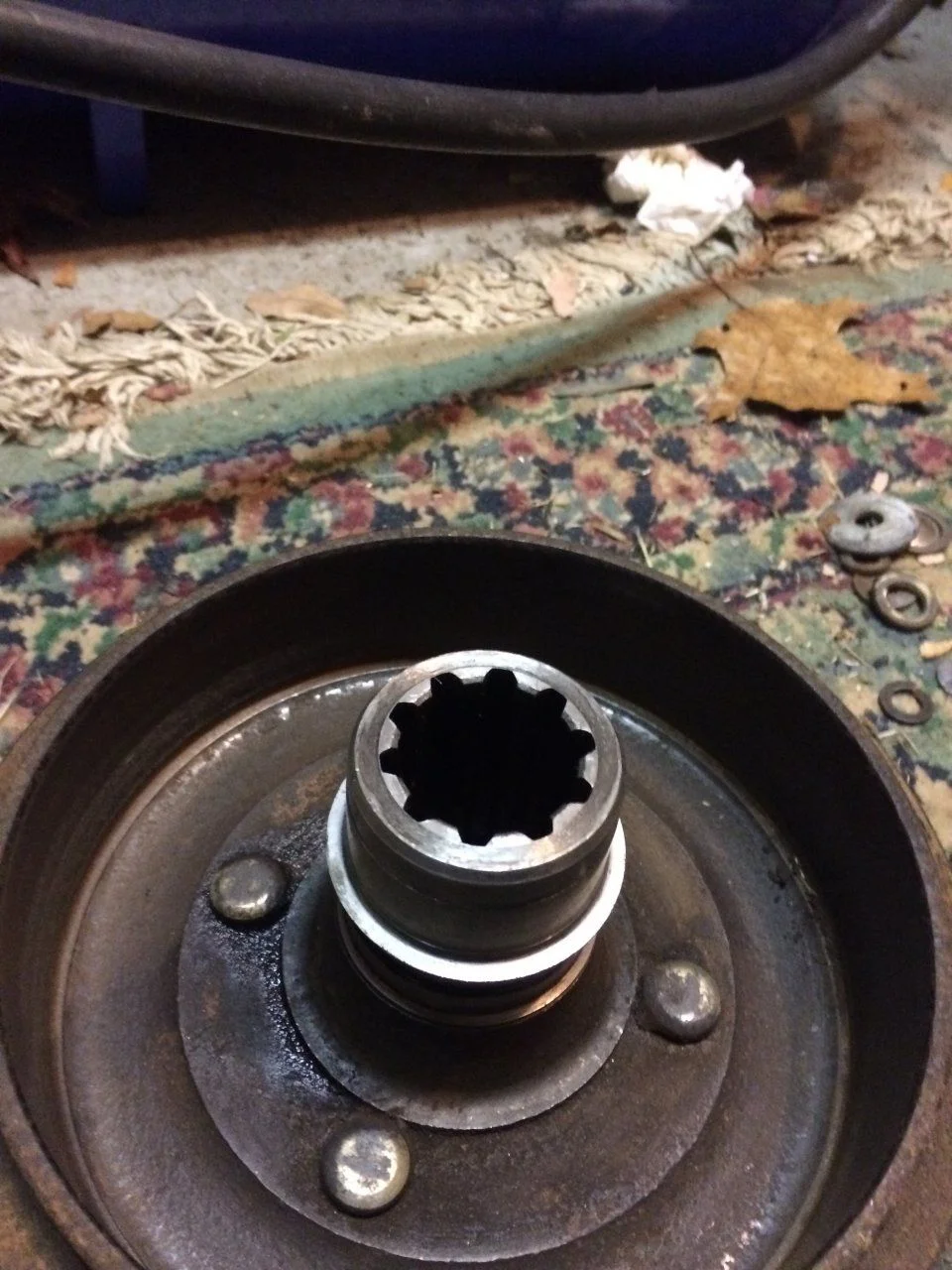

Was a bit of a bugger to get off ... but it finally did ... I read about using a pair of dikes and didn't use them at first and was messing it up ... when I remembered... and boy did it come off easy then
Step by step pics :)
All in all pretty easy to do

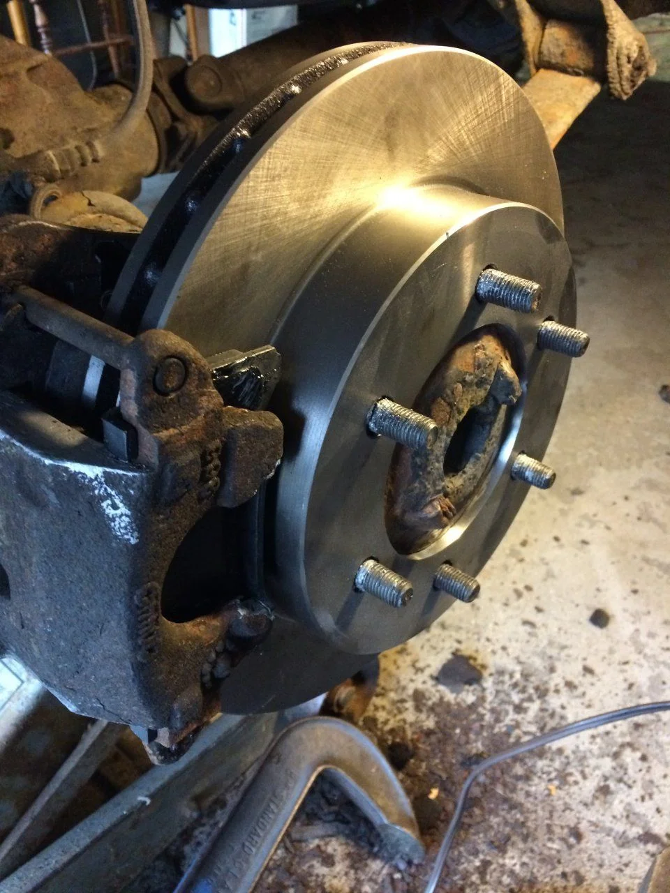

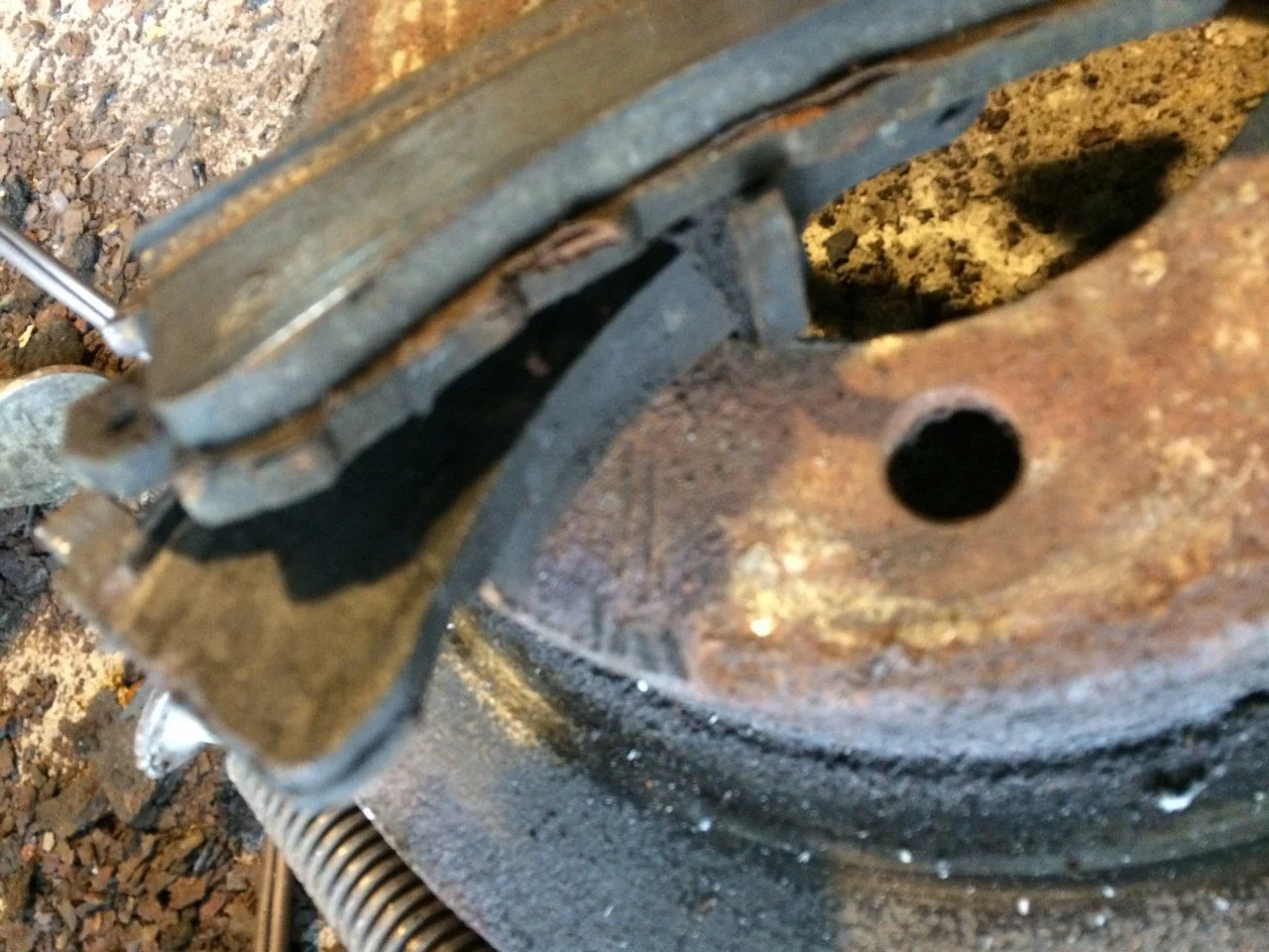

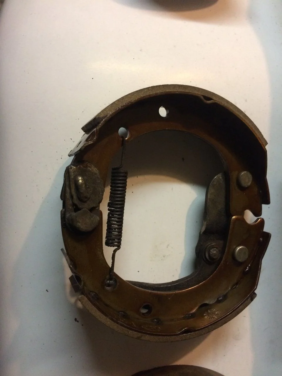

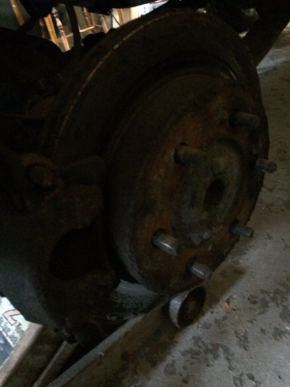

Rear brakes would have not passed inspection... so needed to replace them... I had these rotors for years and never cut out the centers
A buddy at work has a lathe that said he would cut them ( 4.175 )
I believe he cut them just a tad under that lol they didn't fit ... ran them quickly into work and sanded off a very little using the orbital drum sander... and then they fit perfectly
New pads and all is good :)
