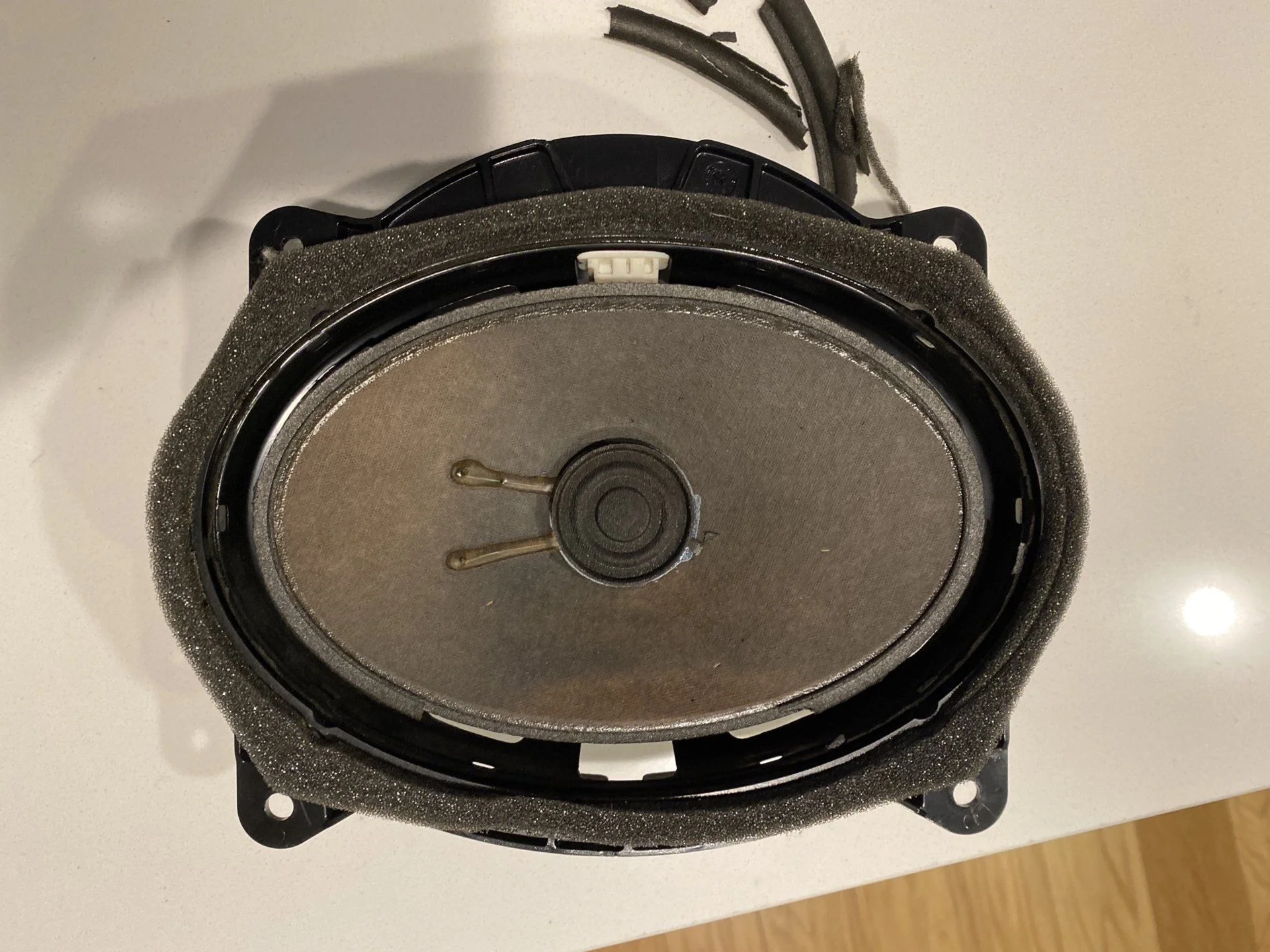

Just got my door panel off and my speaker looks flawless. Foam area around perimeter has no tears or brittleness. The sound (rattle/vibration) sounds like its coming from dead center. I’m pretty handy but I’m not a speaker or audio guy. Is there a way to fix that? Or is replacement in order? I’m trying to figure out how to post video.
Sounds like a blown voice coil to me. (At least 20+ year ago me knew that to be true when you put too much power to a subwoofer for too long or in too shallow a speaker box ...that is how it would sound to me). I would replace. Especially if you unscrew the speaker and hold it in your hand and it still makes the noise ...not just a errant speaker wire vibrating on the back of it.
blown speaker. Physical damage is usually due to time/deterioration of the material... Blown speakers are about the voice coil.
That's good to hear! You and I had completely opposite experiences, haha, pulled mine and there wasn't a single piece of factory foam remaining connected to the speaker(s), had to pick it all out from the bottom of the door:
Passenger side
Drivers side
