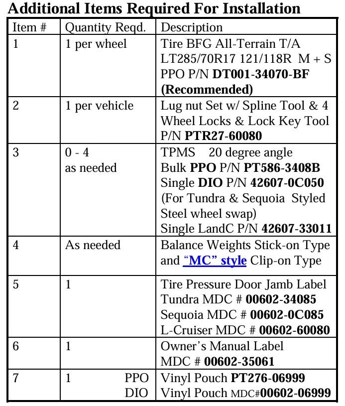

On the front page of the guide we find this:

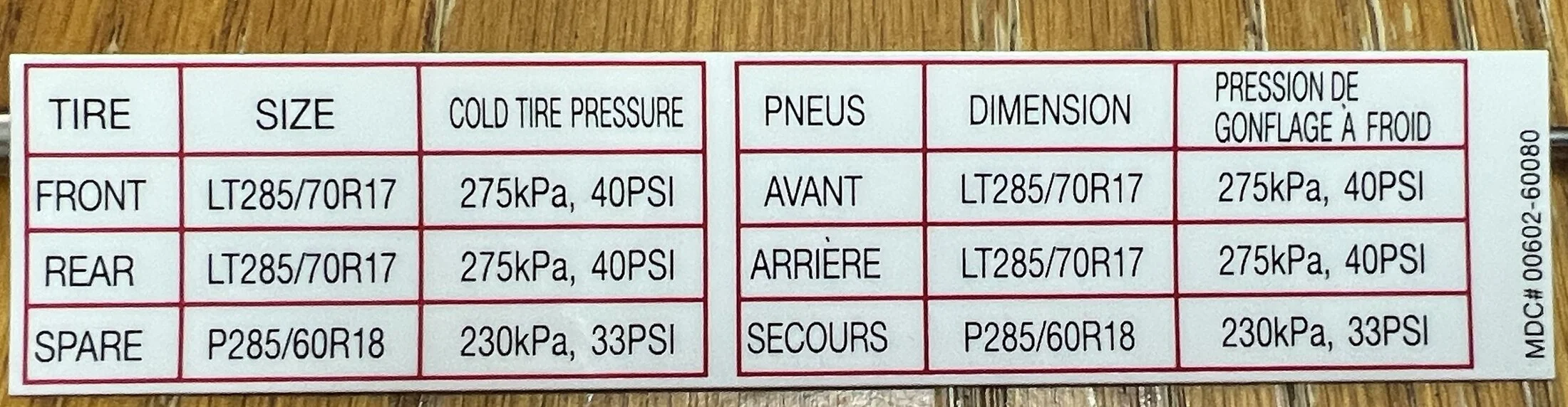

Item 5 refers to a Tire Pressure Door Jamb Label for the Land Cruiser MDC# 00602-60080. Here is a picture of that label:
Note that the 4 mounted tires are the LT285/70R17, but the spare remains the OE P285/60R18.
Apparently, Toyota have no problem with using the OE P285/60R18 tire/wheel combo as a spare should one of the LT285/70R17 tires fail.

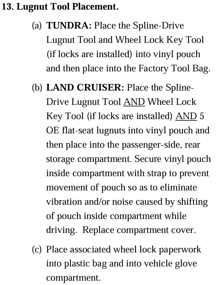

To further support this, later in the document, where after work follow-up is explained, we find this:
The important thing to note about this is that "5 OE flat-seat lugnuts" are required to be placed in the jack storage location. And why would those 5 OE lugnuts be required? To mount the OE 18" wheel that is in the spare location.
