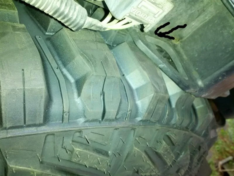

Hmm.. so i went under there with a friend, and we tried to install the spare. The tread of the tire was running into the tow hitch, am I doing something wrong?
Trying to attach a pic of what I'm talking about to this post, wish me luck!
Tires vary in size. What tire is that? I ran a bfg atko 295/75-16 in that location for years. There are also some variance in tow hitches. Which hitch do you have?

Measured with a tape measure, kind of sloppy like.. It's
about 33 inches. I think the metric calculator put it
around 32.8 or something. Reading online it said this
tire is "true to size". Not sure if most tires run
small or not?
As to which hitch I have, I'll go look for identifying
markings :) I wasn't aware there was any variance.
I had a 295/70R18 up under there. IIRC you have to flip one of the brackets to do that. IMO, the limiting factor isn't diameter, it's weight and clearance. That winch is only designed for a factory load. My tire setup is probably 1.8x the weight. Every time I hit a hard bump I winced, afraid that it was going to come off. Also it becomes the lowest point in the center of the vehicle from a departure angle standpoint. This was all before I got the rear bumper and moved it up.
