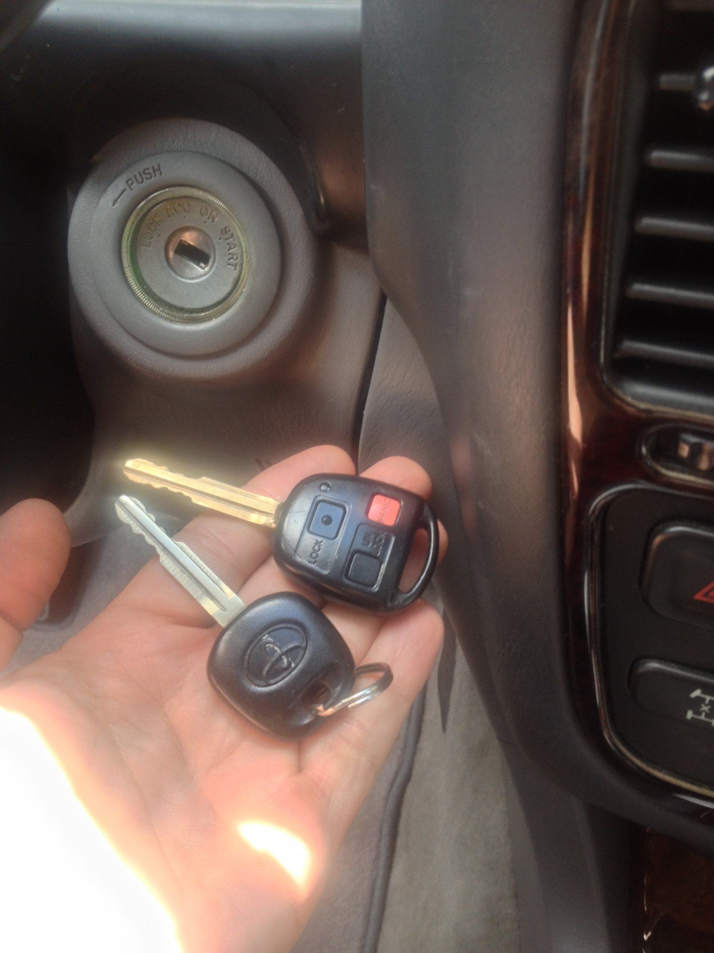

Below are the two keys. I held the one with the FOB buttons up to the ignition while I tried to use the other one.

I marked on your key where the transponder chip is located. With the spare key in the ignition, hold the part of the fob as close to the center of the ignition switch as possible and see if the red security light goes out. If the light goes out, your key should start the rig. It's possible your spare key either hasn't been programmed, or that it doesn't even have a chip. What do you know of the history of this key? It is possible that a PO just cut a blank for doors/glovebox. Cruiser shares a blank with other Toyota models that may not be chipped like the OEM valet key.
Ok, I put the spare in and then the main key. The main key light does not light up. The only time I see the light is when I press the lock or the unlock buttons. I do not know the history of either key, the main key looks stock with much use. The other key is Toyota but I know nothing about it.
The spare key does turn the ignition over, but it will just not start.

The transponder in your spare that isn't paired with your ECU is interfering with the working transponder in your other key. Get a $2 transponder-less key cut and I bet it will work.
If your other key is master, you could pair your spare with the ECU. IF it's a master...

I remembered that I had another non-oem key with my service records. I just tried it and it worked as long as the transponder from the other key was super close. I will see if I can get another key coded for a spare.
