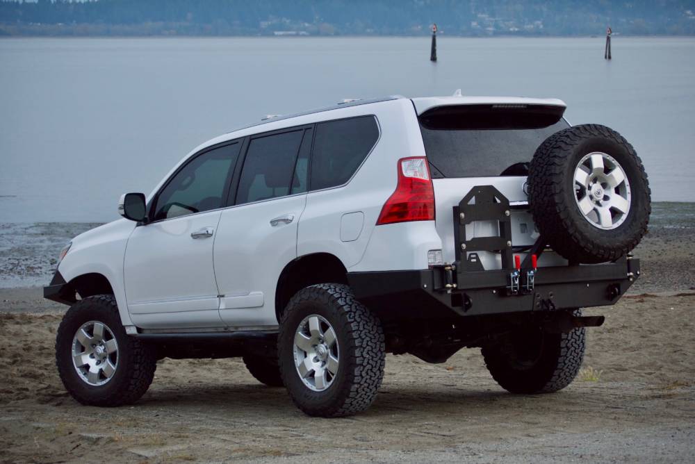

I’ll be needing a rear bumper with a tire carrier. Any of you with a rear swing out bumper have issues with the tire blocking the passenger side taillight? In most of the pics I see it looks like all of them completely cover it. Not sure if it’s really a big issue in the first place. Don’t want to put it on the rear door either.

  • Now bumpers, I have a MetalTech with swingout and all the accessories that go with it. I'm running about the largest tire within reason and it is not even close to obstructing my taillight. I really don't think any of them do unless you mount a 40" tire or something stupid big like that. You should be fine. Personally, if I were to do it all again, I'd do aluminum bumpers all around and lighten my rig. NOTE: With a swingout, you will have to relocate your backup camera, license plate (& light).

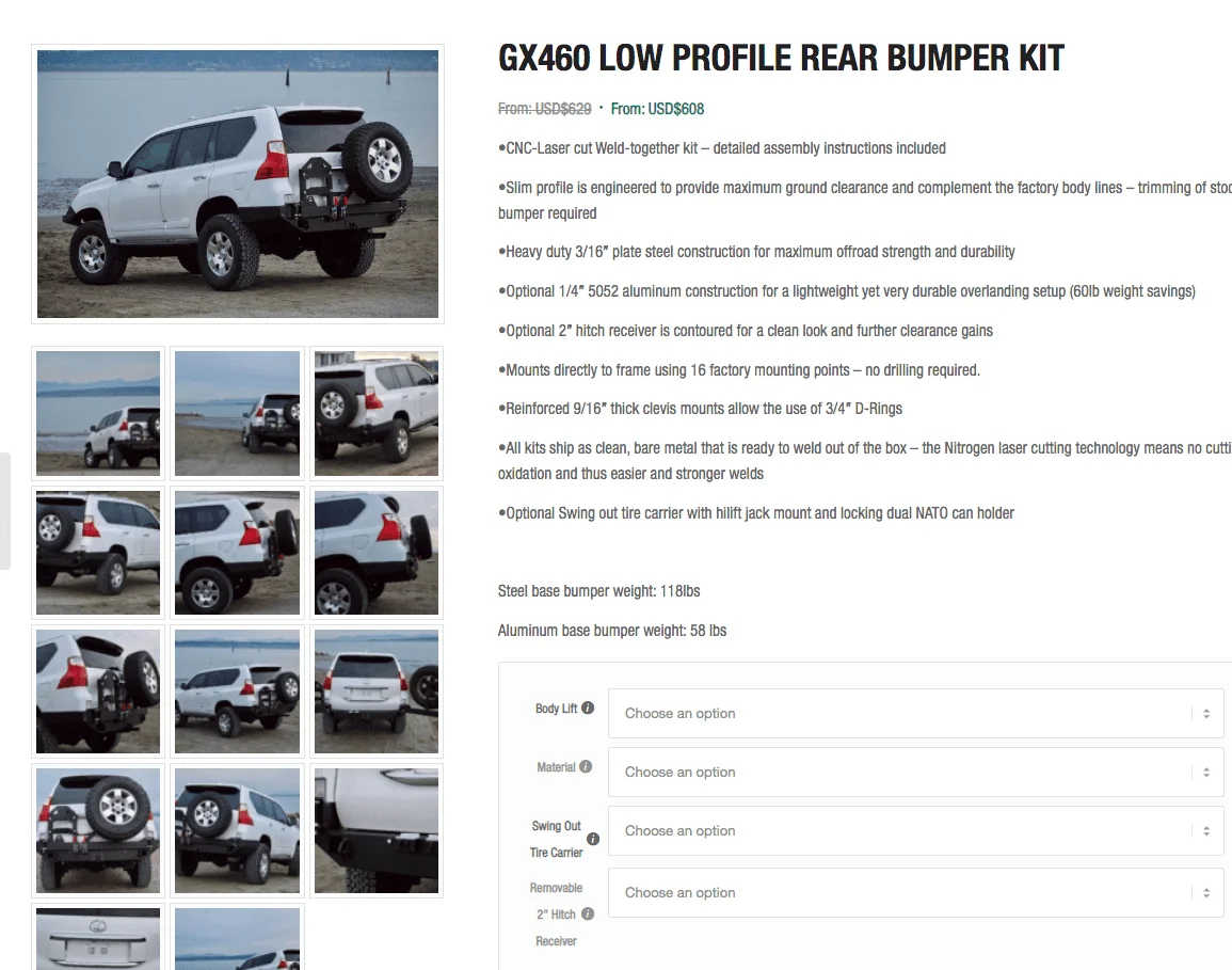

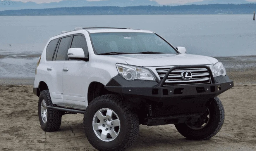

Rear bumpers in the works from Demello, 4x4Labs, Victory and C4.
Great news for sure. More choices on the market is always a good thing.

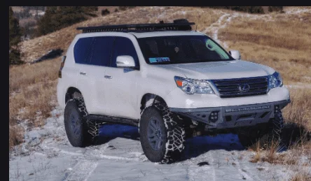

Any word on additional front bumpers in the pipeline for the 2010-13 GX?
From what I have seen, there are a few choices for the 2014-up front end, but not much for the 2010-13...
Since I’m still a ‘newb’ on the GX platform, maybe I’m just not looking in the correct places.
-George

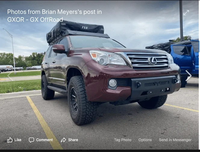

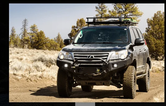

lab rat: I think C4 might be coming out with another bumper for 10-13 models.

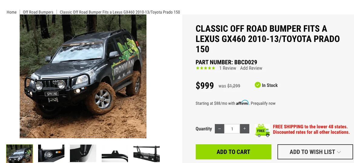

Always an option to look at business who will import an ARB model as well.
A 460 pic with the Ironman on it
Warn Warehouses for all of the Americas in Miami and a few months back they only had one Prado 150 bumper and it was gone before I could pull the trigger on it, hence why I ended up with the Ironman. I am more than happy with the Ironman bumper and at two-thirds the cost who can complain. They might have more in now but I would call and check.
For the 2010-13 GX I really like the minimalist approach of the C4 bumper.
Josh Walker on GXOR who they prototyped the C4 off of has put his 460 and C4 up to challenging use and seems to be holding up fine.
View attachment 2377078View attachment 2377081View attachment 2377082View attachment 2377083View attachment 2377084
That’s what I’d like to get. Something that adds protection, but isn’t real bulky. Hopefully something similar comes out for the 14+ models soon. If not I’ll probably end up with an Ironman unless something I like comes out between now and then.

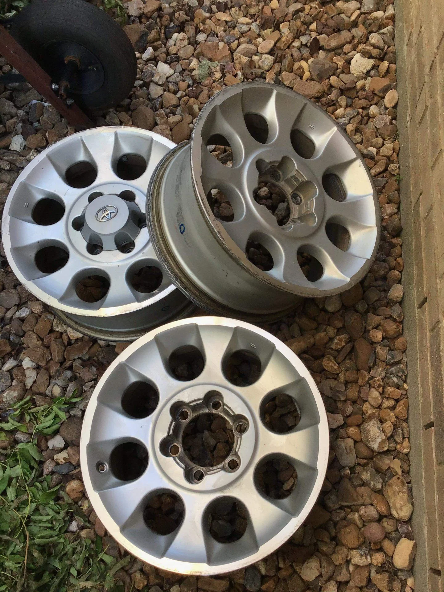

Found a set of 4Runner trail wheels with lugs for $100 that I’ll be picking up tomorrow evening. Just wanted a temporary set to have better tire options for the time being. At that price it’s hard to pass them up.
