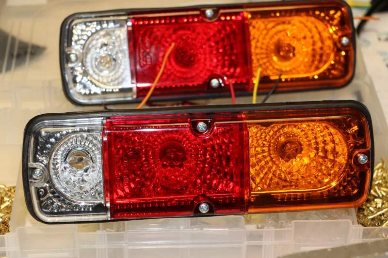

Was browsing E-Bay looking for a set of rear tail lights for a later model Cruiser, when I ran across a light that caught my eye. It was sold by a girl out of Venezuela and it looked, somehow, different. The price was $19.00 + $14.99 to ship. She only had an 82% rating, but I took a chance and ordered the set. They came in last week. They are not Toyota lights, nor are they for the US market. Here is what I got:

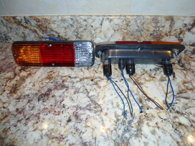

They are ALL plastic so cannot rust. They also have what I believe to be a "Rear Fog Lamp " bulb that has it's own set of wires. Can anyone verify that this extra bulb is indeed for a rear Fog Lamp function?
I used to own a Volvo that had this function. If you tuned on the Fog Lights then all rear and front facing lights would also tun on another bulb, or another element on an existing bulb. This would make all those lights much brighter; ie easier to see in the fog. I bought these for my truck and have already re-wired them so that when I turn on my Fog Light Switch, that extra bulb will come on. Had to of course add an extra wire to the rear chassis harness and to the switch circuit to make this work.
Thoughts?
I assume it would make the tail light function brighter making them easier to for car coming up behind you. Have you pulled the lamp out and checked for wattage? Would want to be sure to have the metal shields in place or rocks from the tires would take one out pretty easy. I would also bet if you leave it out in the sun those lenses would fade pretty quick. That nice clear looking lens would be foggy and brittle pretty quick. Do you have a cruiser to do a test side by side with one original and one of these aftermarket lights? That looks like a much more modern reflector. Would be curious if just the regular tail light wasn't brighter.

Looking at the tail light unit you purchased, it sure looks as though those extra lights could be for a rear fog light set up.
For the price I wouldn't mind having a set. Have junk set of tail lights I could use the plug off of and bullet connectors for the fog lamp.
That little bulb (3W) next to the Brake/Running bulb (32/4W) is a "parking light". It's way too small for a fog light.
Fog lights are a European thing and is only on the left side of the vehicle and is equal to the brake light wattage, so 32W.
In other words, when driving in the fog you'll see the two running lights and one very bright fog light on the left of the vehicle. When the car in front of you hit the brakes you'll see 2 bright lights on the left and one on the right.

Rudi, the wattage on the small bulb is only 5 watts, so that would be more in line with a "park" lamp. Why does the Euro spec need yet another "park" feature? You already have that feature in the brake/park lamp. Or does the Euro spec call the rear lights that comes on when you turn on the headlights, "running lights or tail lights"? Maybe the second bulb is not as bright so that people KNOW you are truly parked and not moving? Regardless, mine will be turned on with the fog lights. :D

One other thing: The design of the reflectors casts a strange pattern behind the vehicle. I'll try to get pics of that also.

They aren't the same. Yours had clear lenses with modern style reflector housing. These just look like the standard style with the fog light and plastic housings.
