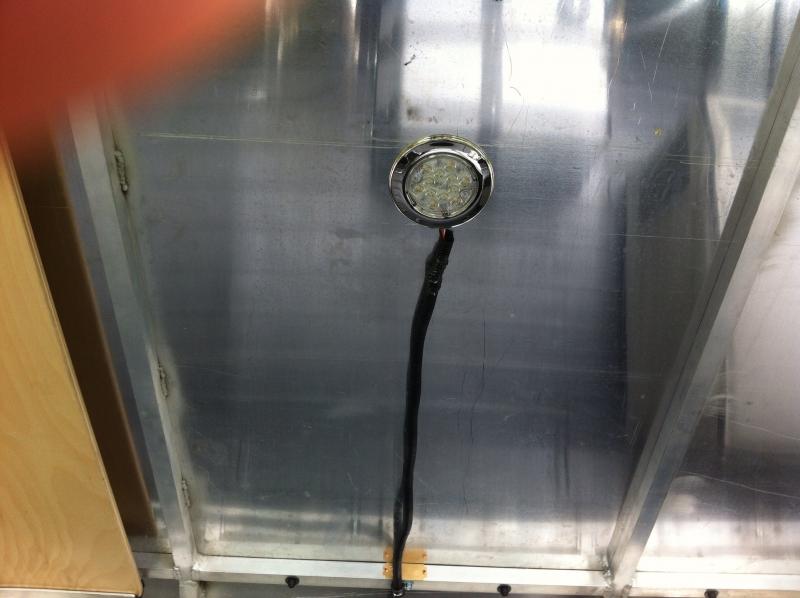

I really like the 4" AT flush mount LED light. A plus is that it's both white and red so your night vision isn't affected.
Might I recommend LED strip lighting? Comes in lenths (if you hunt around on ebay, you can find a 15 meter roll for under $50). You can cut them to length and they have 3m tape on the back. I mounted some on the bars in my RTT and then wired them to a small plastic junction box that is in the tent. Inside I have the 3 strips wired to two rocker switches so that I can have night lights and bright lights. I ran the wire out the floor of the tent and put a waterproof plug on it. I just plug it into my battery and it is totally removable if I take the tent off the trailer. These strips are about 1/4 inch thick and flexible enought o follow the contours of whatever you mount them on. On the bars in my trailer, I also added some zip ties to make sure they sat in place. They have not moved in 2 years. I will try and dig up some pictures and post them.
I couldn't find the shots from how I mounted them in the tent, but I did find shot of the strips I mounted to the frame I built to support my RTT. It does a good job of illustrating what I mean. I actually ran the wiring inside the frame work and tucked a rocker switch right into the frame near the back (direct wired to the battery souce so I can flip those lights on to see inside the bed area any time).
