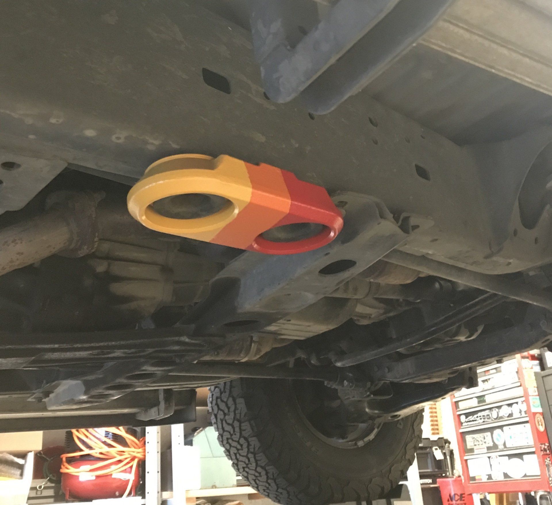

Long story short, chasing a drone on the gas around 55-70, vehicle is fairly new to me and noticed it doesn't have the passenger side vibration dampener. I have read a long thread about this same drone and it makes me want to try putting that vibration dampener on to see if that works. The vehicle has brand new oem front and rear driveshafts in that fixed a very bad vibration. (slip yokes were worn) I have no idea if this lx has ever had the dampener on it. Previous owner removed the running boards and maybe he took the dampener off. Does anyone have one laying around they would be willing to send me? I cant seem to find one anywhere. Thanks
Aftermarket muffler replacement? Check that the damper is on the exhaust pipe at the rear of the muffler.

I am pretty familiar to driveline vibrations and drones and can 99% say it is a rotational/vibration that is causing this drone. By "on the gas" I mean, while the load of the engine is light to moderate. Under normal to heavy acceleration, there is no drone. While coasting there is no drone. Only under light load, maintaining a speed 55-65ish on flat ground is there a pulsing-drone. I have baseline serviced the whole vehicle and it is running great for 210,xxx. I think it could be related to some worn rubber bushing and mounts (transmission mount, front diff mounts, rear upper and lower trailing arms) or even front cv axles. I was just hoping to find some cheep frame dampeners to try out cuz they might be the cheapest option to try 1st. And it seem like it might be such a weird pulsing/drone that took some extensive engineering/diagnostics by Toyota to figure out some frame dampening is all that is needed. I have had plenty of bad u-joints, muffler resonance, tire vibrations, freak weird ball joint/bushing vibrations on other trucks to know this is not quite one of those symptoms. Lots of good threads here about driveline vibrations to make me wanna give the strange frame dampener a try.

The exhaust frame resonance(“booming”) is a noticeable thing-in that sound/frequency travels through the frame at certain rpms- mostly noticeable to me at highway speed. You can notice it as a subtle hollow drone not a vibration while on the gas 65-75 mph. Making it worse, I have steel rear bumper, slee steel belly skid, aluminum intermediate and front skids that Im sure contributes even more , also a 24” magnaflow muffler and oem resonator still attached. I have installed some rubber exhaust line isolators which helps- but Id be interested to see if the frame weight would do since mine never came with it.
Just curious if this frame dampener is something that could be fabricated? Is it just steel?
It is steel. I was planning on pulling mine off this weekend and can weigh it for you. There are two rubber washers up top but I don't know what they do since they are loose.
