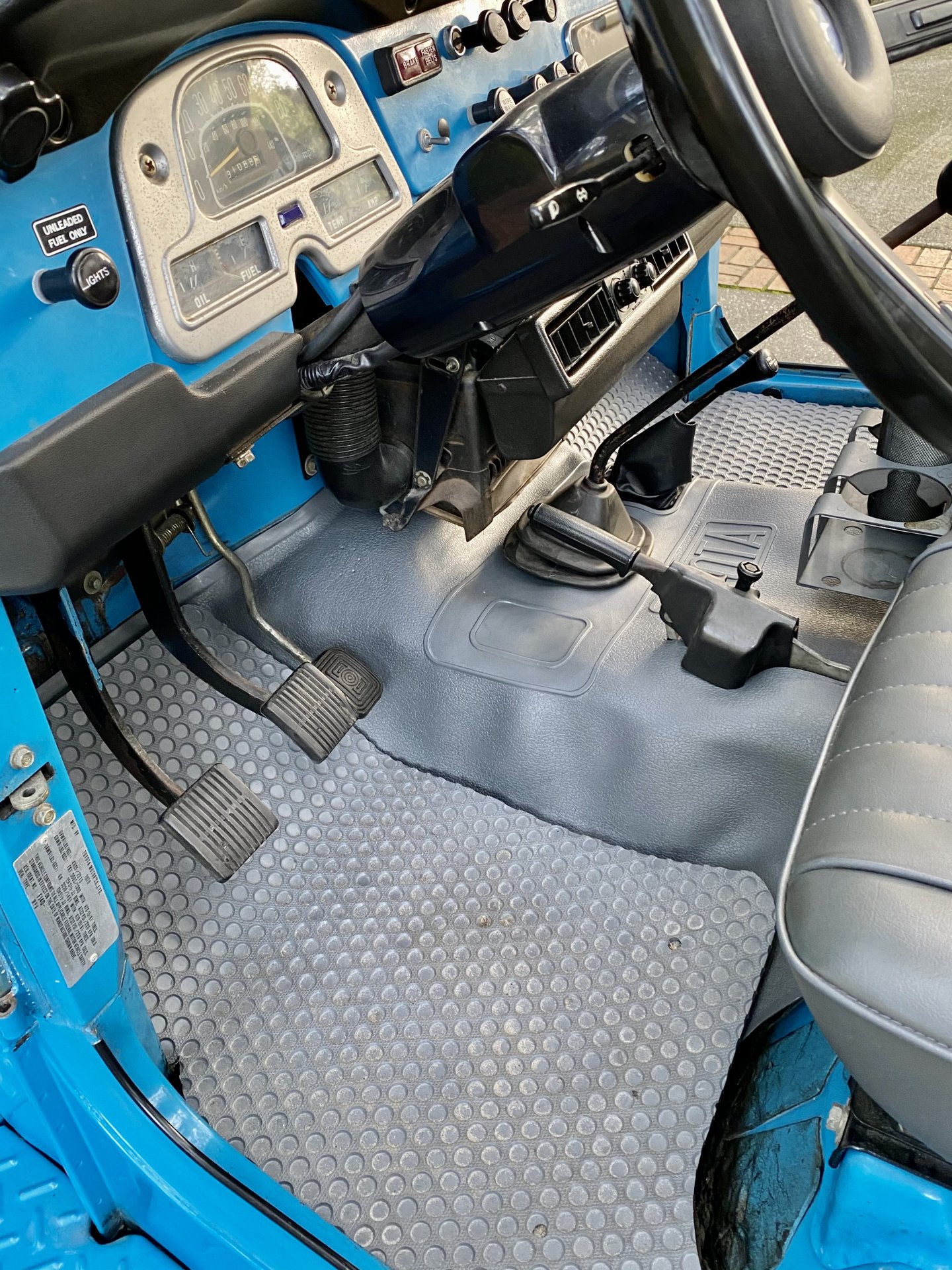

Actually my truck came from the 70's with a rubber mat topper cut to the shape made of doormat material. It's a bit weird but it brings a bit of insulation (I'd say more heat insulation than sound) if you can accept to lose the factory floor look.

stuff i have in mine is 1/2" thick rubber mat material cut to fit under the floor mat in the foot wells. over the tranny hump i used closed cell foam because it is easier to shape. cut and duct tape together as needed. covered up with the factory floor mat anyways. more rubber mat on the rear floor area. would benefit from something on the firewall I think. its still pretty loud at highway speed but not uncomfortably so. but do need to speak up somewhat to have a conversation.

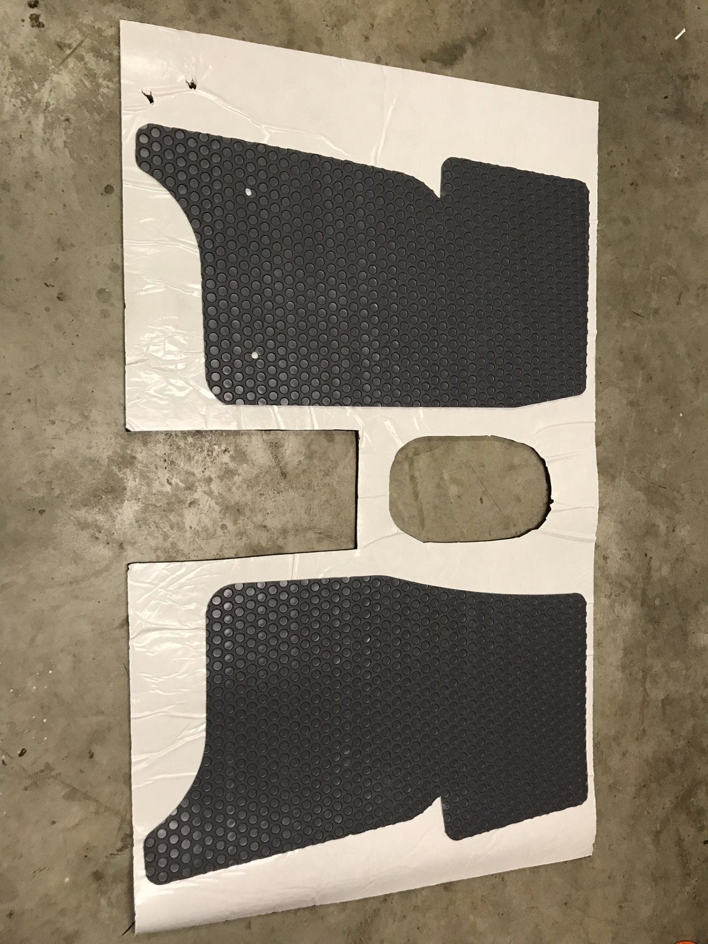

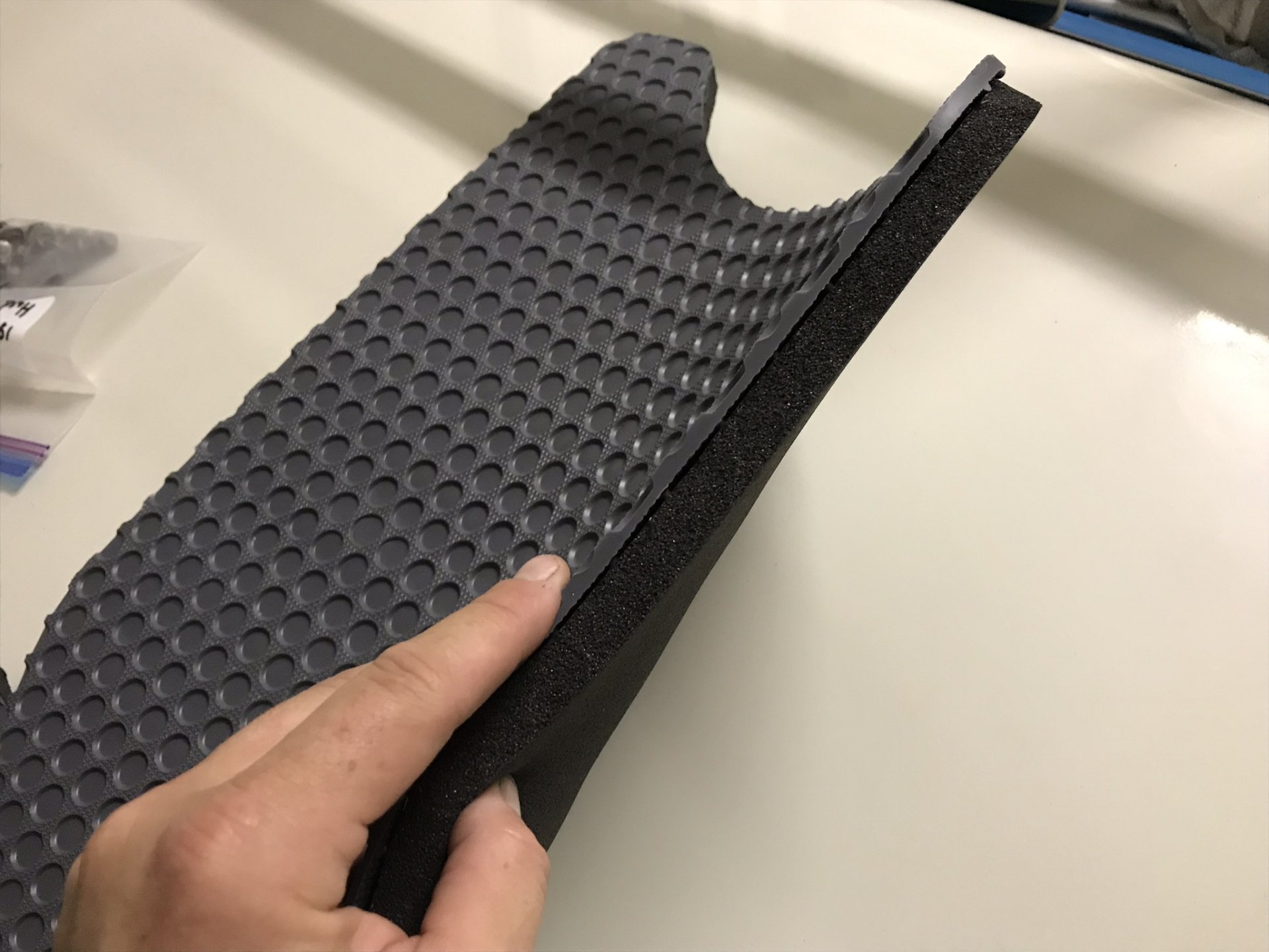

3/4” Dynapad comes with and adhesive back and I just stuck it to some rubber mats. I didn’t want anything permanently stuck to the floors to facilitate rust.
