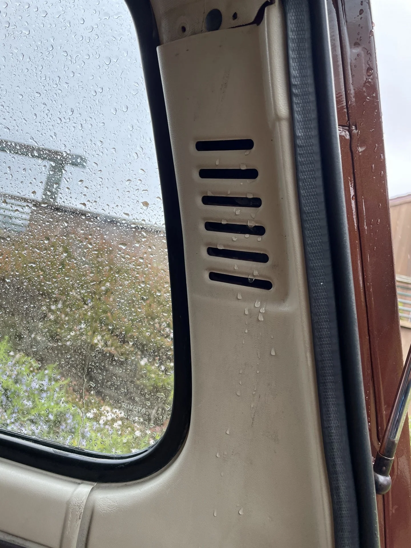

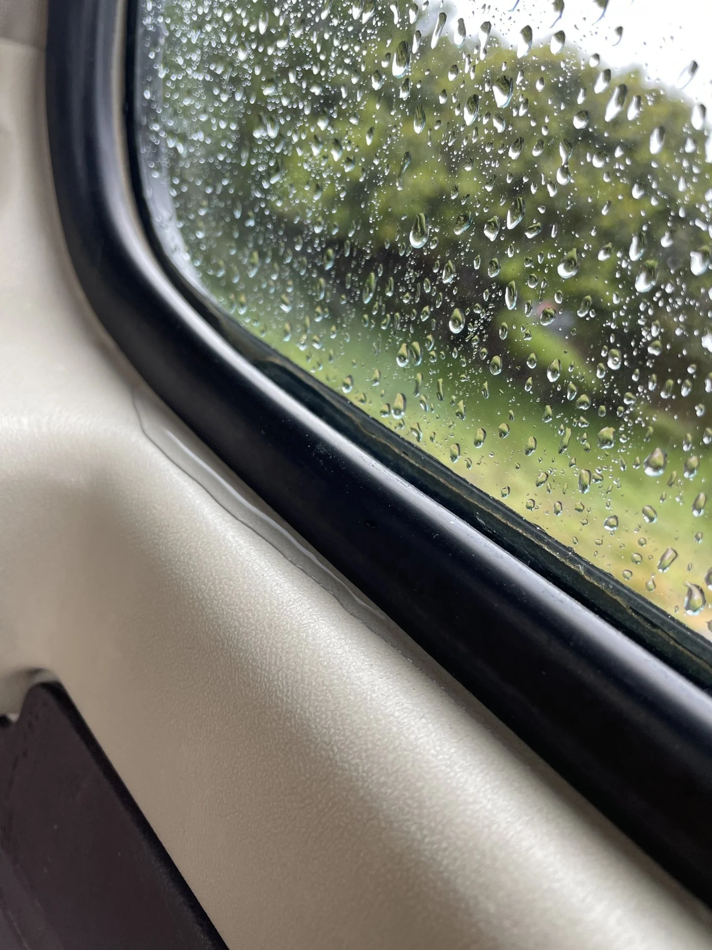

sometimes a picture is worth 1000 words. I’ve chased down and repaired major leaks and these two water intrusions seem to be the ones escaping me. Window seal ones seems obvious (just curious how folks have fixed it. Any idea on what could be going on with the vent? Trim on the outside of this window is missing so guess a PO had it replaced (poorly?) any help from 60 fam

There's normally a rubber flapper shield behind the D pillar plastic vent on the outside. Check to see if its there and can flap
How are your rain gutters? Are there any plugs on the roof over the cargo area?
Looks like it’s dislodged? What looks like a rubber piece is rattling around in there. Thanks for the heads up on the vent. Now gotta figure out the window.
