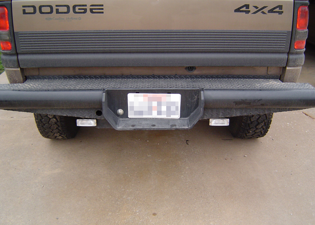

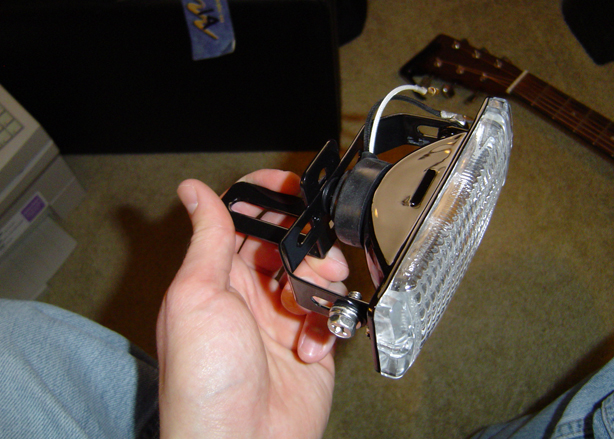

Though I don't have any installed on my LC yet, I like having a set of dedicated backup lights. Just wire them up to a relay with dedicated power and the trigger attached to the reverse light wire. Recommend mounting them down low as they generally cast more of a flood type beam with lots of spill and the obstacles you're trying to light up will be down on the ground. On my last truck, I mounted a good looking $20 set from AutoZone to the receiver hitch tube and they worked like a charm.
Installation page with more pics and info can be found HERE.
