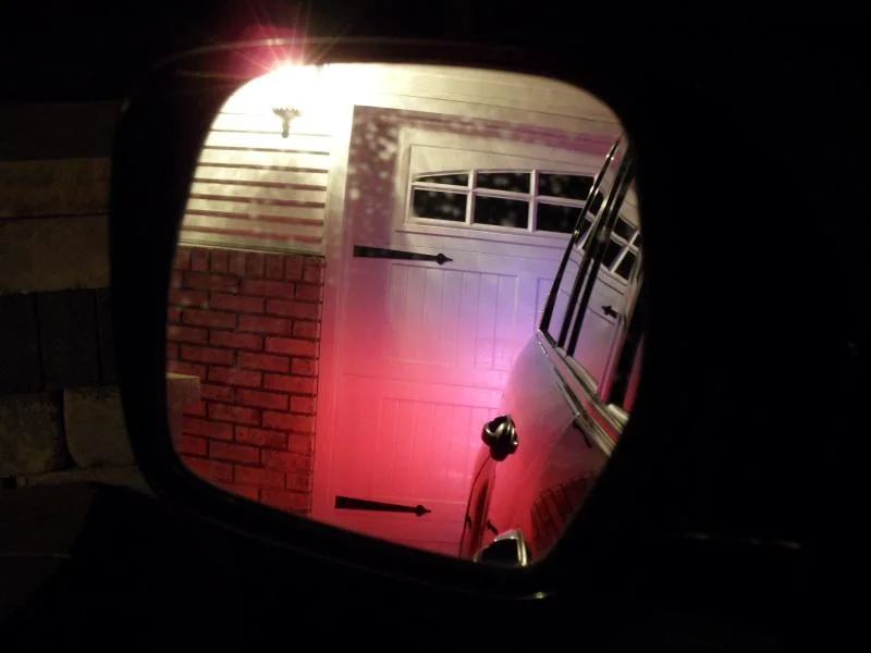

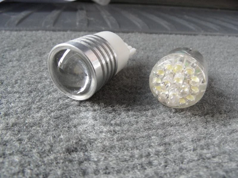

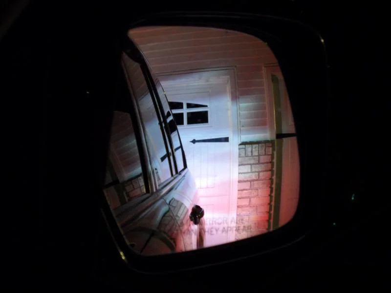

So I went ahead and bought these new high powered LEDs to replace my totally useless "high powered" LEDs and well, I'll let the pics do the talkin.
1st pic: New bulb on the left with projector type lens.
2nd pic: Driver side with old LED
3rd: Pass. side with new LED. Ridiculously bright in comparison.
I usually back into my driveway, and have to roll the windows down to see where I'm goin...not tonight though. Even with tinted windows these bulbs have solved my dimly lit reversing probs.
