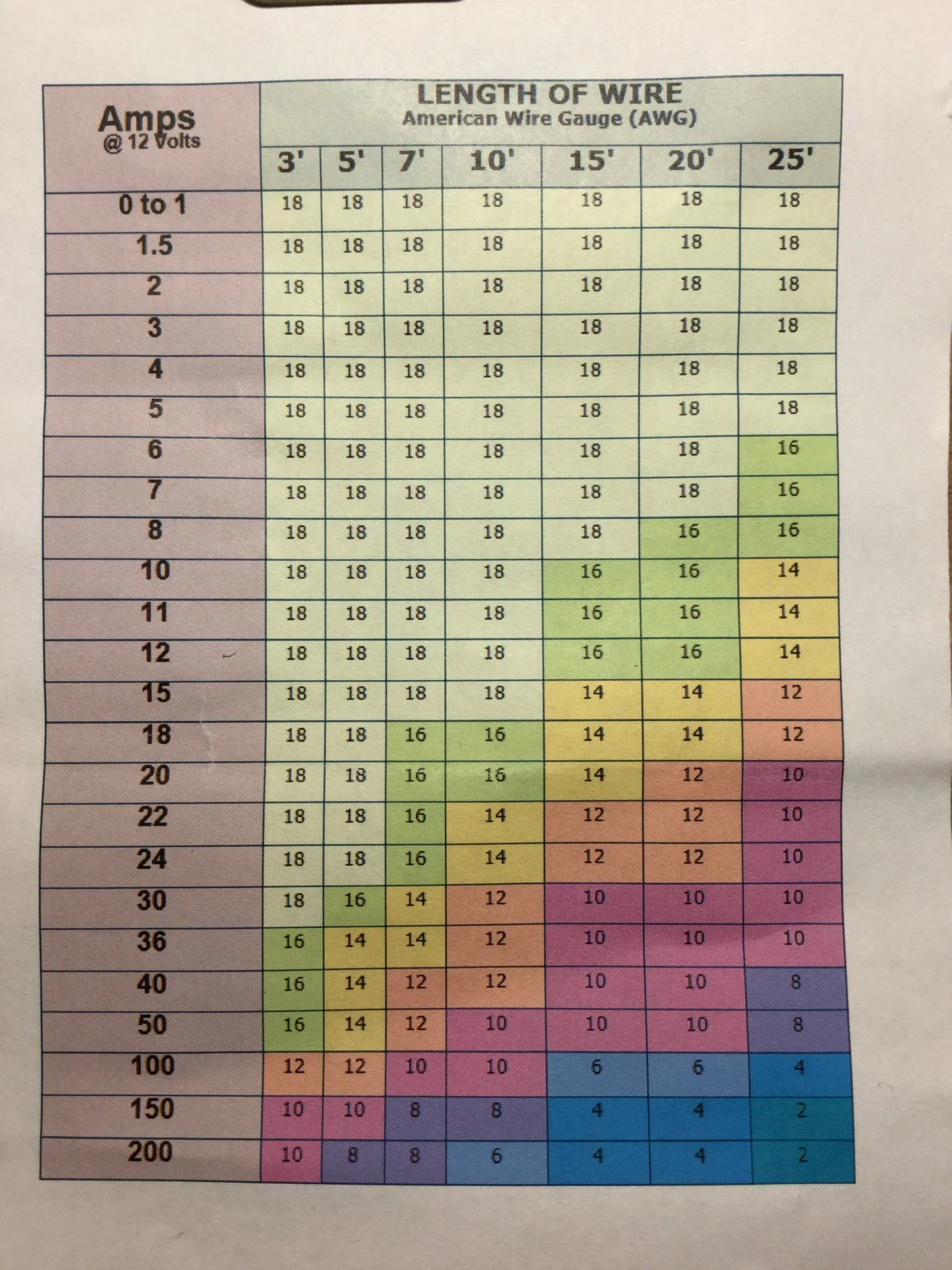

You won’t need 6 gauge wire for the solar panels. 220 W at a charge voltage of about 14 volts is less than 20 A. 12 or 14 gauge should be good depending on the length of the run.
Ill end up pulling 10 just in case I ever add another panel..
