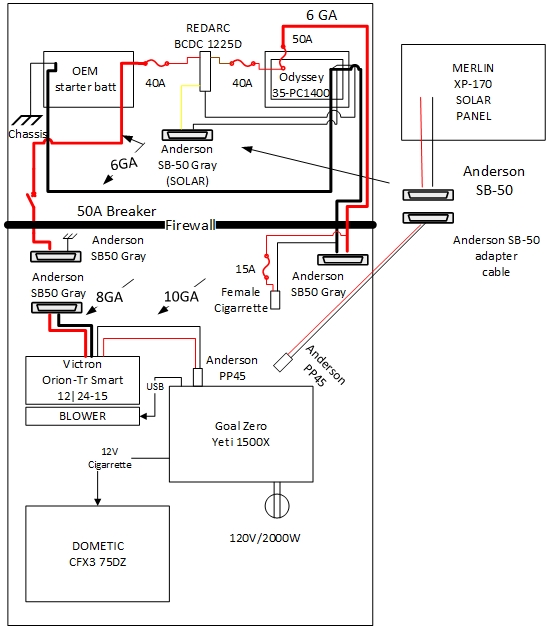

I did both a dual battery AND a solar generator. A solar generator can't jump start the engine but a second battery can. The 2nd battery can't supply 120VAC (without an inverter thrown in there somewhere*) but the solar generator can.

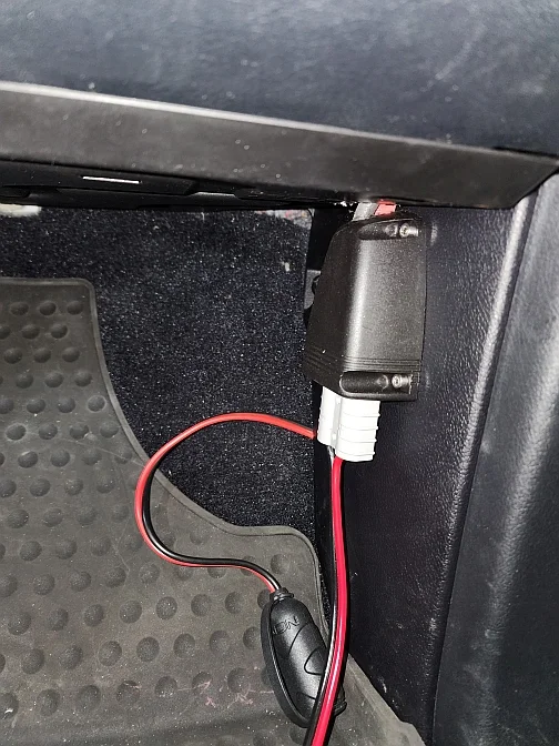

I just added the passenger side connectors prior to our last trip a month ago and it worked out very well. I was able to power all kinds of things like cell phones, lights and even the Dometic CFX75DZ when we disconnected it from the Yeti 1500X.
I posted about the new passenger side connectors earlier here: What have you done to your 200 Series this week? - https://forum.ih8mud.com/threads/what-have-you-done-to-your-200-series-this-week.818471/page-788#post-14828907
Below is my current concept. We don't always use everything all at once but the schematic hopefully illustrates the flexibility.
* I may get an inverter to attach to the 2nd battery and also a regulator like a Victron 12-12/30 so that any DC supplied by the 2nd battery is regulated. We'll see LOL!
Overall concept:
Latest addition to the passenger side. The connector is from Powerwerx and the female cig is a NOCO.

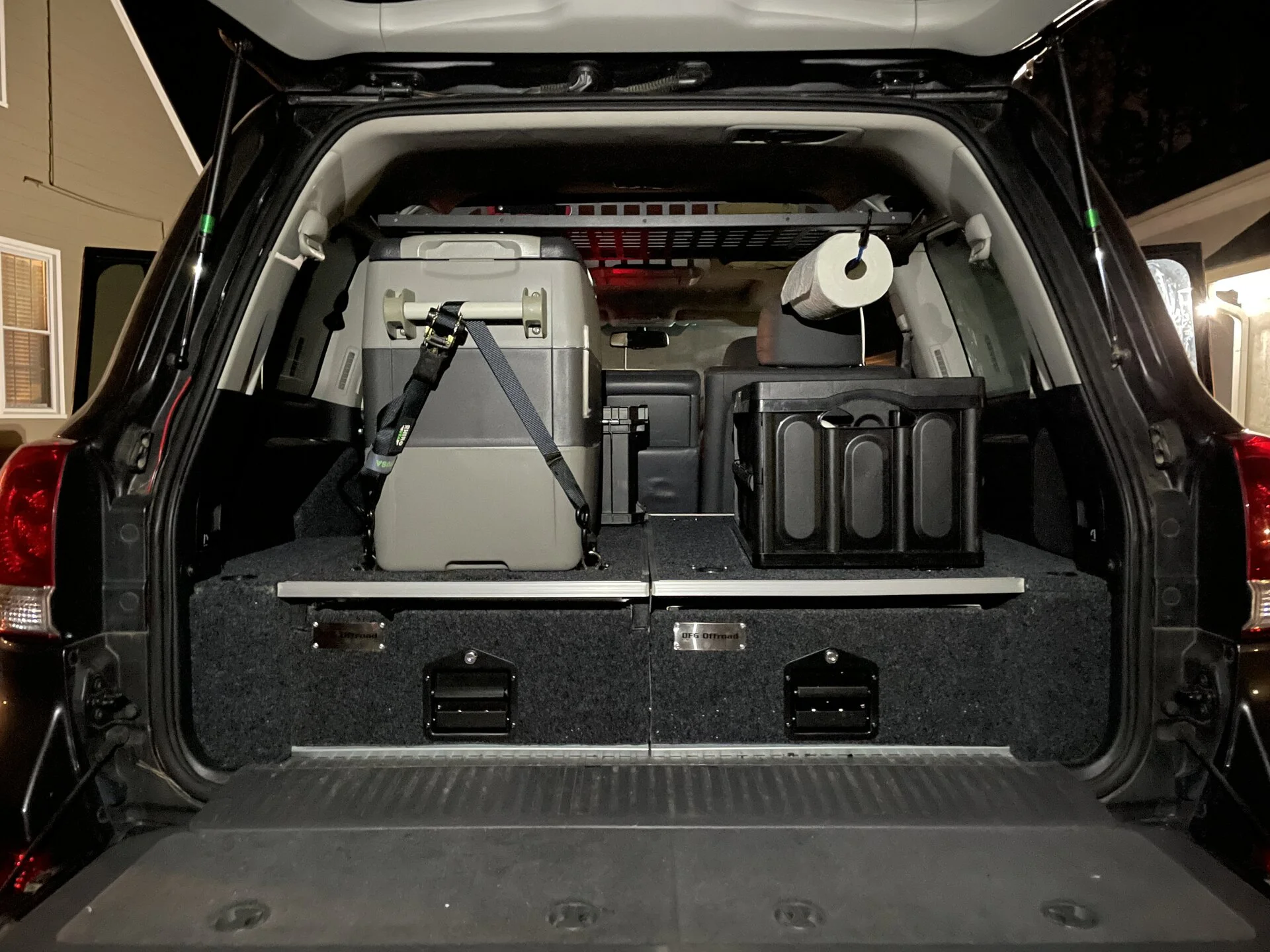

I've got a hybrid setup in mine. It's a dual battery setup, but in a portable tool box that lives in the trunk behind the fridge and has a solar charge controller attached.
I wanted a solar generator, but also the ability to charge via alternator. You can't do that with prebuilt solar generators.
So i built a lithium battery box, mounted a 20 amp DCDC charger next to it and threw a solar panel up on the roof.
I need mine to be portable because it powers my diesel heater in the winter and some other things. If you don't need portability, definitely go the dual battery route.
