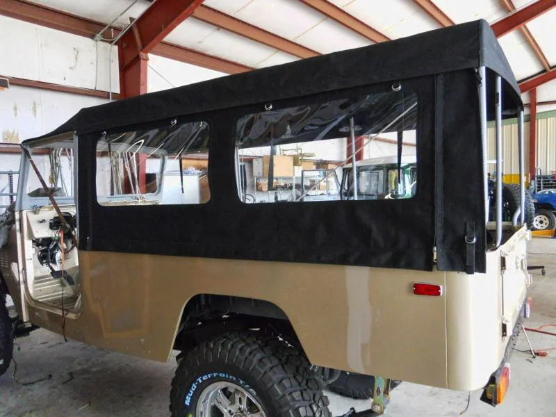

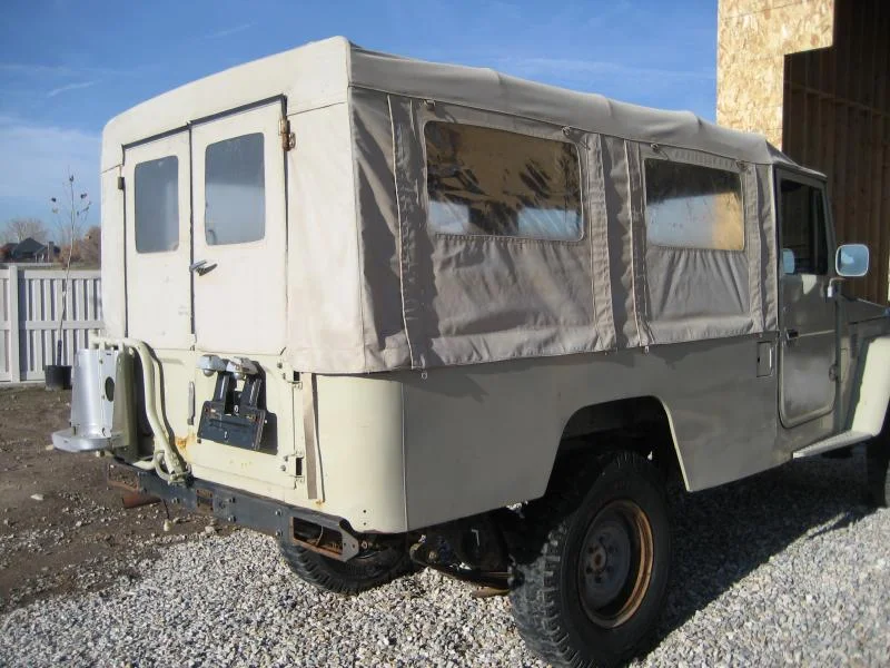

Some images below as inspiration. Thanks in advance for any help y'all can offer.

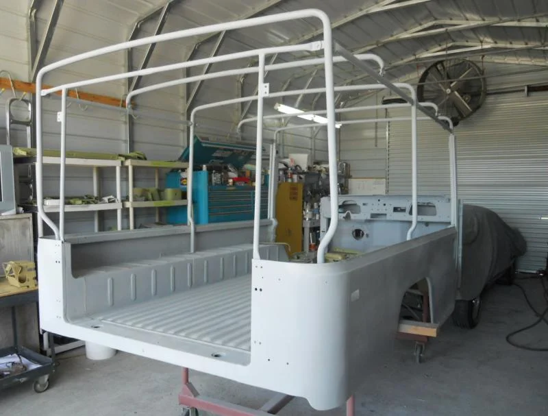

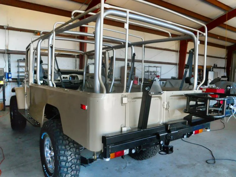

Hood Bows.
Here is the set i made out of 3/4 gal water pipe. They took abour 8 hours to do,. The fildiest bits were making the little plates and drilling the holes.
i had an genuine set that i photgraphed and mesured, but when i put the canvas top on and it fitted like a glove even i was impressed.
They arn't to hard to make if you are fairly handy with a pipe bender.
I think the Aussie army bows are different to standard.
