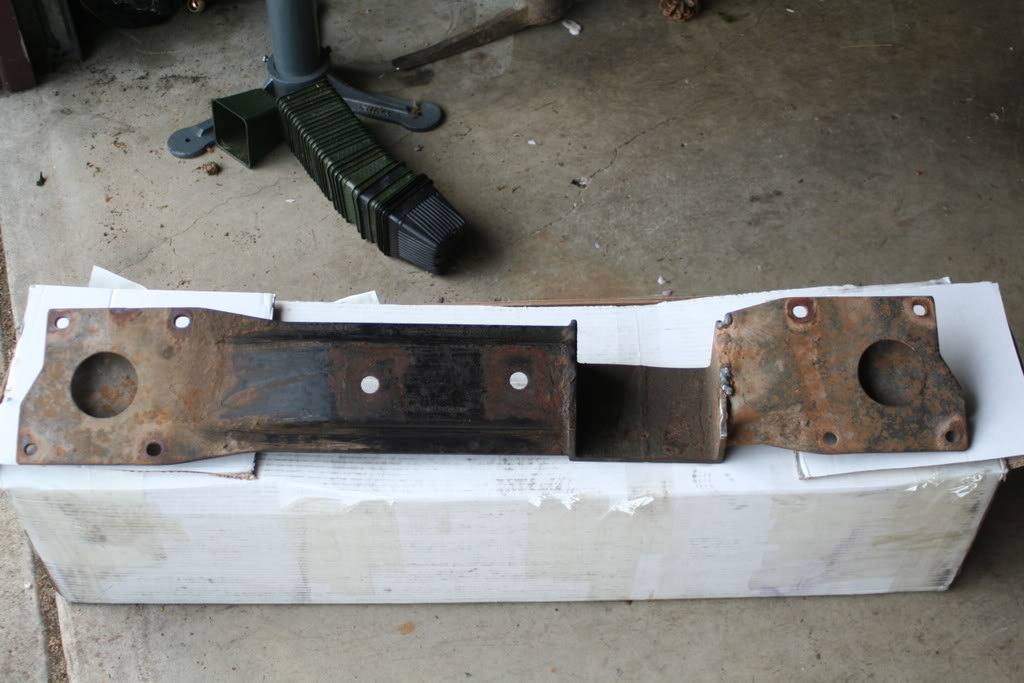

exciting!!!!! I have new pics. Looking good. Jason said he is having an issue with the drive shaft angle. He said he thinks by cutting the cross member he can make it work. I think I saw this in another post before, but I can't remember which one. If you know let me know please. Thanks Let me know what you think.

that looks awesome. cut and channel the cross member for the driveline clearance. I even had to do it on my SR SU kit. I will post up a pic of the crossmember monday if you need it.

Thanks! I'd love to see that pic, just post it up when you can. Much appreciated. -Nick

here is a crossmember I picked up from lehiguy. a bit more radical than my current one but I couldn't find a decent pic of mine. Anyhow it should give you a good idea on how to cut the crossmember for the front driveline clearnace.

Ahaaaaa....thanks. I'll pass this pic along to get some ideas. Thanks
