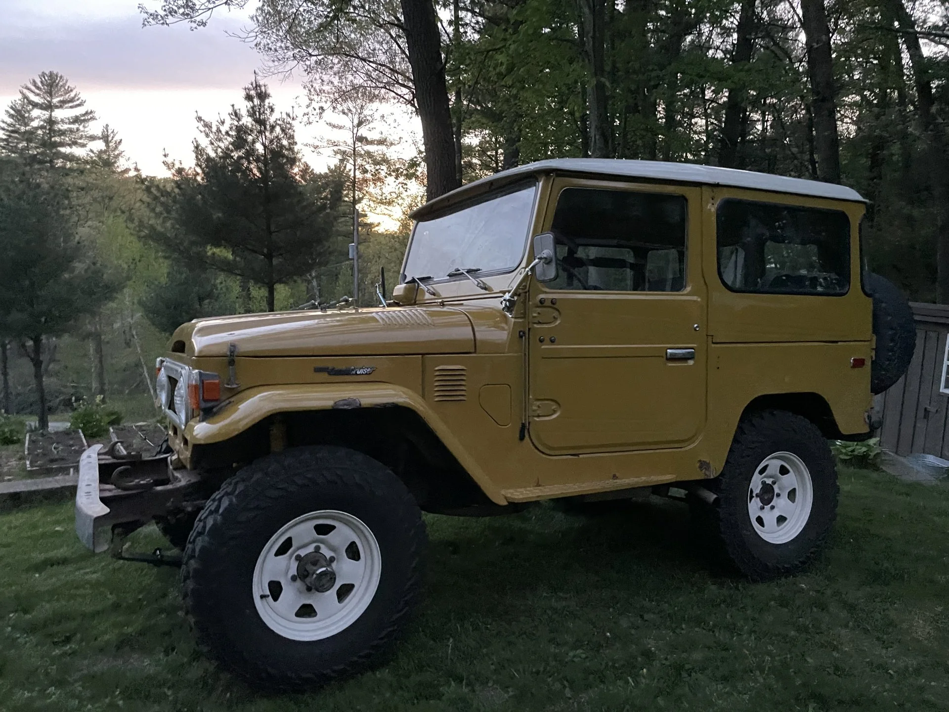

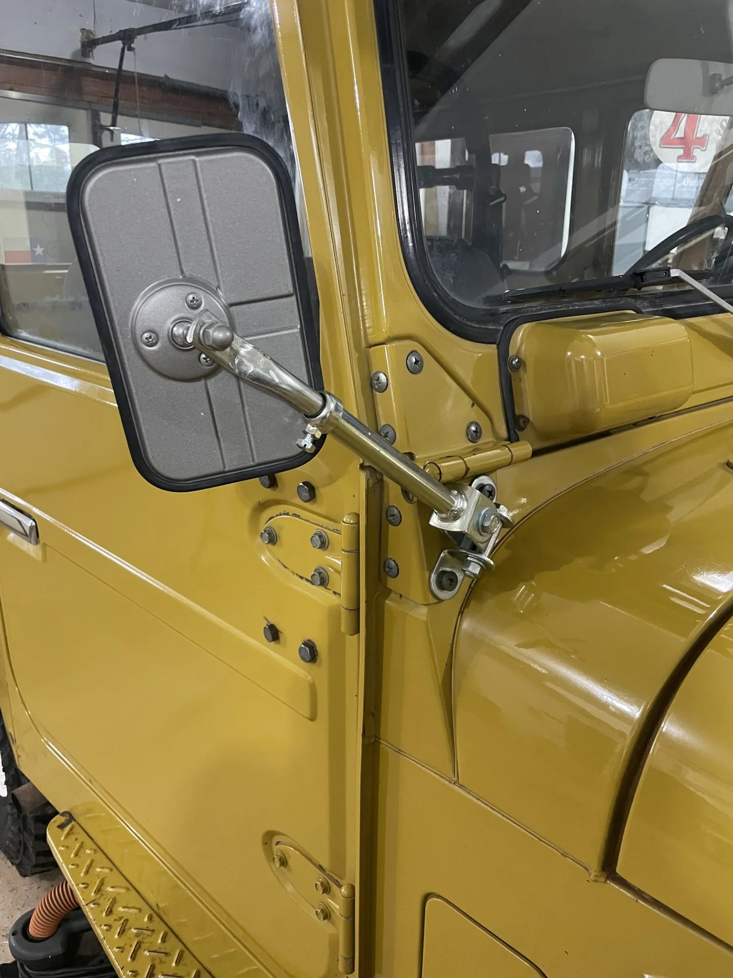

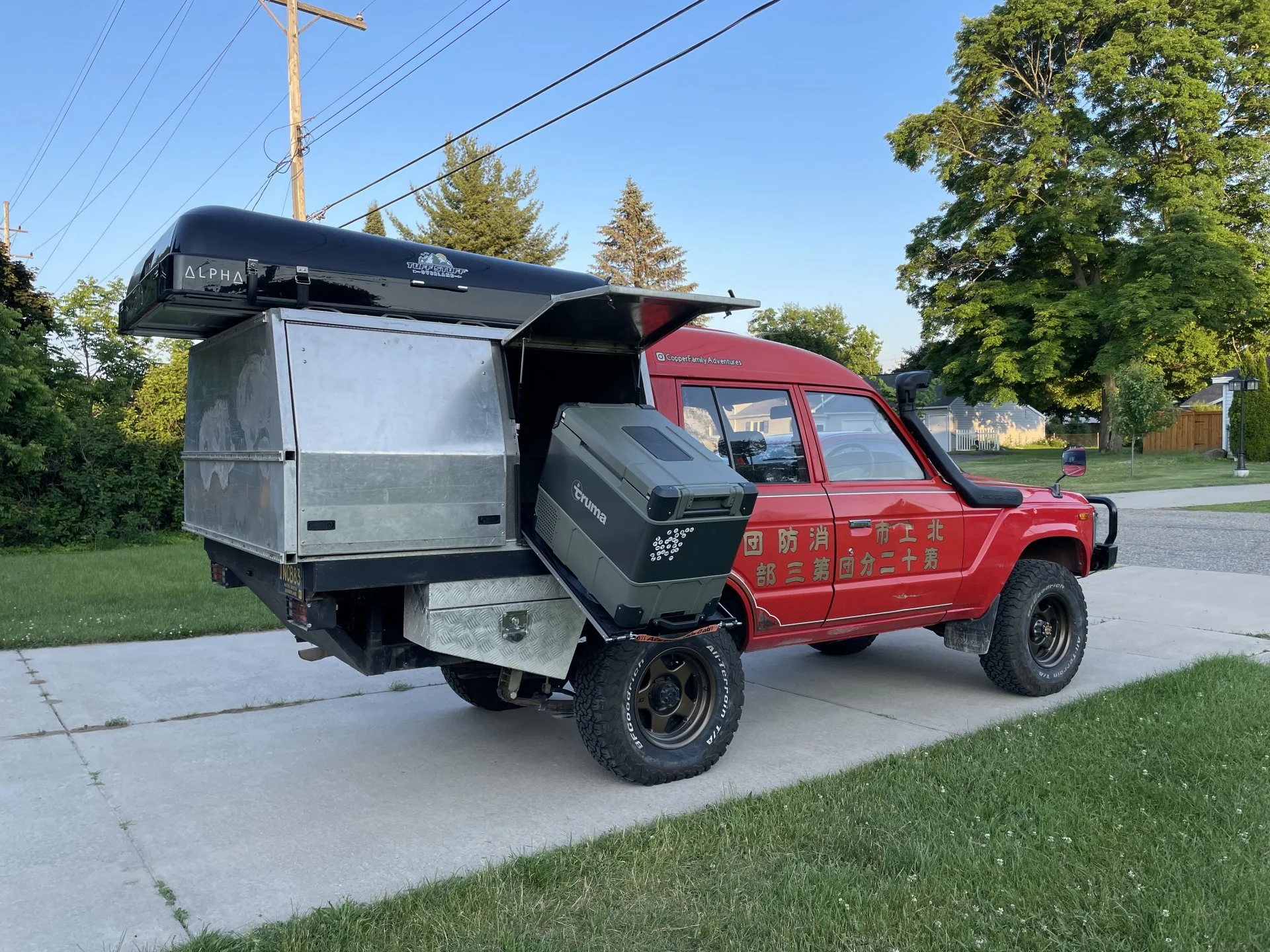

Looks like she’s cleaned up for a sale ad…you know, just throwing that out there. I know someone looking for a 40…Zippy the 40 has been getting little trim items here and there to get ready for @Ocho77 ’s party.
View attachment 3027211View attachment 3027216View attachment 3027218
ADD in full swing.

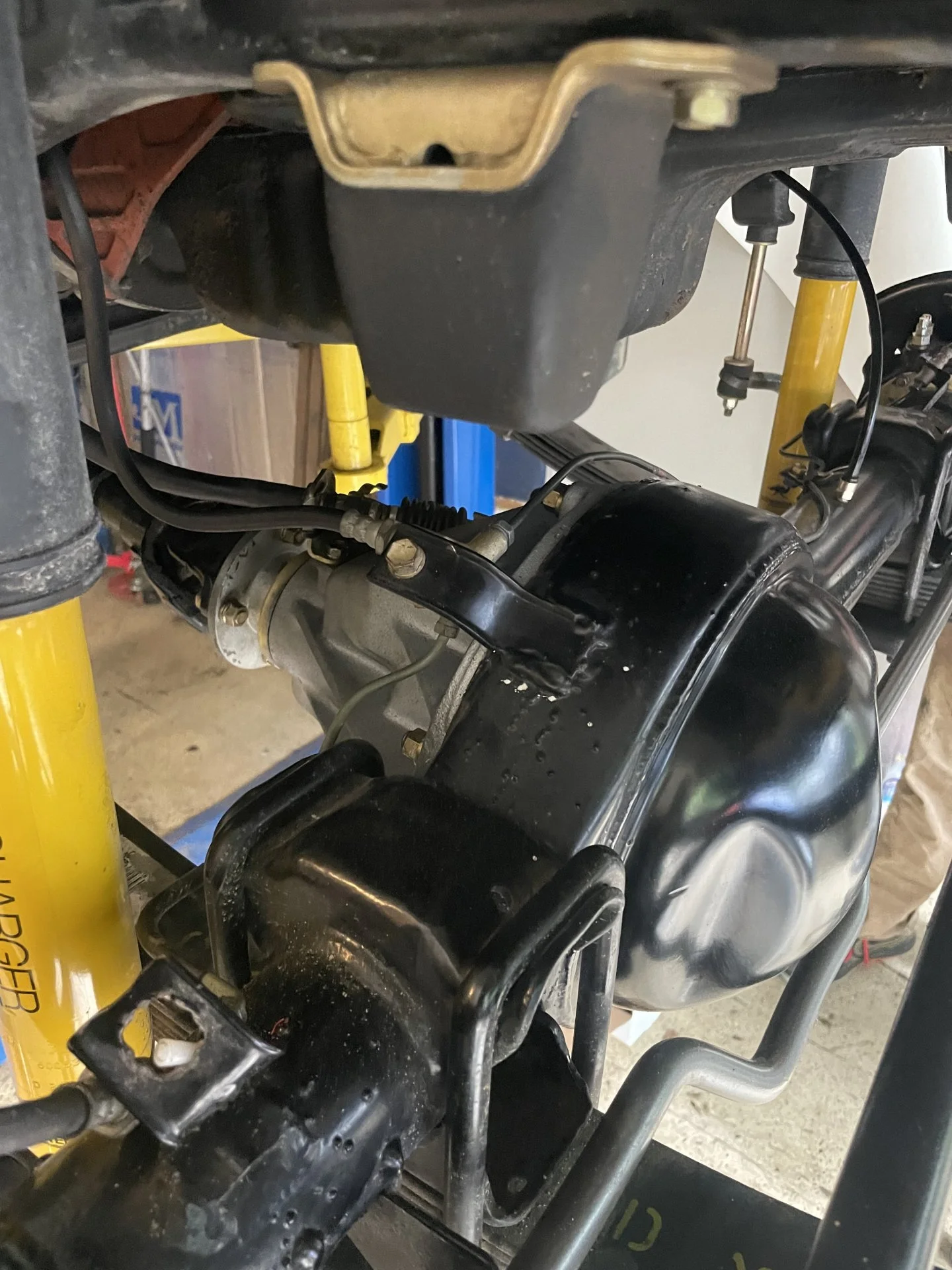

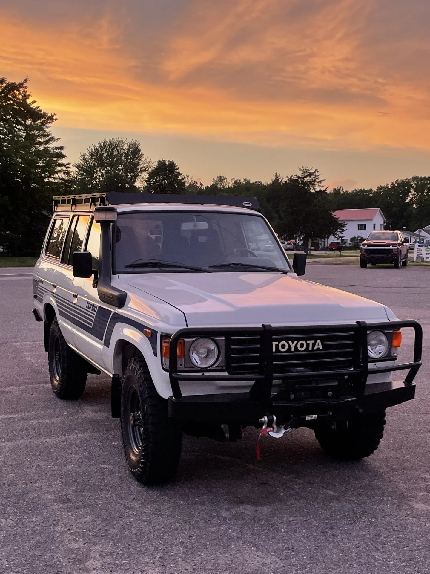

Got Chunk back on the road with new 4.10 gears
View attachment 3027200View attachment 3027205View attachment 3027207

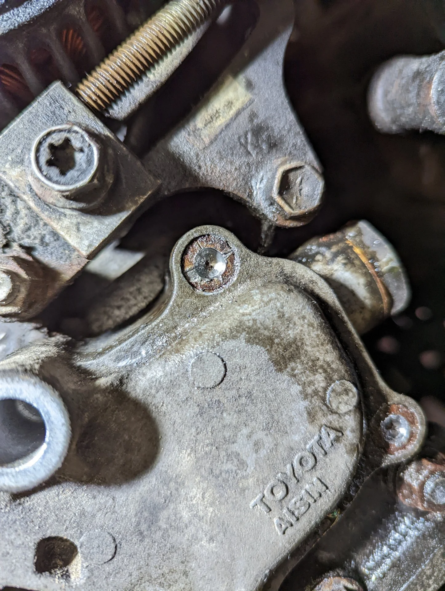

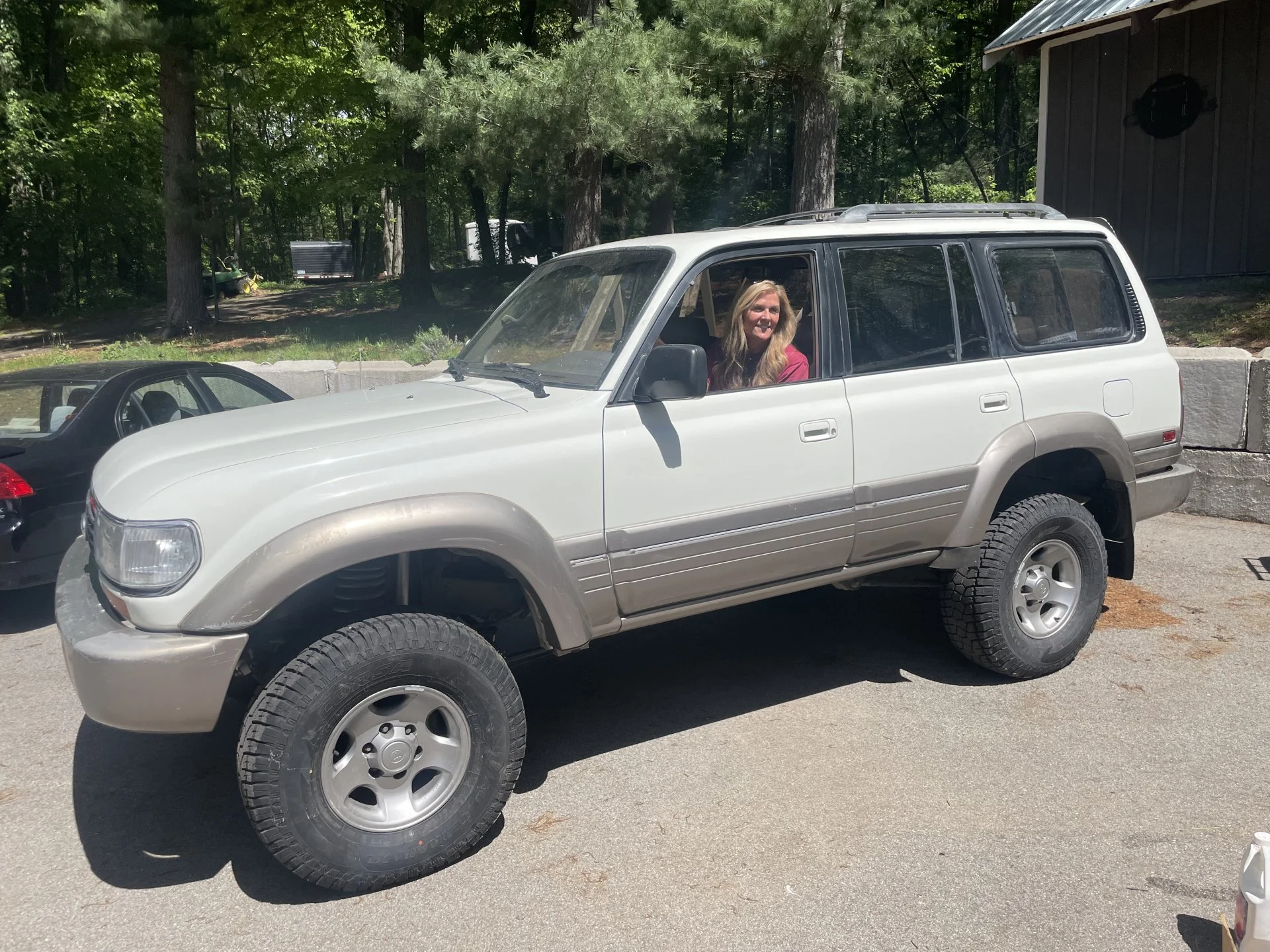

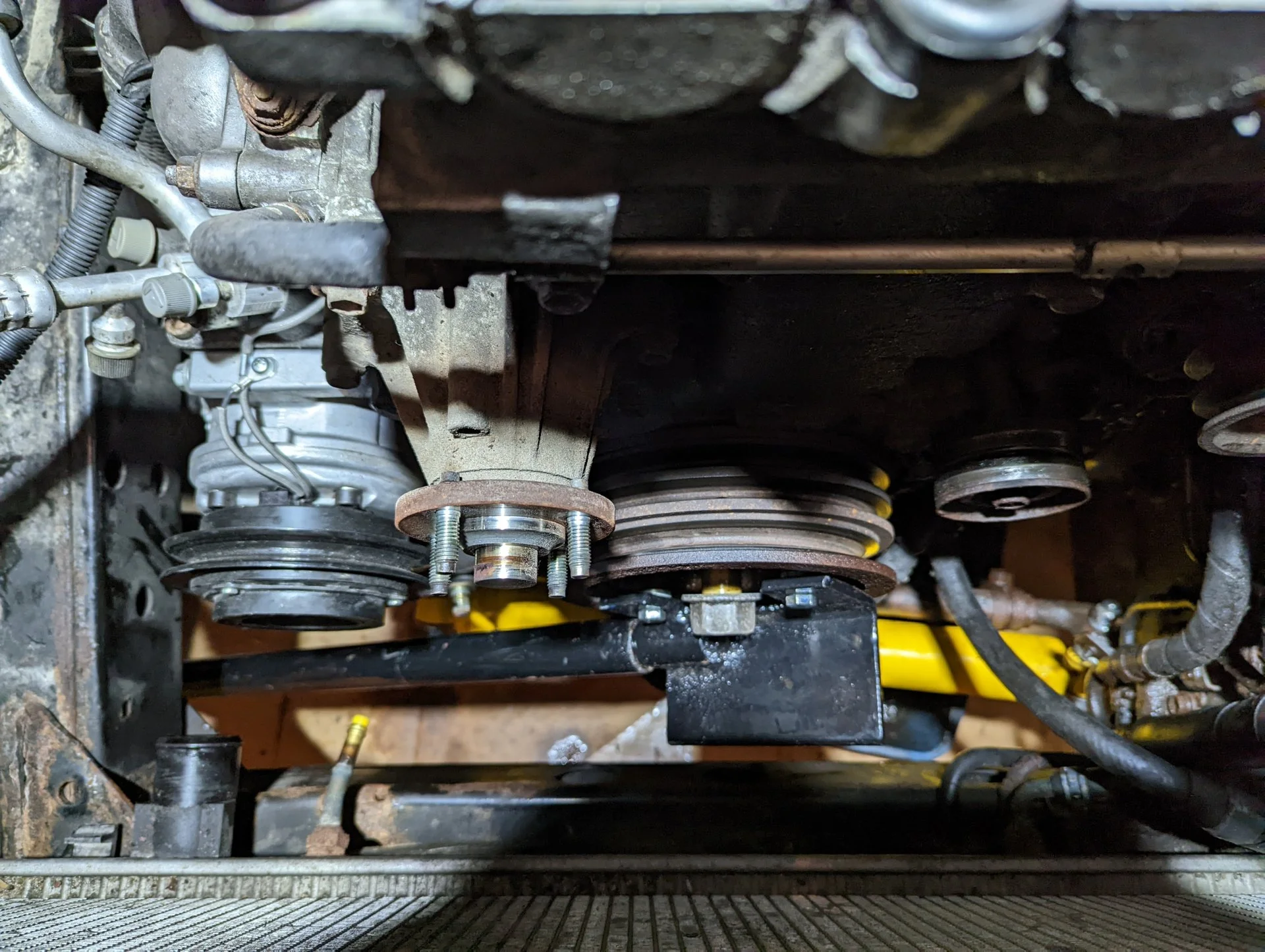

Awesome!! That oil pump cover and dizzy o-ring solved all of my leaks. Not to bad of a project. Looking good!!!Finally got around to the front seals and cooling system refresh on the 80. Thanks @dogfishlake for letting me borrow essential tools to get the crank pulley bolt off (and back on)! Removing that monster was a battle, the starter bump method failed so I went at it with a 3/4" breaker bar and 3' cheater - given how hard I was pulling and leverage, I'm guessing easily 600-800 ft-lbs to crack it.
Thought that was the end of my grief but those oil pump cover screws everyone talks about... yeah, they suck. 5 out of 7 zipped out with an impact no problem, the other 2 not so much. Bottom line on those for anyone who takes on this project, at least what worked for me: a few short heating/cooling cycles. In hindsight I should have torched all of them before the first attempt.
New seals are in, crank pulley back on, now the home stretch replacing pretty much everything in the cooling system - hoses, clamps, rad, tstat, water pump, idler pulleys. Hope to have it back on the road this weekend.

That is a good project almost done! A full cooling system refresh is intensive with oem stuff but pretty essential for a 1FZ-FE. Overheating is about the only thing that can kill it. No oil leaks is awesome too!Finally got around to the front seals and cooling system refresh on the 80. Thanks @dogfishlake for letting me borrow essential tools to get the crank pulley bolt off (and back on)! Removing that monster was a battle, the starter bump method failed so I went at it with a 3/4" breaker bar and 3' cheater - given how hard I was pulling and leverage, I'm guessing easily 600-800 ft-lbs to crack it.
