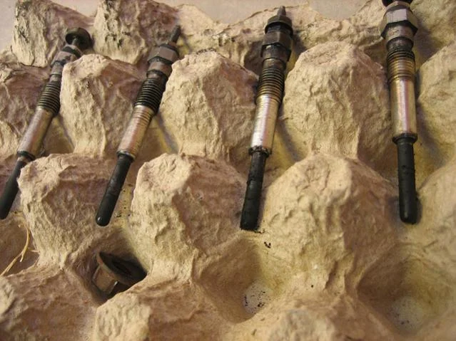

Here's what the plugs look like...
Is it just me or is that actually carbony sand?
P.S. the cleaner looking two on the left were wiped with a paper towel.
I'm thinking now maybe it's all a combination of lowered compression due to scoring and the plugs not glowing? they tested fine but did not warm up even after two full glow cycles.
Well you've got the plugs out now, check continuity between the tips where the nuts are and the threads where it goes into the head.
I don't like the looks of the tips of the glow plugs.
When I pull my plugs they're generally very black, but the coating is very very fine, while yours does look suspiciously granular or chunky. Could be not-so-good but I can't tell anything for certain from that photo.
Do you get any signs of life when you try to start it? All it takes is one good glow plug to get a cylinder firing up, which is often enough to start the others. If you get nothing at all (no stumbling etc) then something is affecting all your cylinders at once.
Glow plugs could fail en masse, but its unlikely. Could be a glow relay thats just not giving any of them power. But as I said, if its warmish out you should be able to fire that engine up without em.
Scoring isn't the only way crud can wreck your compression. Maybe you gummed the s*** out of your rings and they're stuck...?
