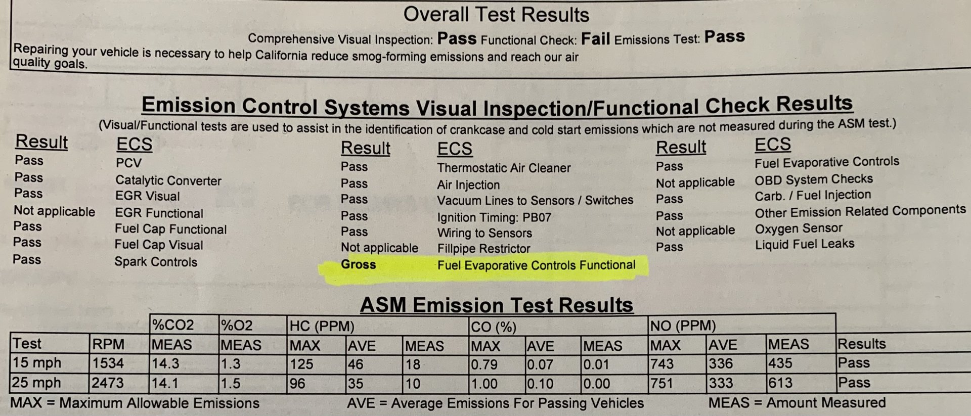

So I went back and re-tested today. I’m not going to lie, I took the easy route and put e85 in the tank then drove ~30 mins on the freeway prior to testing. The change in my emission results were pretty astounding. However I still FAILED, this time because of the fuel evap test. The crazy thing is I passed this on the first go. Anyone had this happen to them before? Could it have been an error on the testers part?
I replaced the gas cap after my first test so it makes sense that I would pass there, but I didn’t touch anything else so it seems odd that the issue would just now pop up. How involved is replacing the evap hoses? Maybe I’ll start there if it’s a simple weekend job.
Two yrs ago on my first smog test I failed on EVAP and passed on everything else just like you (but no e85). Smog tech told me to fill up my tank and come back in two hrs. He said a full gas tank has less space for gases. I did that and passed. He thought maybe my charcoal cannister was bad. But this recent test I didn't have any issues but from the research I did most MUDers go in to test with the least amount of fuel in the tank. Not sure who's right here.
@ro11dice you might be on to something…my first test had 3/4 tank of gas, tonight I had less than 1/4. Wonder if that will make the difference. Damn I’m jumping through hoops to get this thing smogged…
This is not the fuel cap. You can see there is another test specifically for the cap. In this test the cap is removed and the tank and lines are pressurized looking for leaks. I had this happen and replaced the hoses associated with the vapor recovery system (evap). There is a vapor separator in the right rear quarter panel and the the hoses associates with the charcoal canister. Of course if your canister has a hole in it that could be the problem too.
Third time's the charm. I filled up this morning, re-tested and passed on all fronts. Seems low fuel level can contribute to, or exacerbate EVAP leaks.
