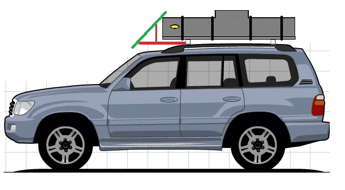

I'm going to fab up a front fairing to cover the roof top tent and the front cross bar of the roof rack I made out of unistrut. There is no howling up there, just regular wind noise from the blunt face of the RTT. Since I used unistrut to build the roof rack, it will be easy to attach two front unistrut "outriggers" upon which the fairing can be mounted to. It will end up looking something like this. I would only run the fairing on the highway on LONG trips out to Moab from central Missouri. For short trips, I wouldn't even bother. I'm mounting my LED light bar to the front unistrut crossbar so would need to remove the fairing once we arrived so the LED could be used.

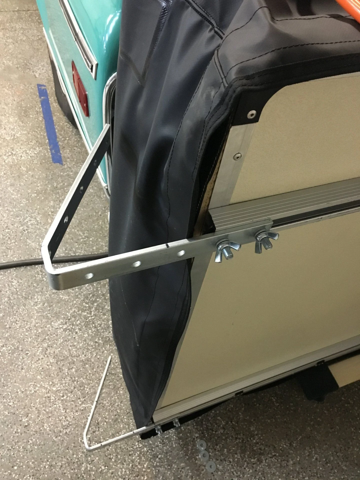

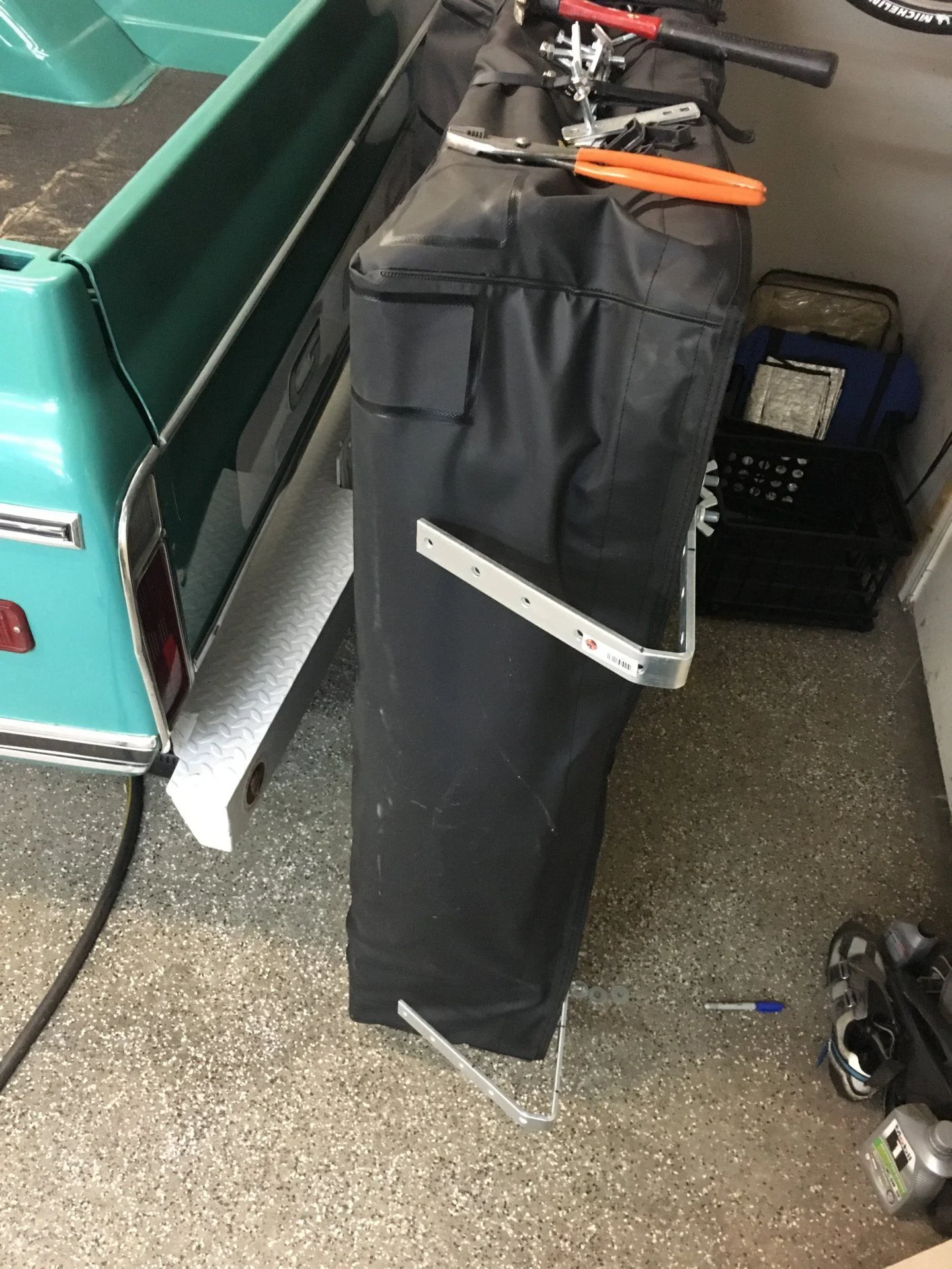

Decided to attach the brackets directly to the tent channel. Very sturdy. Ran some bolts in the channel with wing nuts for quick removal of the fairing when we open up the tent.

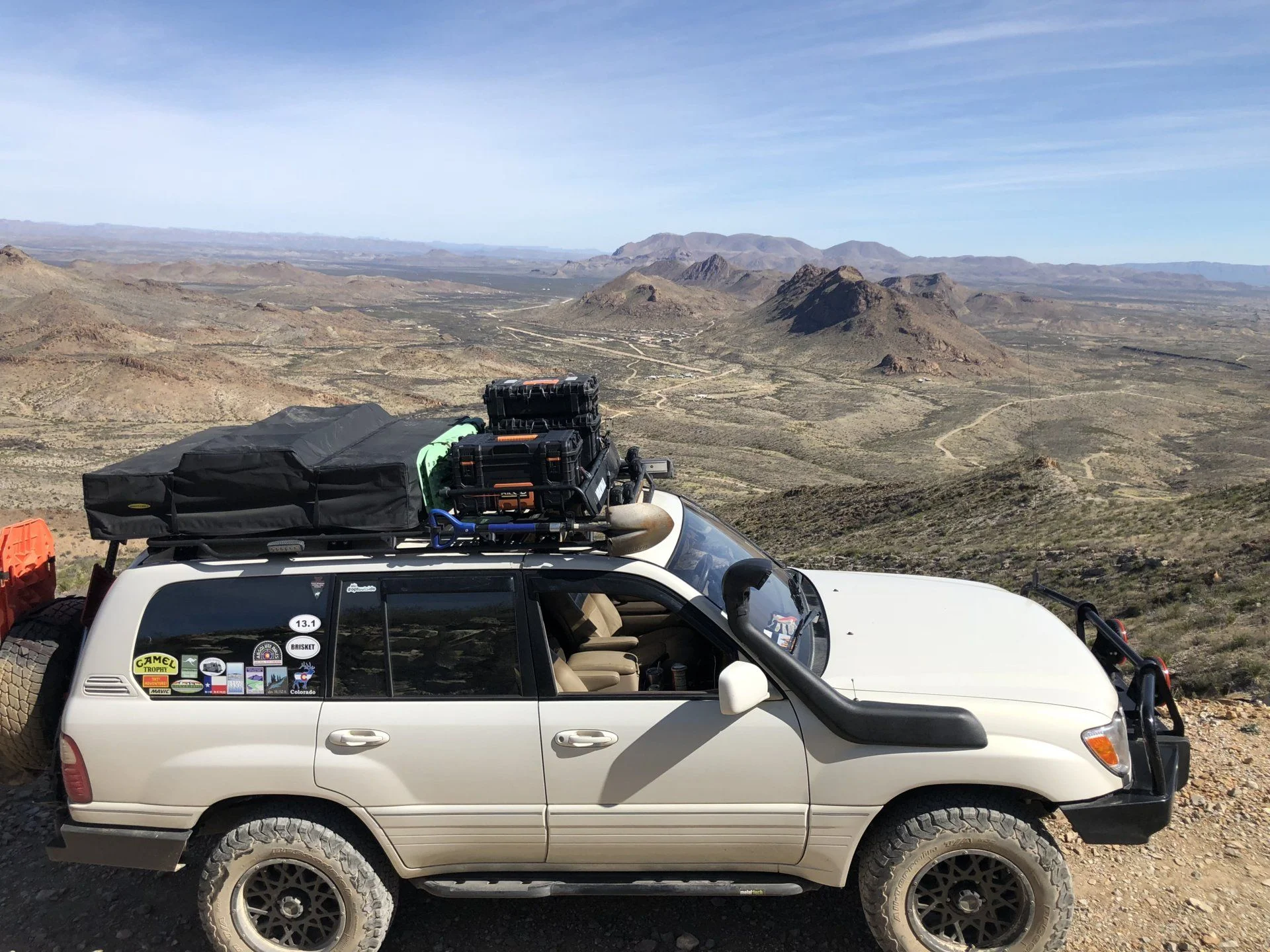

I split my Yakima MegaWarrior in 2 and use the front half on the roof rack in front of the tent. I can carry 2 Rigid 22" tool boxes (RIDGID 22 in. Pro Tool Box, Black-222570 - The Home Depot) and 20L/5Gal jerry cans in that spot (not in attached photo).

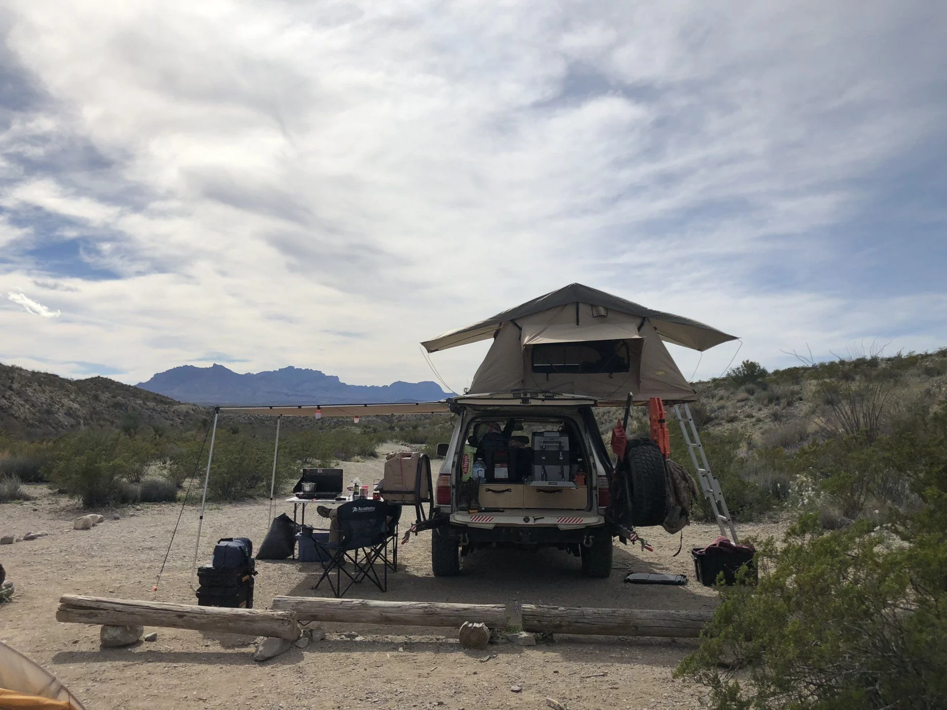

Gary, what's it like setting that tent up and down every day at HIH? I was considering getting one, but I think we'll be in a tent (or a trailer if we find the right deal before the trip) this year. Last year we didn't have much of a home base set up (just slept in the back of the 100) and it was a pita for that long. Not having to setup/teardown each day is appealing
The tent takes about 5 minutes to setup and 10 minutes to put up. I wouldn't do it at HIH as the daily setup/putup would be annoying over the course of 6 days. Additionally, I have the ARB 2500 awning and associated 8x8 room. That setup/putup time is about 10/10 minutes. I setup the tent each day (4 days) in Big Bend recently and it got a little annoying on the 3rd and 4th day. The comfort in the tent is ridiculous. I put in a full-sized air mattress in place of the 2" foam pad. Rivals my bed at home for comfort and inflates in less than 30 seconds and deflates just as quick. Folds up easily in the tent as well.

Very nice! What are the strap/bracket straps, steel or aluminum? Did you bend them yourself?
Just bar stock steel that I bought from Ace Hardware. I bent them in my bench vice.
