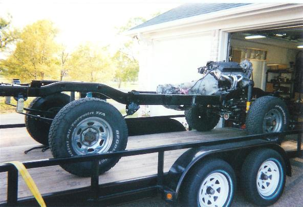

I see what you are saying. The AA adapter I used did hold a factory mount which bolted right to the crossmember. I left the crossmember in the factory spot on the frame. The tcase did hang back farther than it did, because of the lenghth of the adapter, making the need to adjust shaft lenghths some, but the crossmember itself stayed bolted in the same spot. With all of this bolted together, the SBC was perfectly centered in the engine bay and the adapter with the stock Toy mount bolted to the xmember in the factory spot. The pic of the frame is difficult to see but this is the setup originally with the SBC. Factory xmember bolted in the factory spot.
