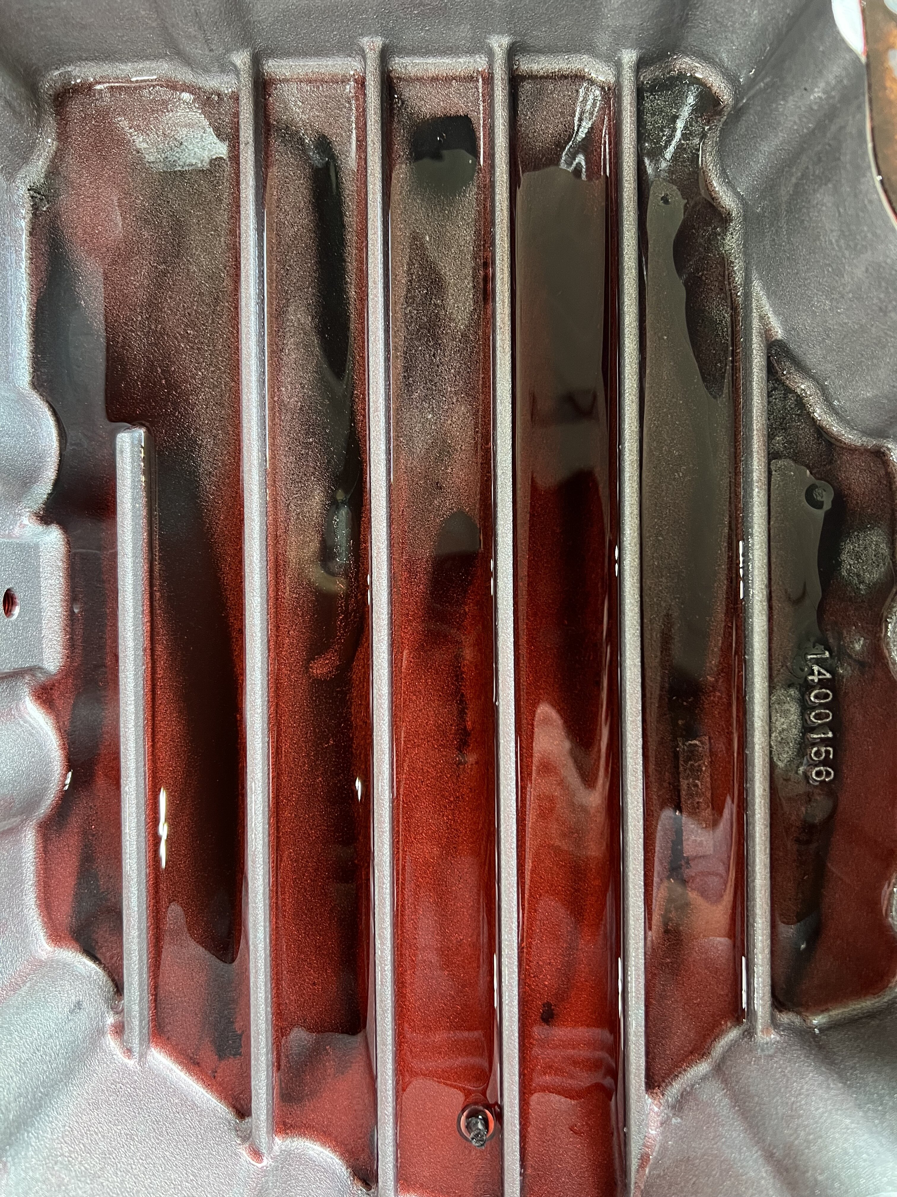

Pulled my transmission pan off my turbo 400 transmission and found small amounts of sludge at the bottom. The transmission was rebuilt 1000 miles ago.
Should I read anything into this or is this common?
Here’s a pic:

Maybe some type of assembly lube? Is there glitter in the pan? I would imagine a fluid change to be necessary with in the first few hundred miles.
I would think that's normal wear/seat in bands/clutches material dark stuff - wouldn't expect much glitter. I'm not a slop bucket guy but I like watching Richard on youtube ripping them apart Precision Transmission
