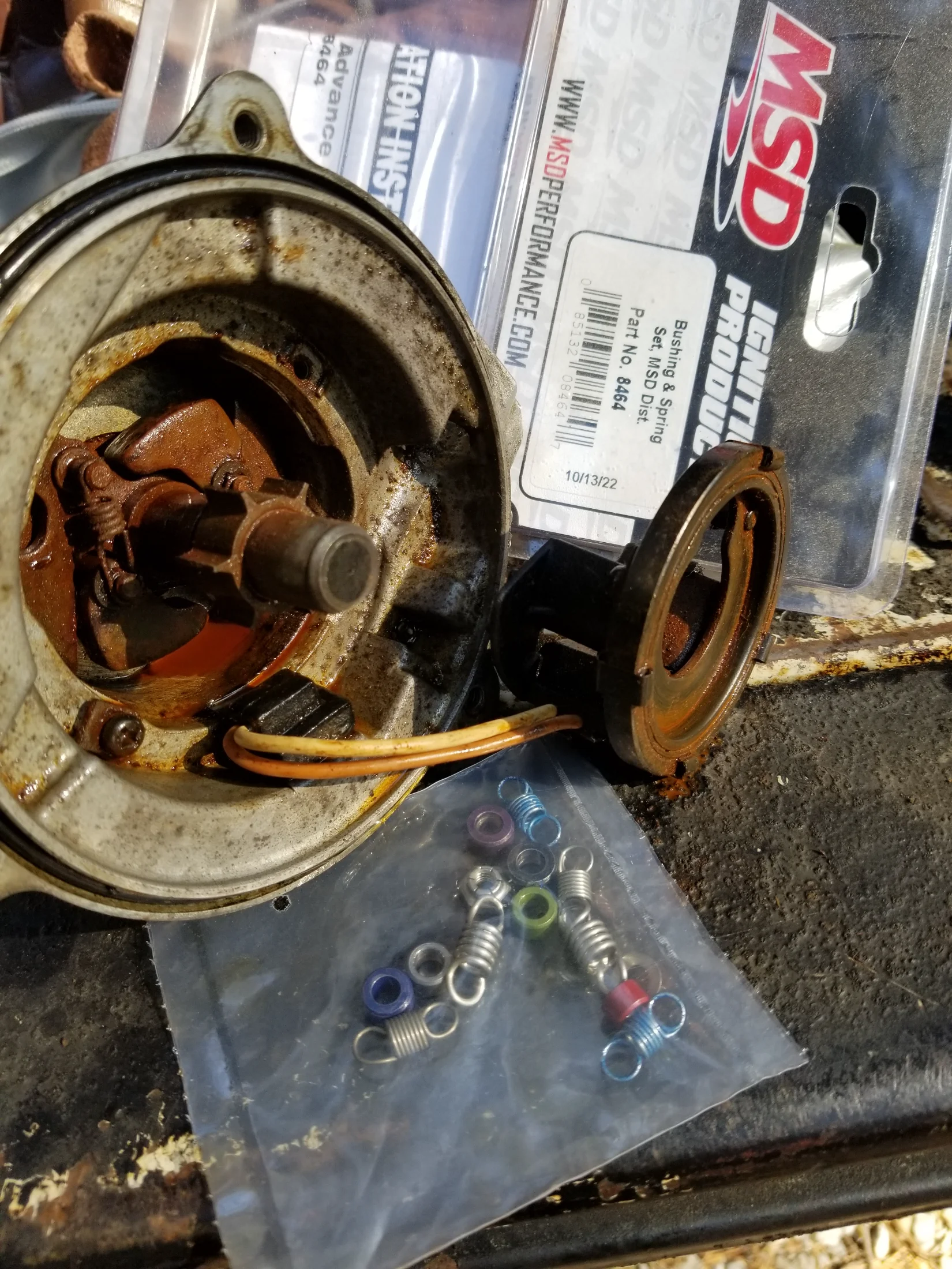

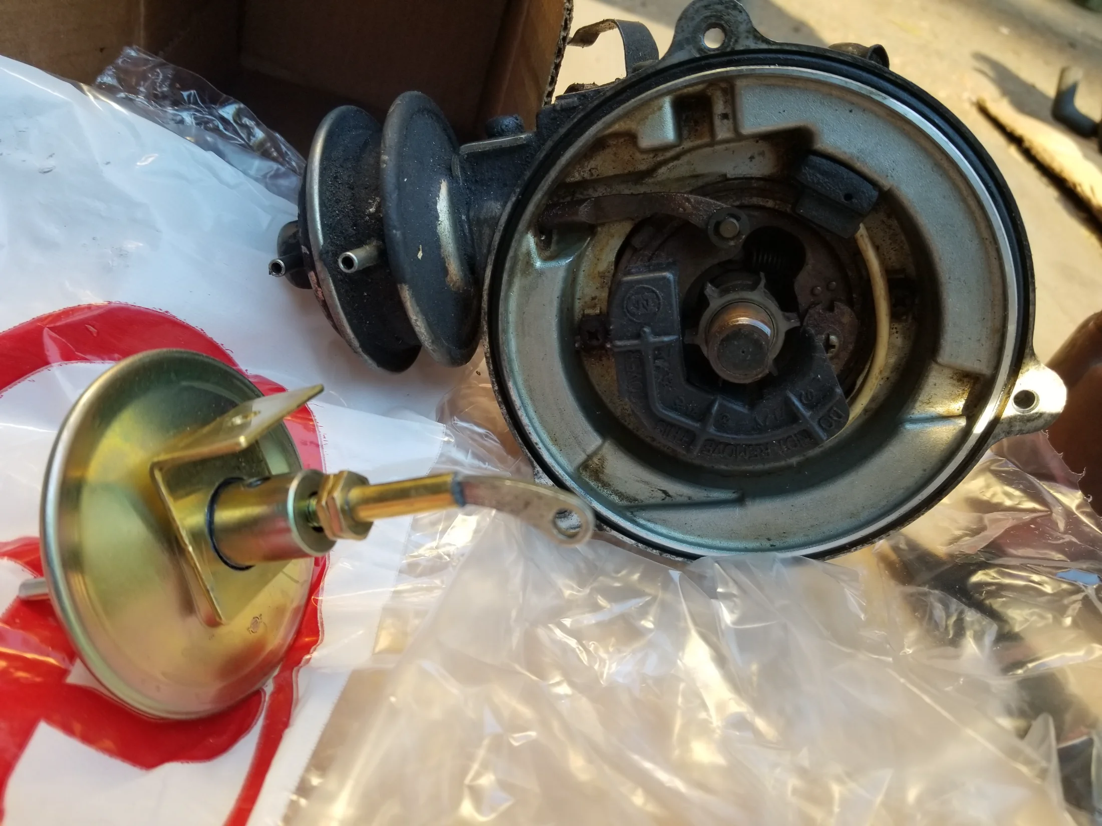

You can do that. I did. 60 series Big Cap dizzy into a '76ish completely de-smogged 2F in a '74 FJ55. Got a single diaphragm vacuum advance module from @4Cruisers to replace the leaky 2 diaphragm original unit, got some advance springs off the wall at my FLAPS to play with and just like that I've got the best running dizzy I've ever had, and I've tried all the LandCruiser F and 2F vacuum advance dizzys there are.
