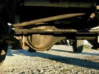

1st pic head on is bad relay rod angle. 2nd pic from the side is with high steer, and is a much better angle. Bumpsteer effects can be enhanced from all the other stuff mentioned being in poor shape. Good note on the caster; have a shop check it out and give you the results.
hth's
gb
