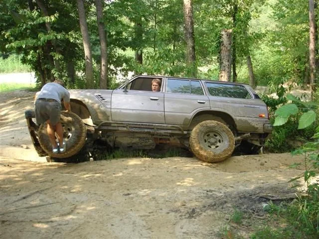

here is mine!!!!!

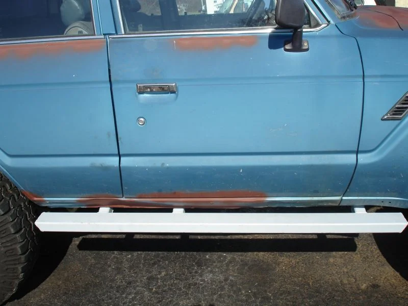

If you don't need the 2 x 4 slider, the tube sliders from Marlin seem to work fine.
attachment.php
Yeah, I got the marlins too.
For the pirce, they cant be beat. There are some mods that need to be made to the sliders in order for them to work, but its nothing too challenging.
Mine have been abused and theyve held up nice so far!

hey cameron, where'd you take that picture? bottoms?
