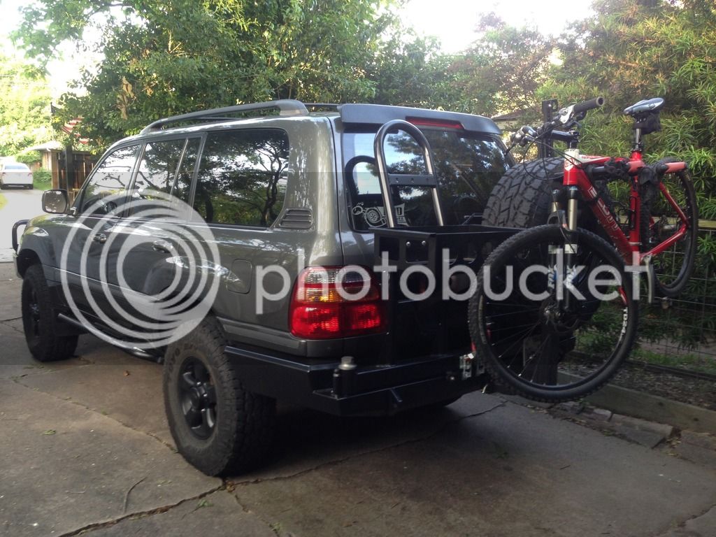

I had to modify my adjustable hitch so it would fit, I cut around 3 inches off the male hitch end, drilled new locating pin holes and cut the top off the adjustable sleeve to allow the wheel carrier to open without the bump stop striking the tow hitch.
Oops, here's the pic.

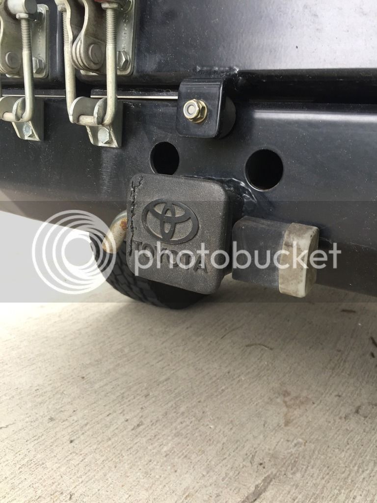

I was having a similar thought / issue with my new Slee rear bumper. I have always been used to having a hitch or a shackle mount locked into my receiver with a locking pin, however the pin hole is so close to the bumper that I can't use my locking pin. I checked the local auto parts store and did not see anything that would possibly work. Is the only solution to drill another hole further out like @Batlowboy did? I would like to be able to lock in a hitch bike rack from time to time also......
This one by Fulton works for me....even use it to lock up my Yakima bike carrier....
awesome! I will order one online! Thanks for the reply.
