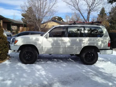

triskelion said:
christo, here is the recent pics with 285/75

Looks sweet man. Nice balance front<>rear. Looks like 4" taller than the stocker :)

Great ride man! Thanks for the pics.
