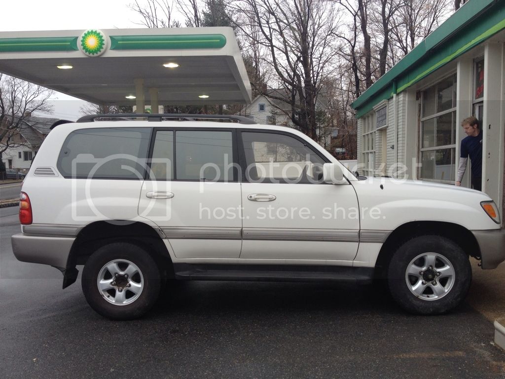

now she sits like this
any thoughts?
normal?
is back or front sitting too high or low?
im sure someone here has the same kit installed and can chime in on their first day with the lift
thanks guys
285/75 going on tonight or tomorrow
ok so rear is up way high

maybe i shouldve went with the 2.5 front 1.5 rear
i was debating that

I have the Slee OME 2.5 heavy kit going on now, expecting the same stink bug look but I don't mine.
Im with 860s and I am near level. Its what you prefer I suppose, factored in with droop.
I have the same kit on mine. The medium kit was designed to carry a little more weight than factory. The rear will ride a little high and be on the firm side until you install a swing out or drawers or whatever in the back

the rake you're seeing is pretty much normal for ANY rig that gets lifted with brand new springs (coil or leaf) simply because they aren't broken in yet and haven't settled to their normal height. if you raise the front now, in a couple thousand miles you'll probably be wanting to lower it back down a tad. i would drive around with some weight in the back to break them in faster before lifting the front too much.

Without having a measurement for the front I can't comment on the front height. However the rear is probably where it will be. They normally go down a little after some miles. If this photo was taken directly after pulling it off the lift, then yes, that is what is to be expected.
The 2.5" lifts we sell can't be set up to be level without compromising front droop. Also, unfortunately people want a number assigned to a lift. It is very rare that a lift will be the exact amount front and rear, yet we have to call it something. So the numbers we give is normally an average between the front and rear.
The OME2860 is a compliant but fairly tall spring, however it works really well on the 100 when people what decent load carrying when camping etc, yet they want it unloaded with a decent ride during the week. If you want it level, then we have to start going with a smaller lift and that is why we termed the 1.5" lift. That one can be set up to be level, however you run the risk of looking like a hyena when loaded.

christo, here is the recent pics with 285/75

Unfortunately it really isnt as straight forward of an answer. If I still had that setup I would give you my numbers. But, seeing I dont, here are some basics.
You want to maintain a minimum of 60mm of droop in the front no matter what. If you dont it will affect handling.
Next, these trucks really want the back to be about 1-1.5" higher in the rear.
So, measure your rear, subtract 1-1.5" from the rear and you will have the ideal number for the front. If setting that number, just make sure you have the 60mm of droop or more.
