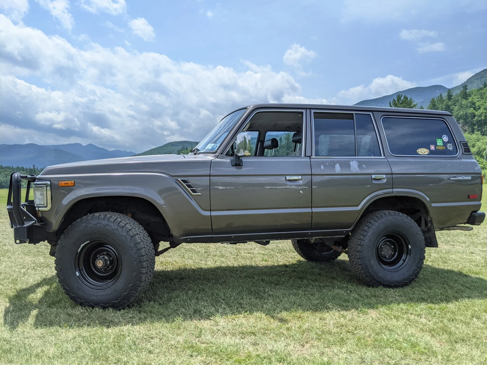

I went with the 15 in. x 8 in with 4.00 in. Backspace, (Wheel Vintiques 12-580604 Wheel Vintiques 12 Series Smoothie Wheels | Summit Racing - https://www.summitracing.com/parts/WVI-12-580604)
Powdercoated black.
One inch spacers on the front.
