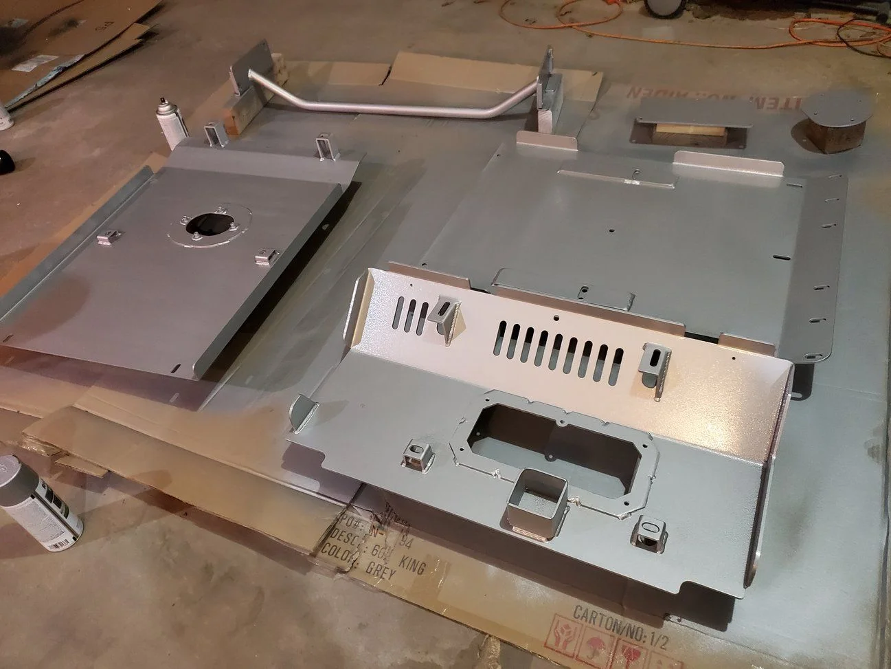

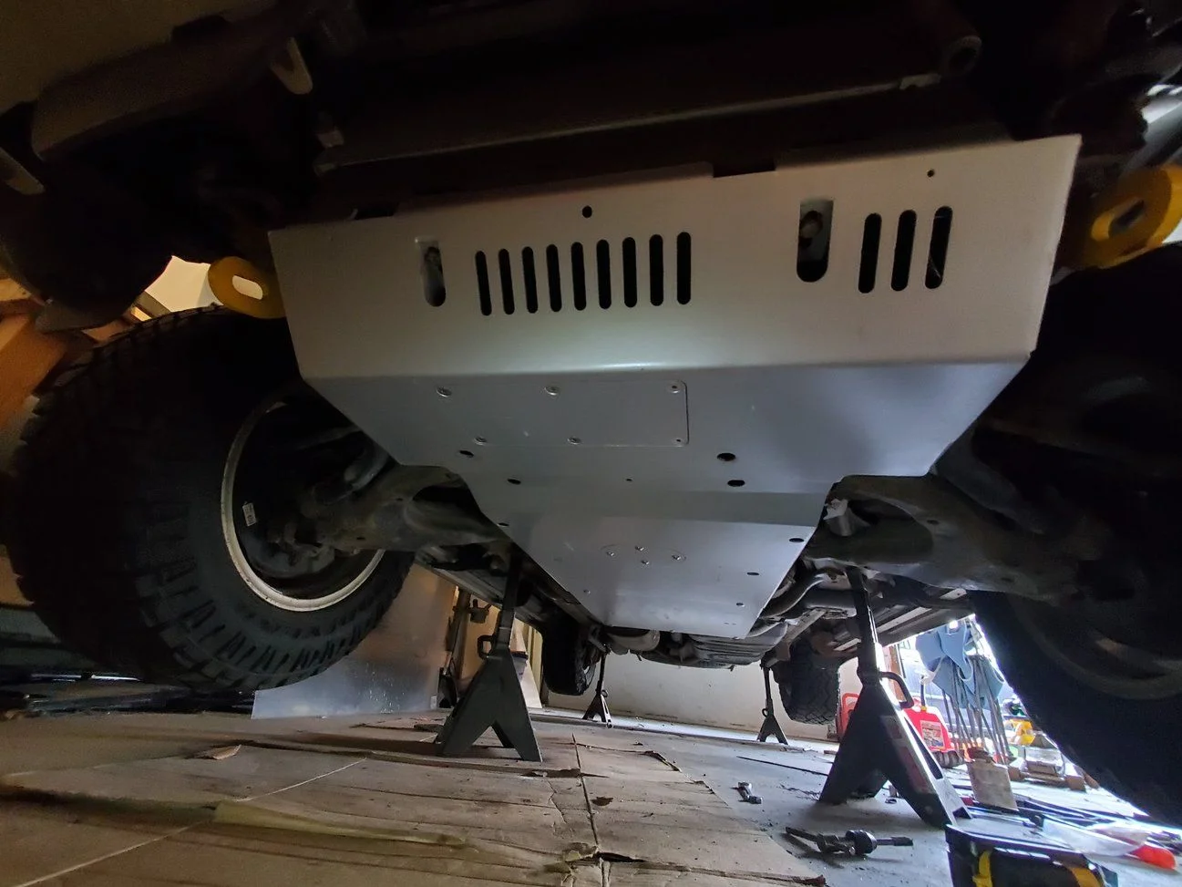

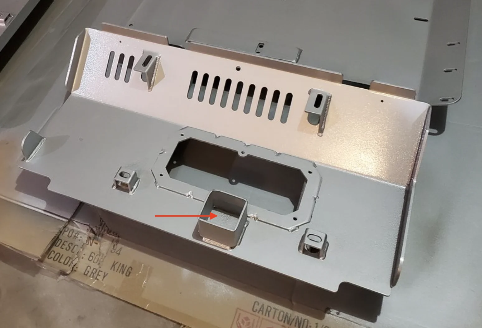

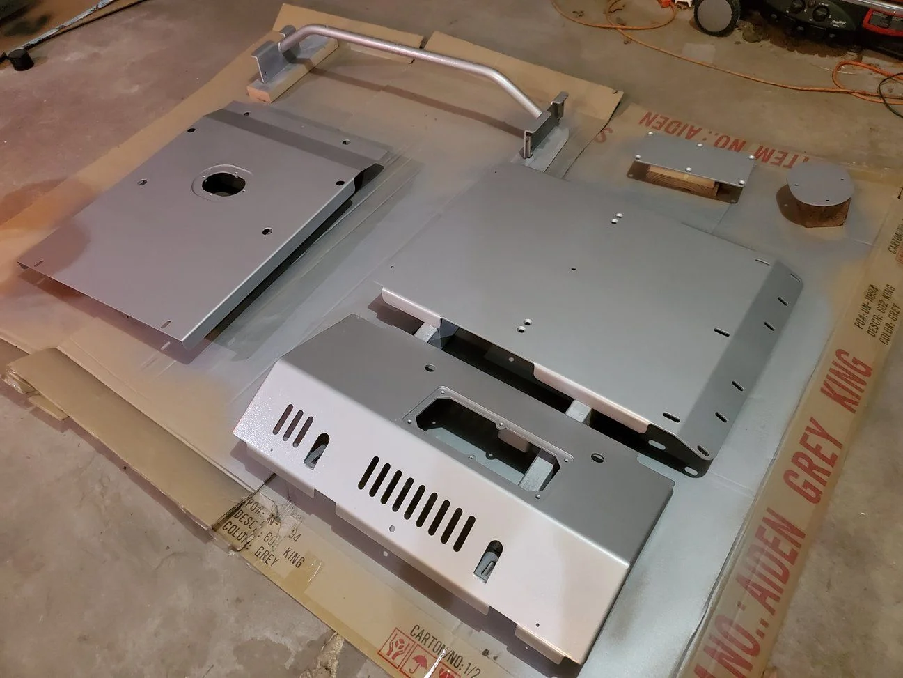

I have Budbuilts on my '12... oil filter access door and strength were part of development. I was told it was load tested as well. They are a small shop though so there is a substantial lead time. I run a Fumoto oil drain valve on mine. Some say they can leak over time but I have personally never experienced that in 25 years.

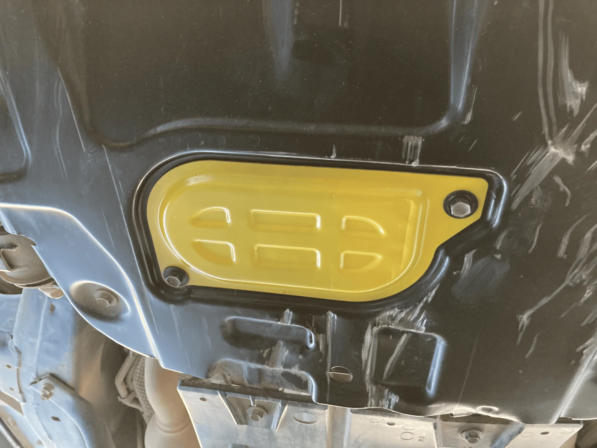

I haven't figured out a clean oil change in this beast yet (I suspect Toyota didn't make it easy on us either). I'll probably add a fumoto valve for directing spent oil, but filter housing removal (and gasket) baffles me (and a local quick lube place).
For fun - since it was scratched up, I painted the oil access lid (OE) this wknd. hard to miss now and if someone sees it in normal operations, it probably means the wheels aren't down where they should be...

They were actually designed off 460 mules so the oil filter access door placement is optimal for the 1UR-FE as well.
