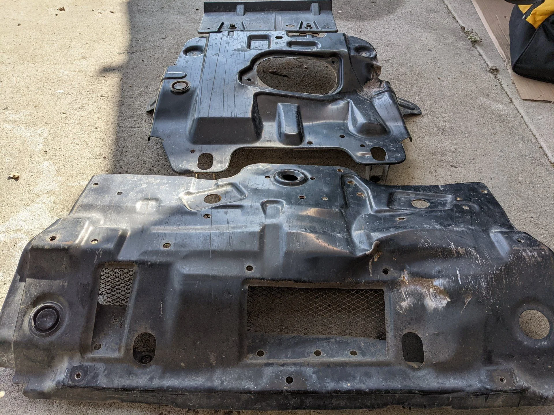

Lexus front underbody panel : 14lbs (there is a second panel with oil drain access)

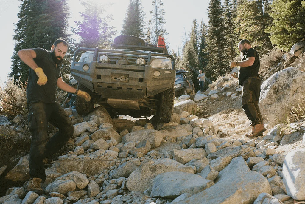

Our group did have a great & challenging day descending an abandoned road in the Elkhorn Mtns (Oregon). Rock stacking, regular spotting and patience were the key. I was happy to have the RCI skid.
That's a great shot of your rig!
mma guy -
Damn. Good on you, man! I am confident in my GX, but I would be stressed and sweating like a ho in church trying to do what's in the picture there! lol
It is yet another example of how badass these rigs are and can be. I've been on some crazy passes in CO (a couple while the vehicle was still all stock!), but nothing quite like that. Love seeing these kinds of pics!

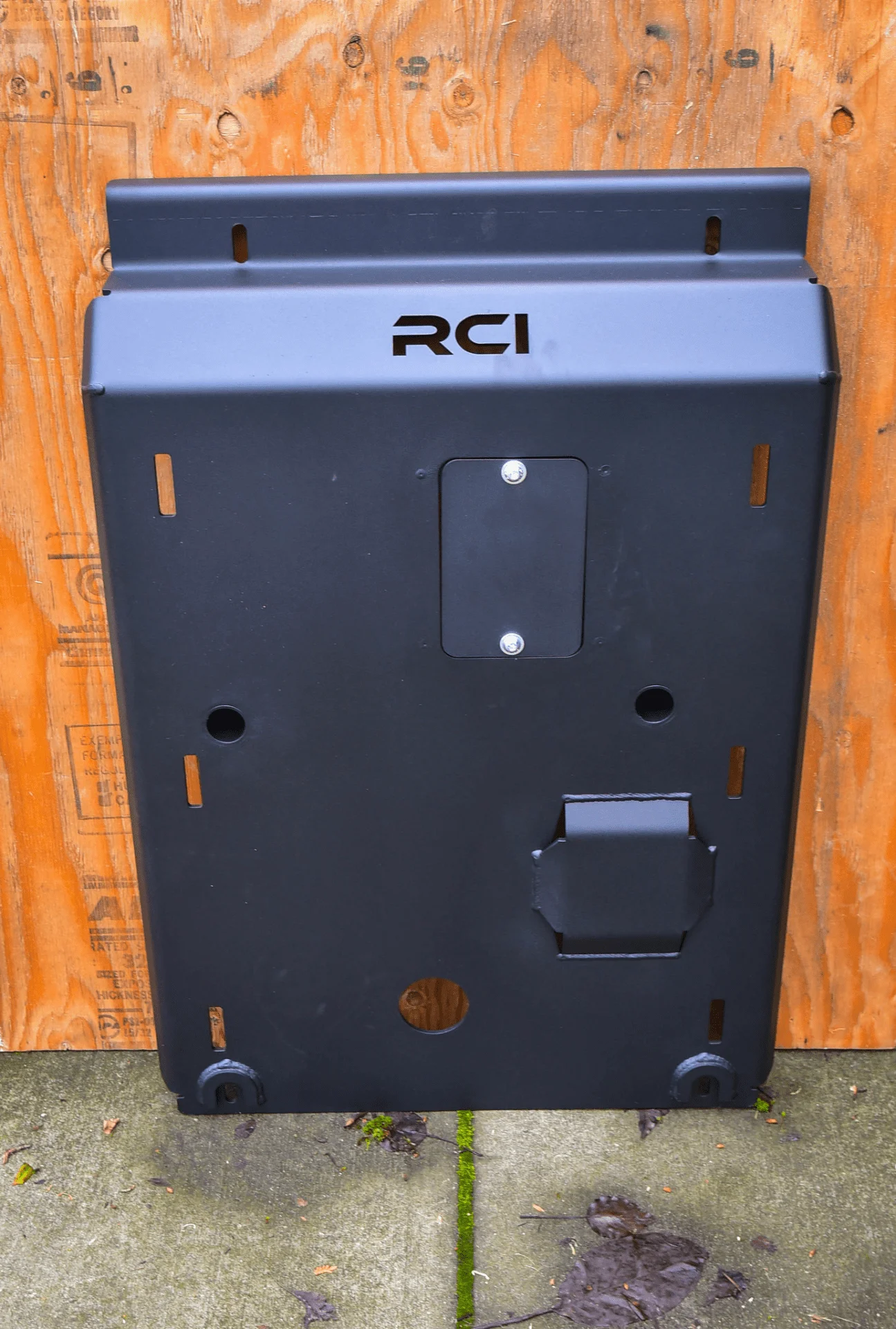

So I just installed my full set of RCI sliders, engine back to gas tank. Love them so far. I did an oil change and filter just before installing them. Has anyone been able to successfully change the oil filter through the access plate? Web site says you can't. It looks close. I've got several thousand miles left to contemplate it, just wondering what RCI crowd has to say.
My experience with the RCI skids and changing the oil, yes it can be done. When draining the oil pan the oil gushes with such force that it sprays inside the skiplates. For me that is a no go as you will never get the oil spray cleaned up and will have residual oil in that area. Can be done but if you like to know that the oil drips that you may see are a real problem or residual drips remove the forward skid. Mine is usually filled with dirt and rock anyway, good to clean it out.
Good to know, thanks. I have a short-nipple Fumoto for the oil pan that "should" eliminate the splatter? The filter is just messy, no two ways about it. I guess it's not that big of a deal to drop the plate. Be good to look around up there once a year anyway.
