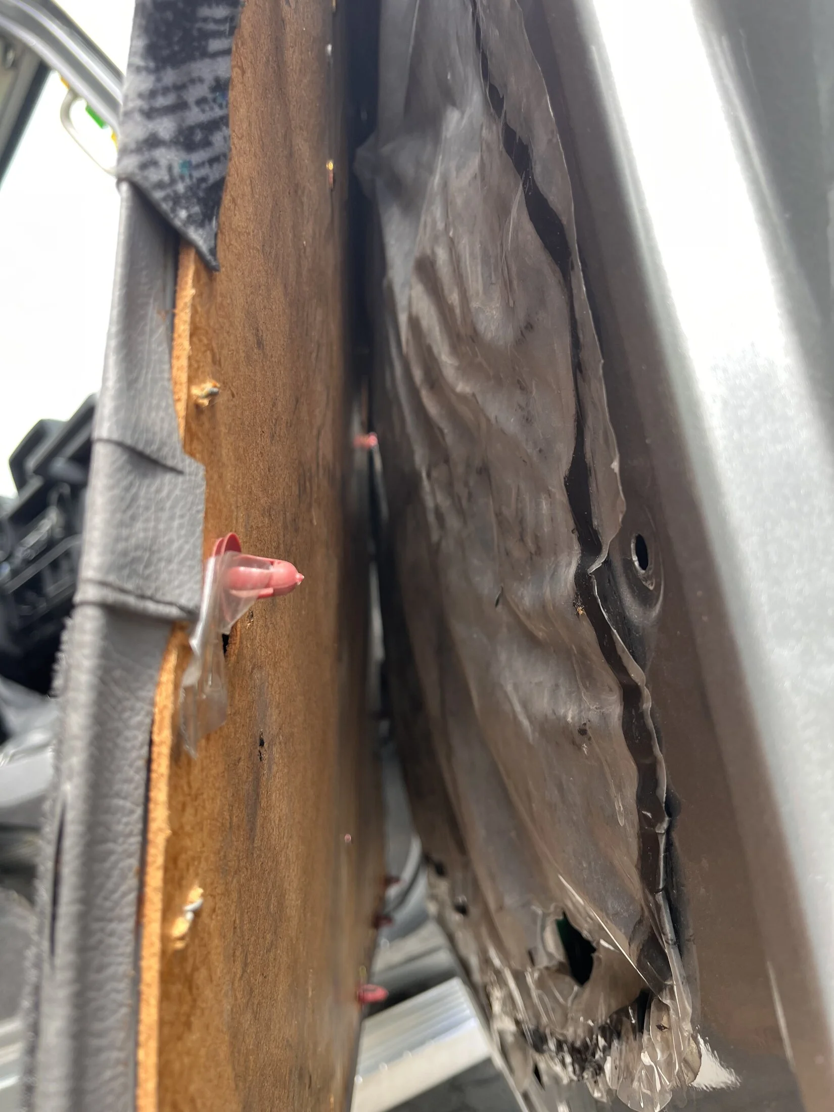

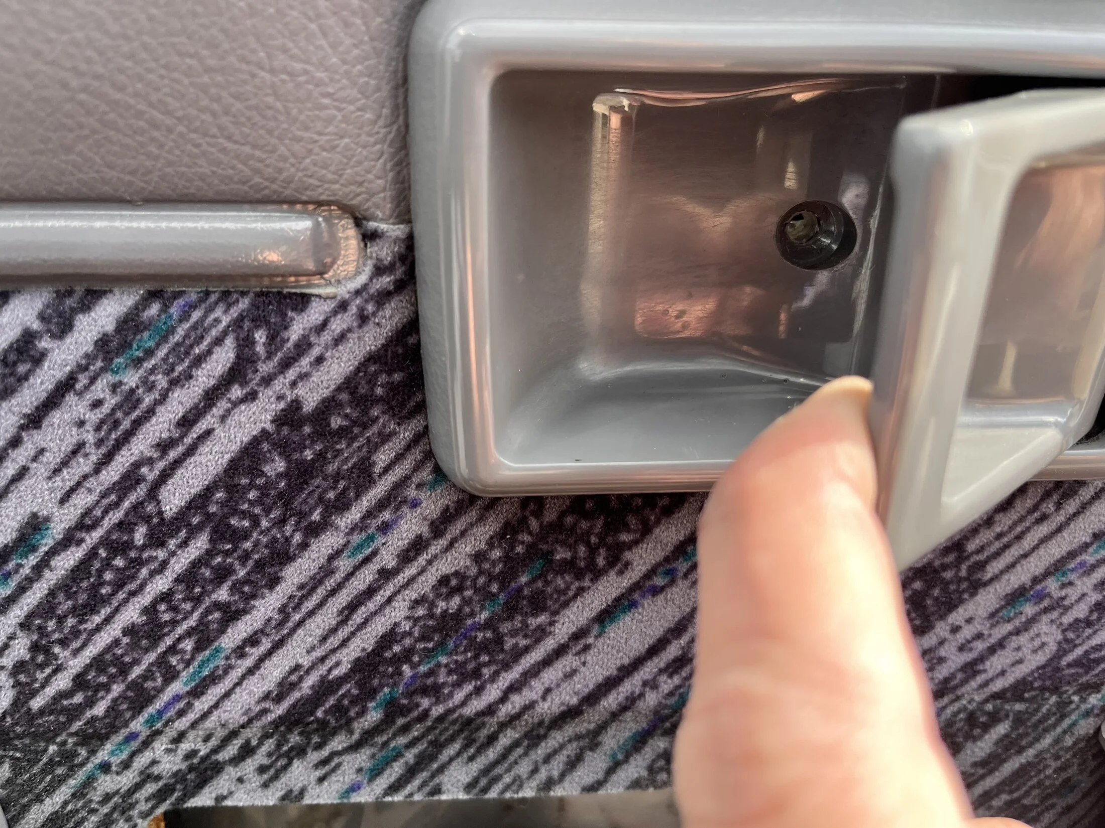

So i was able to het all the red clips off and then the trim on the top. Unscrewed three screws. Two from armrest and one from door handle. Should the whole door handle latch pop off? Seems like it is held on pretty good

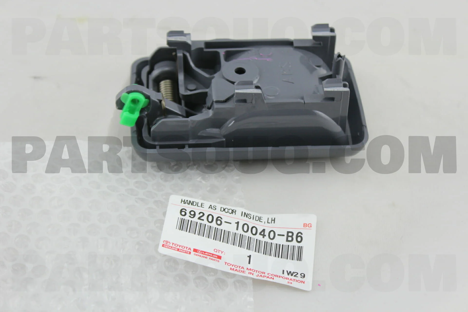

Hi.
You need to slide the door handle back (or forward... I can't remember) . There are hooked pieces that slide into the door. Then turn the plastic (green thingy in below pic) piece to release it from the rod. Once released you can slide the rod out.
Picture = 10000 words.
Hi.

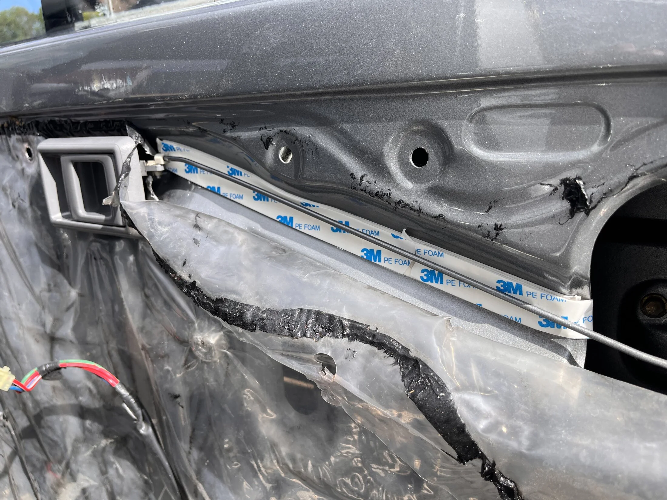

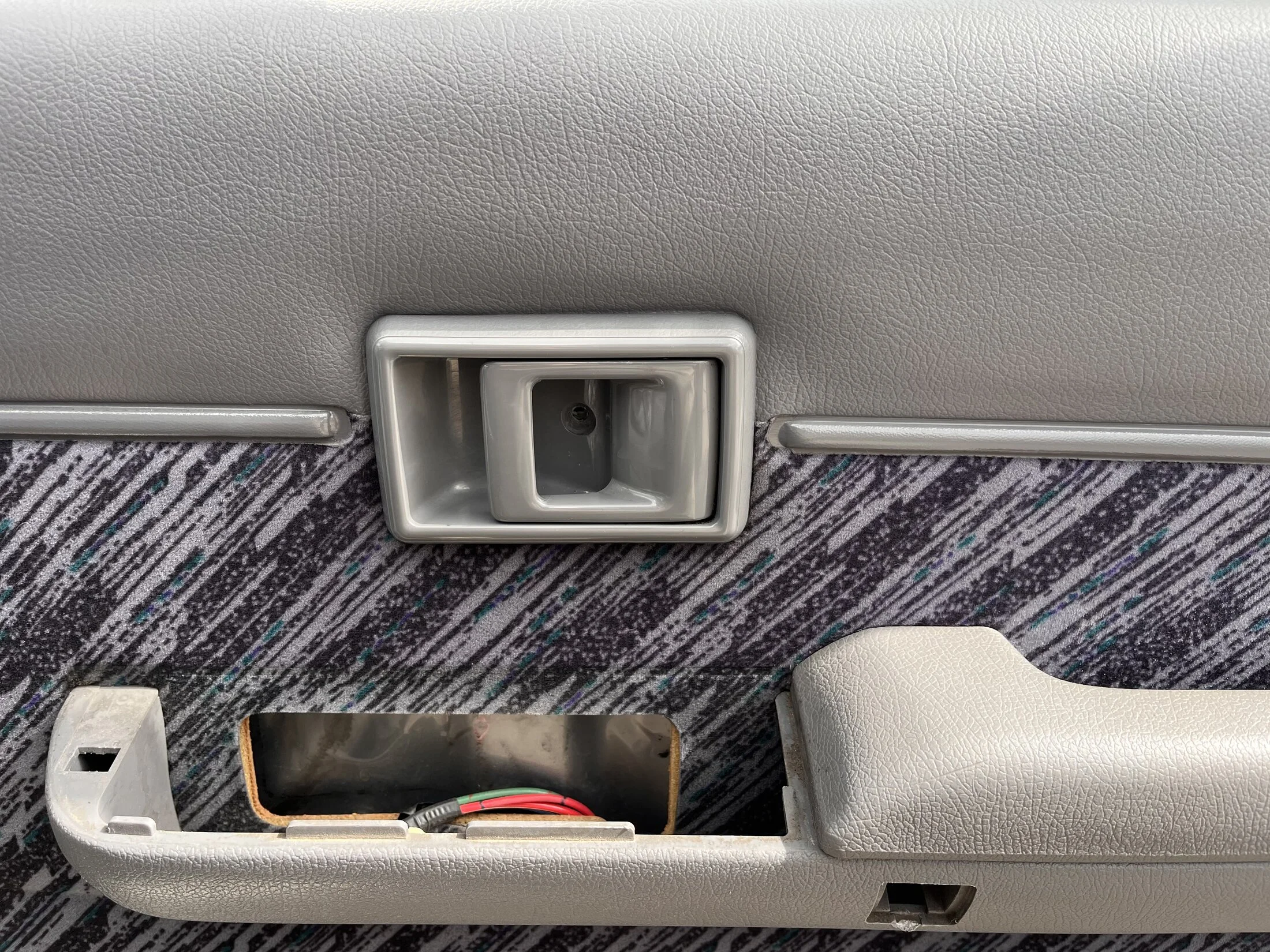

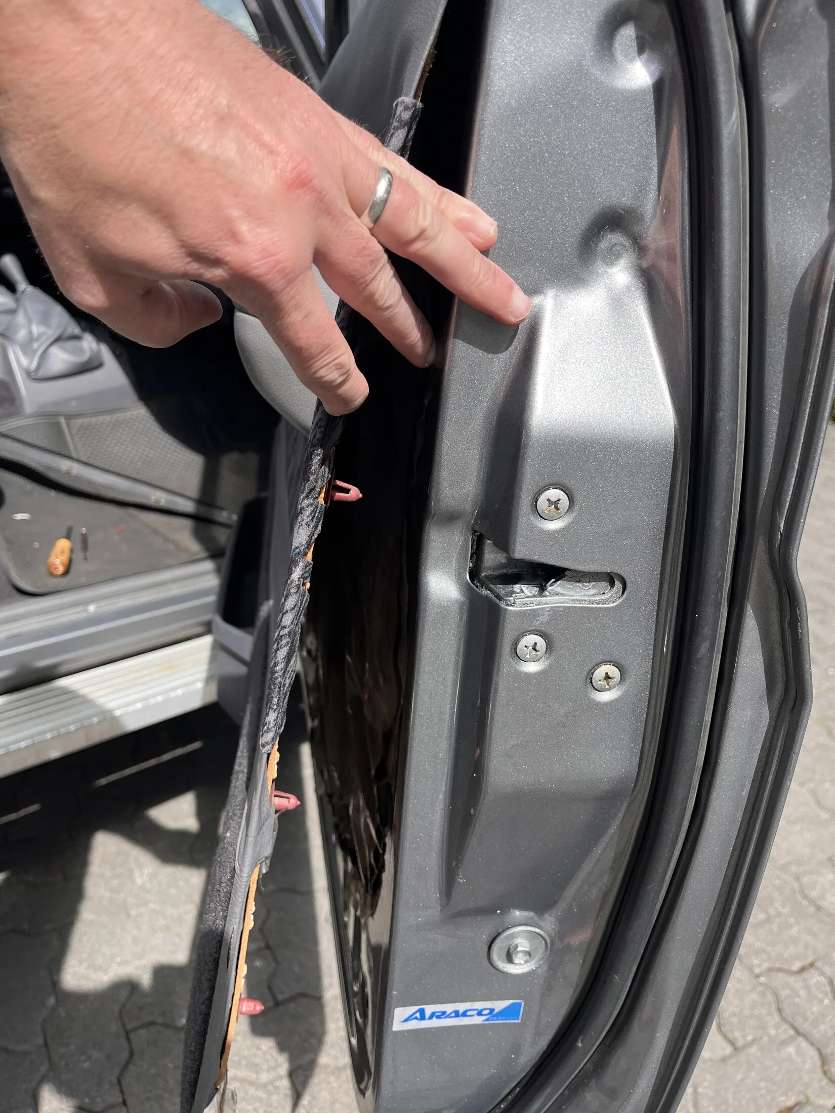

View attachment 3916353Ah perfect i was able to slide it forward but never disconnected it from the rod just pushed it through the whole. The rattle was the door handle rod beating agains the metal door. My fix…..

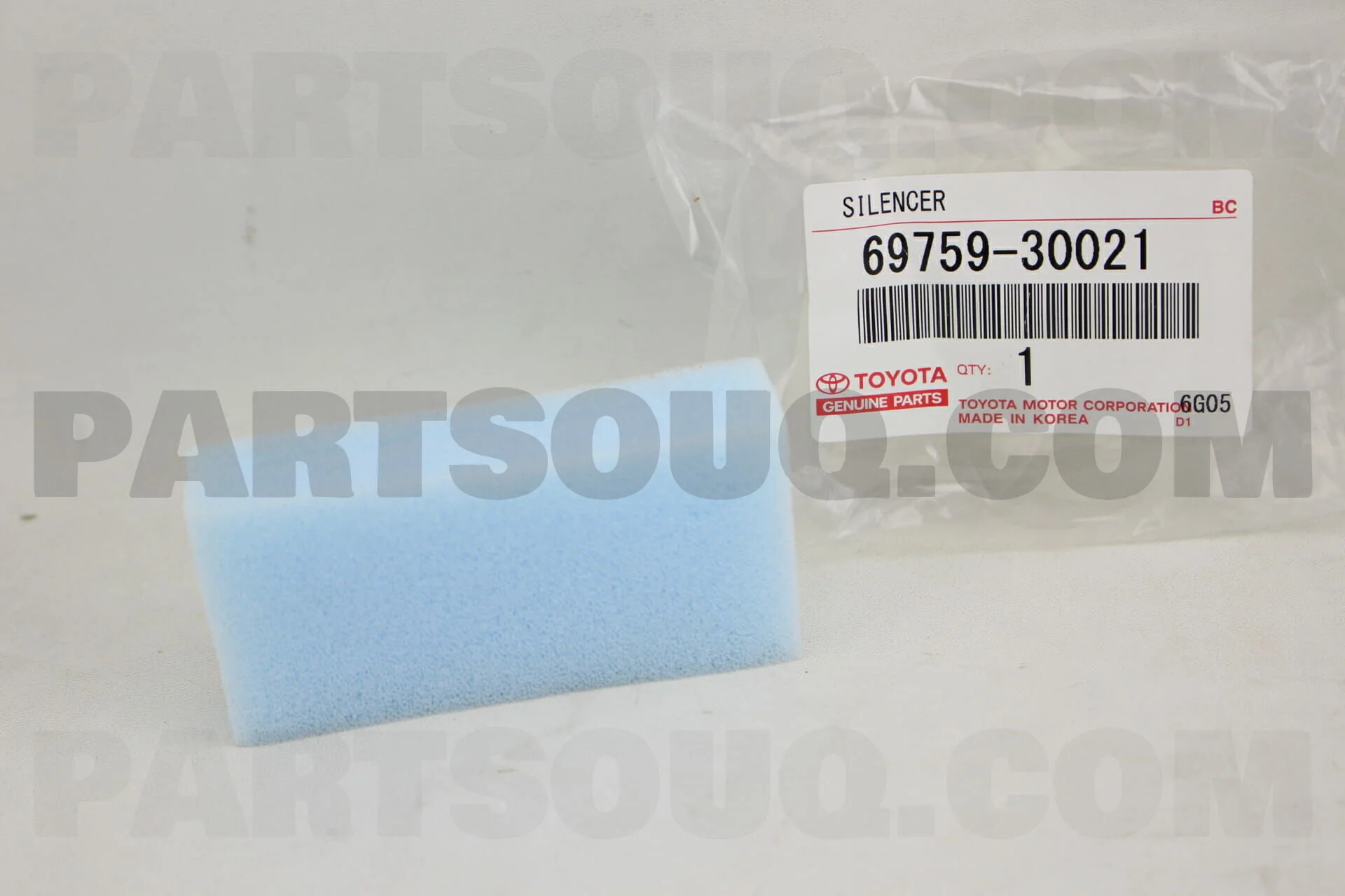

Ahhh. That'll do it. There is usually a foam "silencer" there. Looks like >
These are not the part numbers for your rig, BTW. I just googled.
