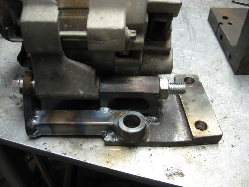

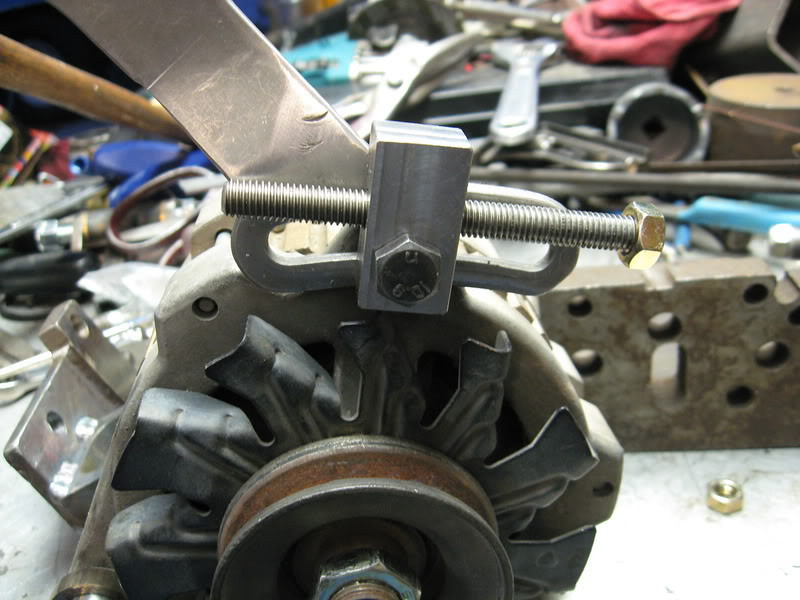

Patch had a plain R and while I never had a problem directly with the alt., I could not get a decent lifespan out of the separate regulator. My dealer told me they were NLA. Maybe they were right and maybe they were lazy (there is some considerable evidence of the latter from other matters). I went thru 3 or 4 regulators from various parts stores before I gave up and made the pivot bracket and tensioning bracket that fit a Delco CS130 in there. Cut the pigtail off one of the failed regulators so that my wiring mod unplugged from the engine bay harness.
EDIT: Found pics of the brackets nearly finished in case anyone cares. I'd always hated that the PS and the A/C had tension adjusters, but the Alt didn't. So my bracket had one. Made adjusting the belts a LOT easier.

Building that lower CS130 pivot bracket wasn't simple either. I wanted it to bolt in like OEM using the OEM bolts. That took some figuring. If I was going to make them for sale I'd either investment cast them or possibly print them as I bet that I had close to 30 hours in building that one
