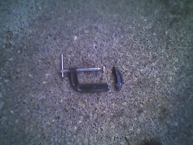

:)... Make sure to use quality c-clamps when taking/assembling your spring packs!
What, did you borrow the HF "leaf spring" holders from your neighbor that he won at the meeting and have a bad experience?:hillbilly: Just teasin'
hhahaha.... this is how my old budget c-clamp ended a few years ago when I was adding aals to my old spring packs.. I keep in my photobucket account just for this reason. :)

What do you need clamps for? Just be quick on your feet and point them away from you :hillbilly:
I have never seen a C-clamp do that? get um @ the dollar store?
when releasing the nut on the spring packs... there is more force there than you think, use two clamps and "walk" the pressure off the springs.
