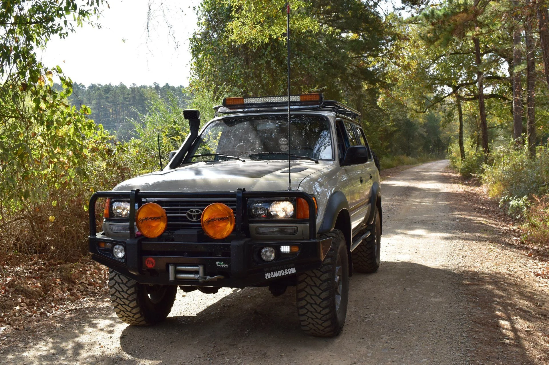

I was in the same situation. I really wanted a Slee but didn't think it would do anything to protect against deer. I chose my bumper when I was routinely driving on deer infested roads a lot. I went with the ironman 4x4 deluxe bumper because everyone and their dog had an ARB and you can run larger lights in the Ironman. I'm definitely a fan of the barwork. They've saved my fenders from lots of trees and branches.

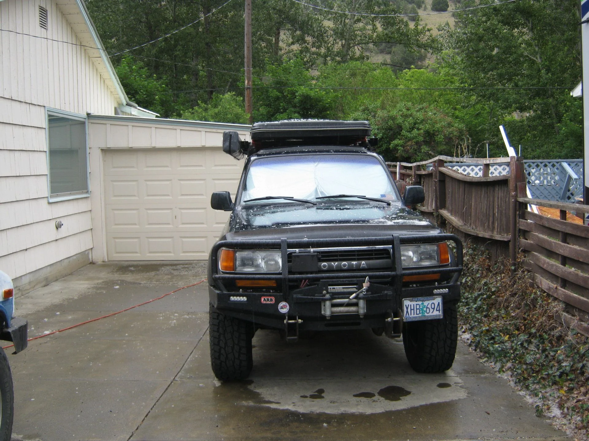

ARB bull bars continue to take flak from unbelievers and owners that want their own individual looks. I've taken flak myself for trying to defend them. Reasons like approach angle, clunky looks & everyone's got one. I live in an area where deer are considered a nuisance and the peace of mind I have driving with my 80's ARB is hard to explain. So, I've got no deer damage to show for one reason - 3 letters - ARB. However, an idiot in a full sized Dodge dually pkup pulled in front of me on ice and I removed his passenger side rear fender extension for him. No damage to my rig or bumper save for the piece of his fender jammed into the corner ridge of my ARB. One thing's for sure though, if you hit something solid outside the frame rails, you're going to bend even an ARB. That goes for a large muley deer or an elk. Oh, mine's been modified to hook up a tow bar. And when I'm working under the hood, especially up by the firewall, I run 2" x 6" boards from the ARB to the cowl between the firewall and windshield to lay on or support myself and not have to burn myself or break engine parts. So, sometimes it comes in handy for other uses.

Can you share what led's you're running in the "turn signal" location the arb bumper?
I got them at a Les Schwab tire store. The brand is CSI. I measured them at the store and knew that's what I wanted to fit there. I previously had Wallyworld el cheapo halogens, but the bulbs kept burning out. If you google CSI lighting and go to their website, this page is as close as I can get. Not sure if it's exact, but looks like it. They used to be in the off road group of aux led lights. I like their weather proof connectors, too.
Thanks! Did you make a bracket or did they bolt in there?
The single mounting point bracket that is included works perfectly. Measure and drill a hole, aprox centered in ARB surface under headlights and they hang just right. You'll need to bend the ARB light mount tabs out of the way for the led housing to fit up snug inside the opening.
Oh and BTW, the leds in those ARB turn signal enclosures are aimed perfect for me. I use them in addition to my headlights on the rural roads around here and I can usually see wildlife well before it gets to the road or in front of me. Makes all the difference in the world, IMHO.
