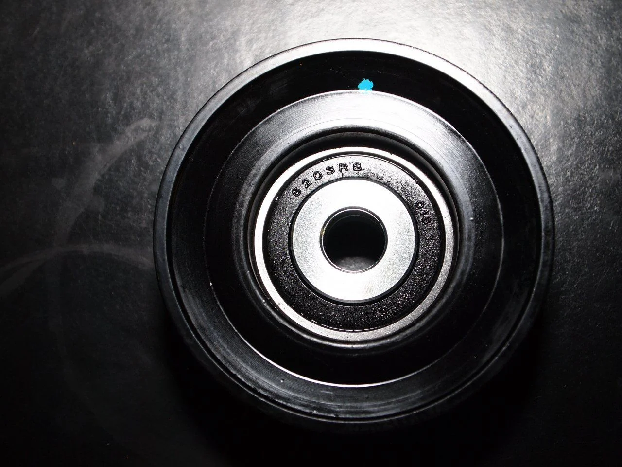

That looks like a 4 Season pulley/picture. I bought a 4 Season pulley because of their bearing number in the picture is the same as OEM. It turns out it has 6203RS bearing. Very curious to see what bearing is in yours.
I'll send it back if not as pictured, if it is it's a great buy. Was the 6203RS the one that width is 2mm less?

6301 fits OEM pulley but it is 2mm narrower. My guess is 4 Season redesigned the pulley to use 6203RS.
Both 6301 and 6203RS are 12 mm in width. I haven't tried the 4 Season pulley out to see if I need a 2mm spacer.

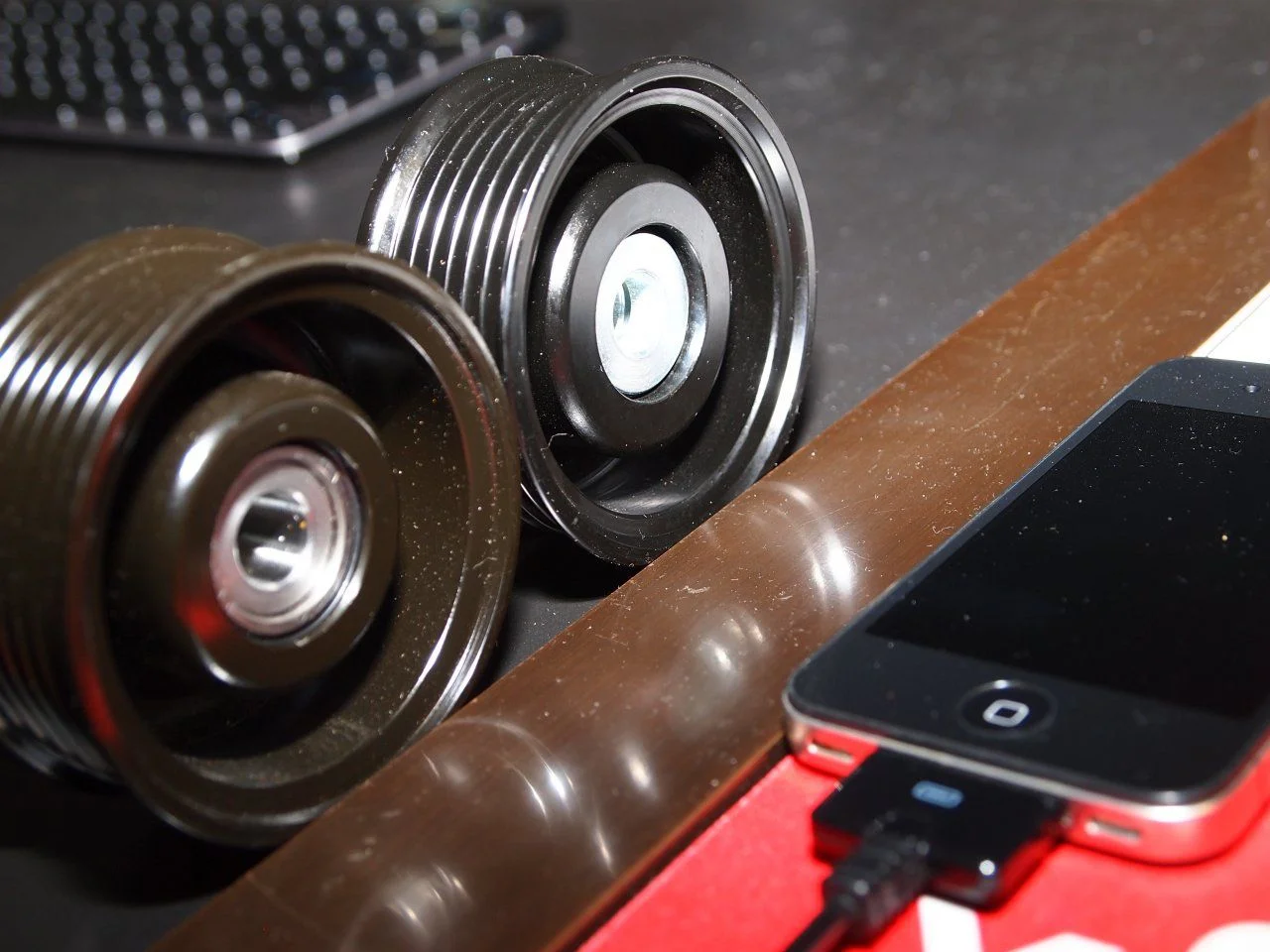

Idle Pulley/Bearing arrived from Rock Auto today, it is NOT as picture on their web page. It's the thinner width 6203RS, with wide bushing. Slight difference in the pulley end bevels. The offset is the same, as far as I can tell, as the OEM.
Dose 6203RS run quite and last a long time?
First images after mkt 6203RS
Brown is OEM. See the bushing protrudes on the 6203RS.
6203RS
6203RS

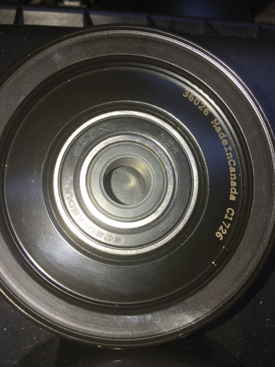

@2001LC not sure if you're still curious but I just fitted a Gates 36026 idler and the bearing is the same Japan NSK BD20-15DUL as the OE idler it replaced.
