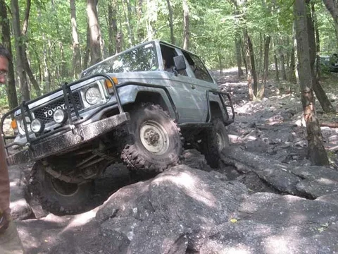

I need to replace the leaf springs on my BJ70 (1986). The truck is equipped with a bullbar up front and extra duty rear bumper (with swing out tire carrier), plus rock sliders below the rocker panels. So on a daily basis, she is carrying a few hundred pounds of extra weight. Adding to this when I go off the pavement in the mountains; I carry tools and parts plus a CO2 tank. This adds more weight to the load (+200 lbs as a guess).

They are OME that the previous owner installed. He did not define exactly what series, but I expect that they were medium duty (comfort ride) because they would come close to flattening out with a basic load of tools & parts ready for the mountains. ~8 years ago, I modified the rear springs with an Add-a-Leaf. This helped a lot for several years, but she has been settling noticeably more for the last few years when loaded. Three weeks ago at CMCC; after one day on the trails, the right rear spring was flat against the frame. Jacked her up so the spring fully extended and then eased her back down. The spring promptly laid flat against the frame. Once I got home and completely unloaded the truck, I jacked her up again to fully extend the spring and the spring stayed up with the shackle only about 30-40 degrees past vertical. She stayed up with no load (beyond accessories).
