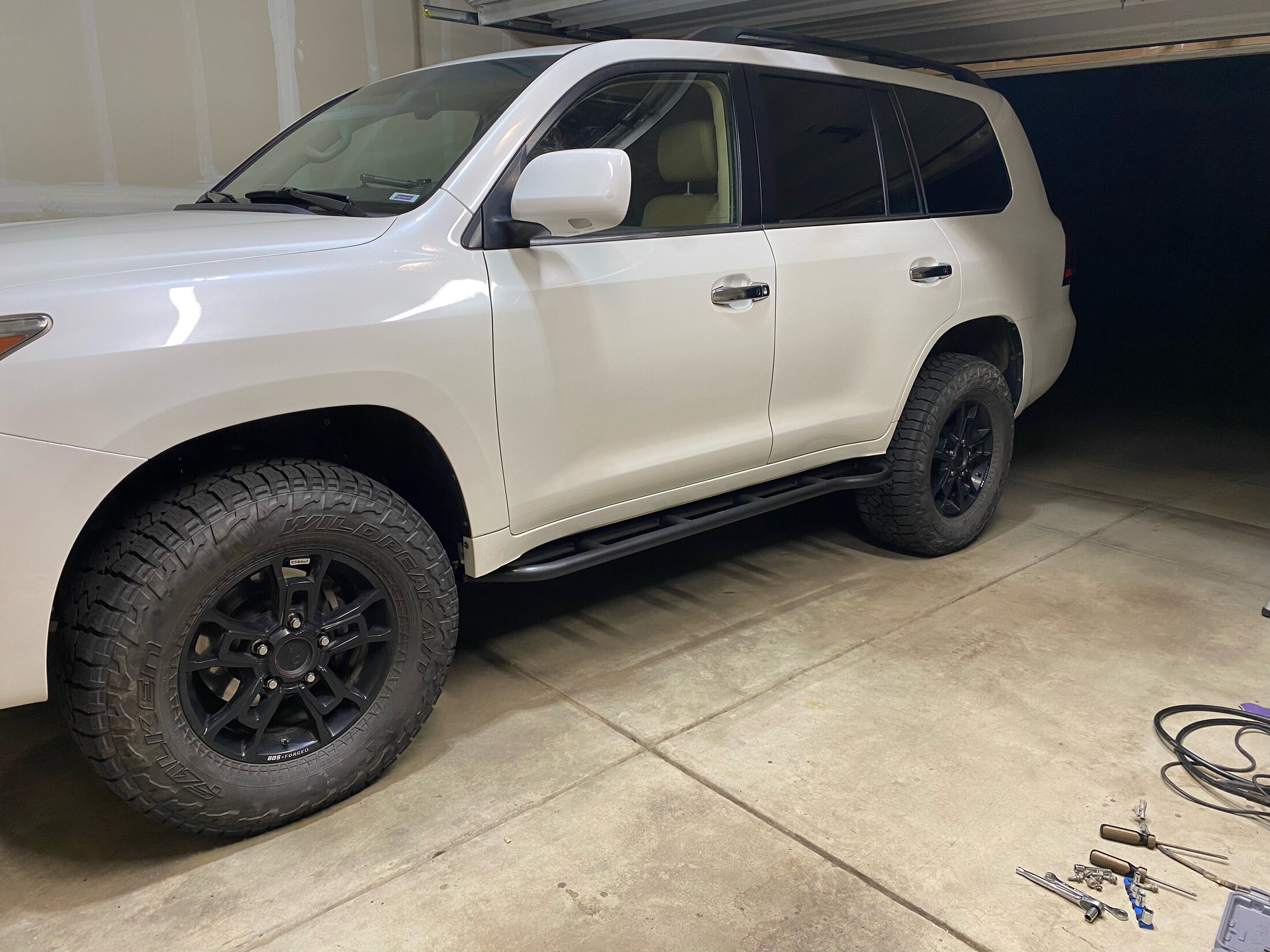

Lastly, a little sneak peak of what I'm working on next. Time for some slidey bois!

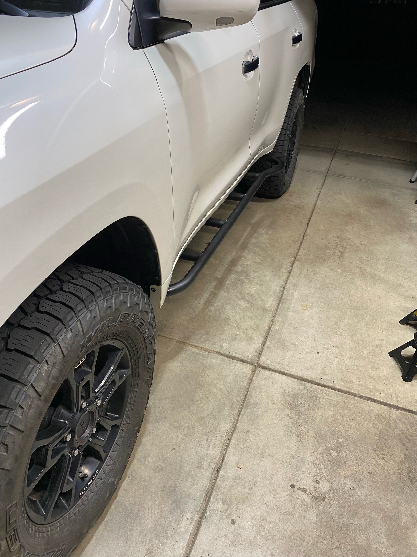

Did a bit more work on the sliders this weekend. Good stopping point for now, calling this V1. V2 will likely include filler plates and potentially another mounting arm or two plus some courtesy/rock lights. Realistically I don't really ever go on super challenging trails where I'm rock bashing so these should be plenty strong for the occasional hit I may encounter. But then the other half of me thinks well what if.. and wants to add more strength and overbuild. There is a good mounting point to the frame forward of my current leading arm, but not so much the rear unless I get more creative.
Sliders are 1.75" .120 DOM and brackets/gussets are 3/16". Finished in krylon textured black.

Worked on the passenger side this weekend and added the additional supports. Still need to go back in and add some fill plates, but I am much more happy with the amount of support this has and the additional bolts to clamp to the frame. Will do the same to the driver hopefully next weekend. Plenty of boogers, but also some half decent welds too if I don't say so myself. Annoyingly I did end up with some slight warpage so two of the bolts slightly don't line up anymore. Off by like 1/8" on each... Will need to enlarge the holes to account for that then I can get a jack under this thing and see how it holds this heavy piggy of a rig.

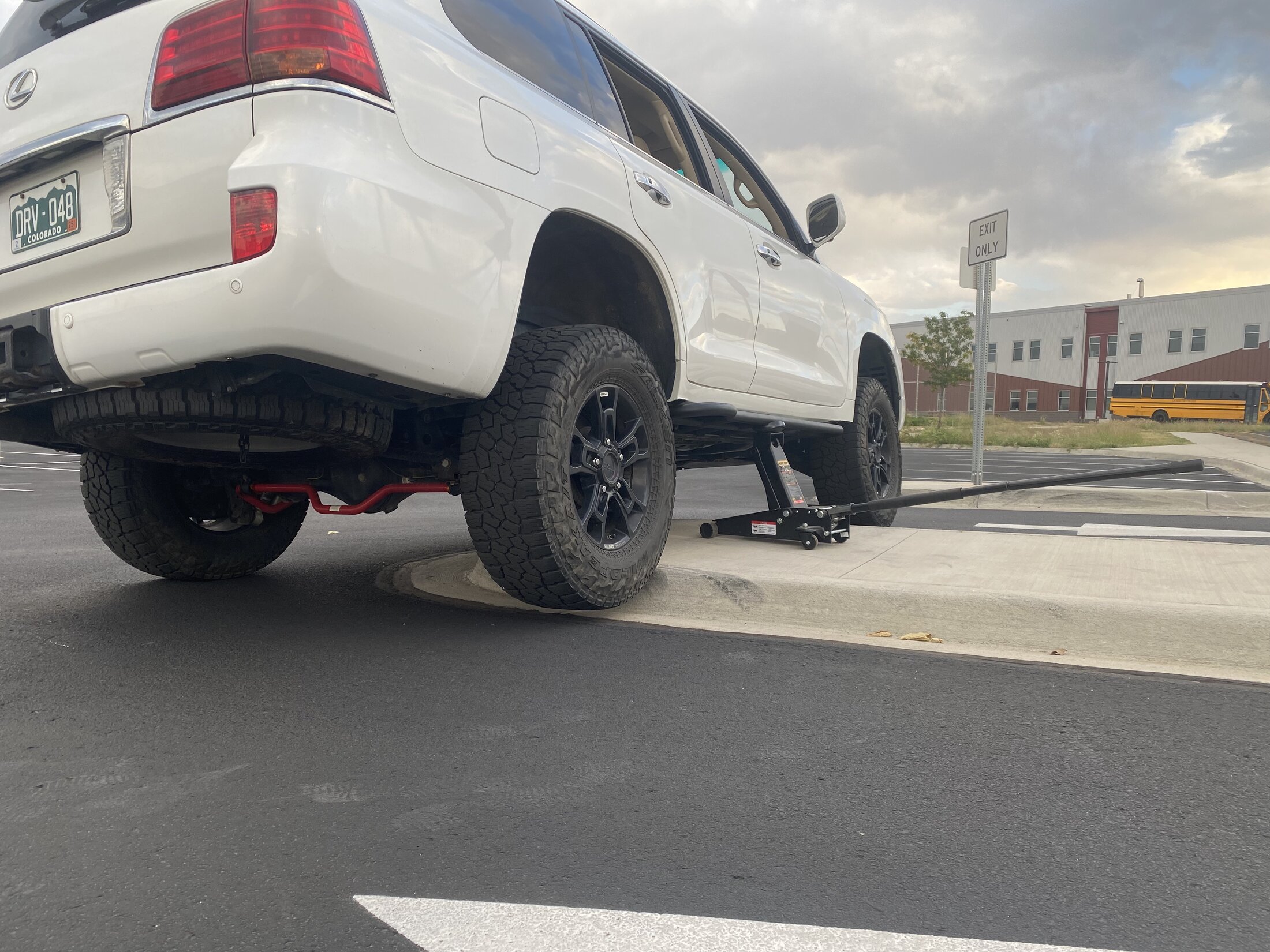

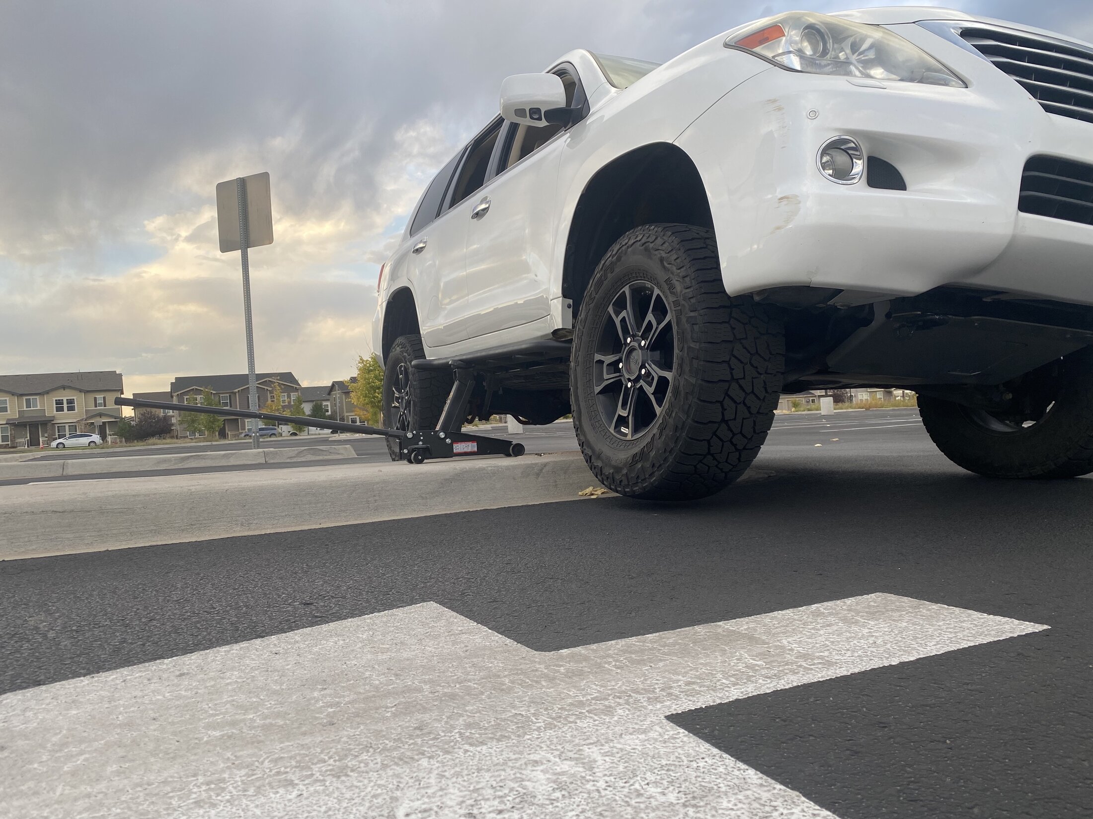

Fill plates on the rear door area (worried about my dogs) and preliminary jack test. I'll be the first to say it...the fill plates look like garbage lol. I'm planning on cutting them off and trying to come up with a better looking solution. Stood up great to the jack test though! Straddling the curb my jack could barely get the tires off the ground, but did slightly. I'd say at the point with the most deflection, still about 1/4" to 3/8" clearance. I built these to have 3/4" clearance from the pinch weld of the body, so should work out pretty good!

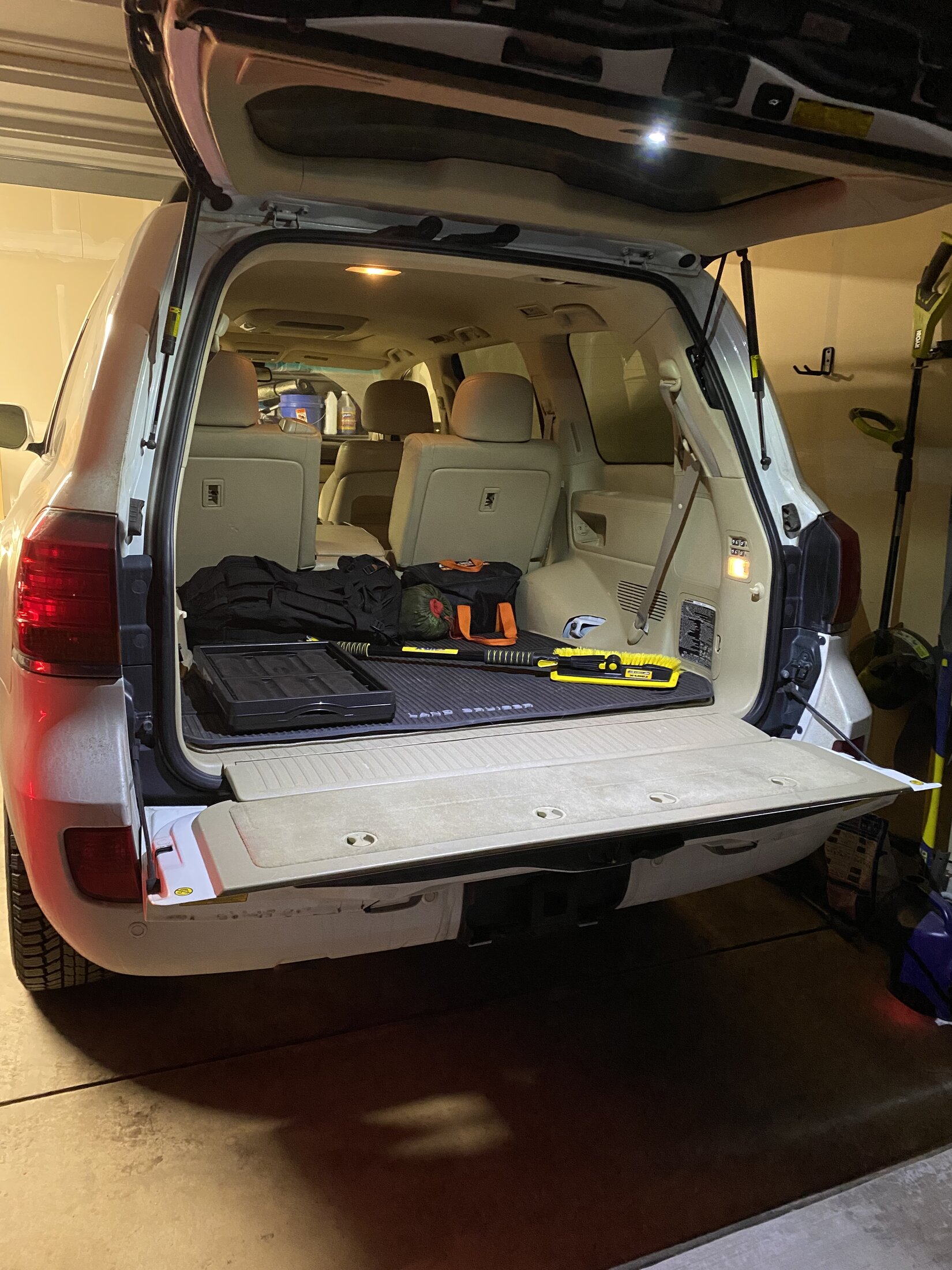

Got a cargo light in a 3d printed housing that one of the facebook group members makes and sells. Forget his name, but it's super slim and a great plug and play product. No idea why I waited so long to buy or make one of these. Game changer.

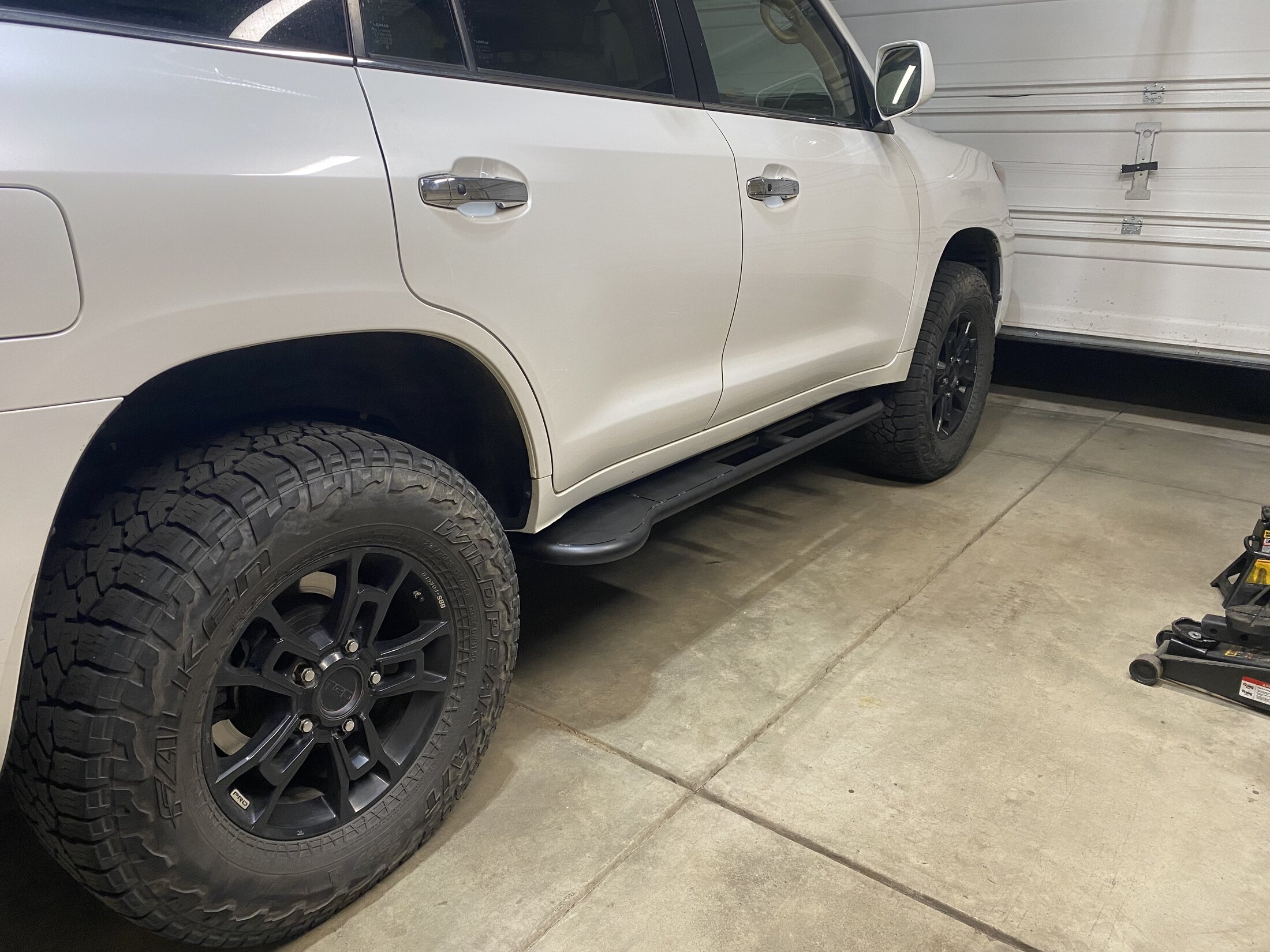

And lastly, decided to part ways with the TRD pro BBS wheels. They are super neat, but after a recent snow wheeling trip where I gouged one of them on a rock, decided I'd rather sell them while they're still worth something. Which would also give me an opportunity to get new tires to replace the falkens which ride stiff. Ended up getting like 6x of what I bought them for, so got some tundra wheels and sprayed them black and some very lightly used 35" KO2s. And pocketed several hundred.

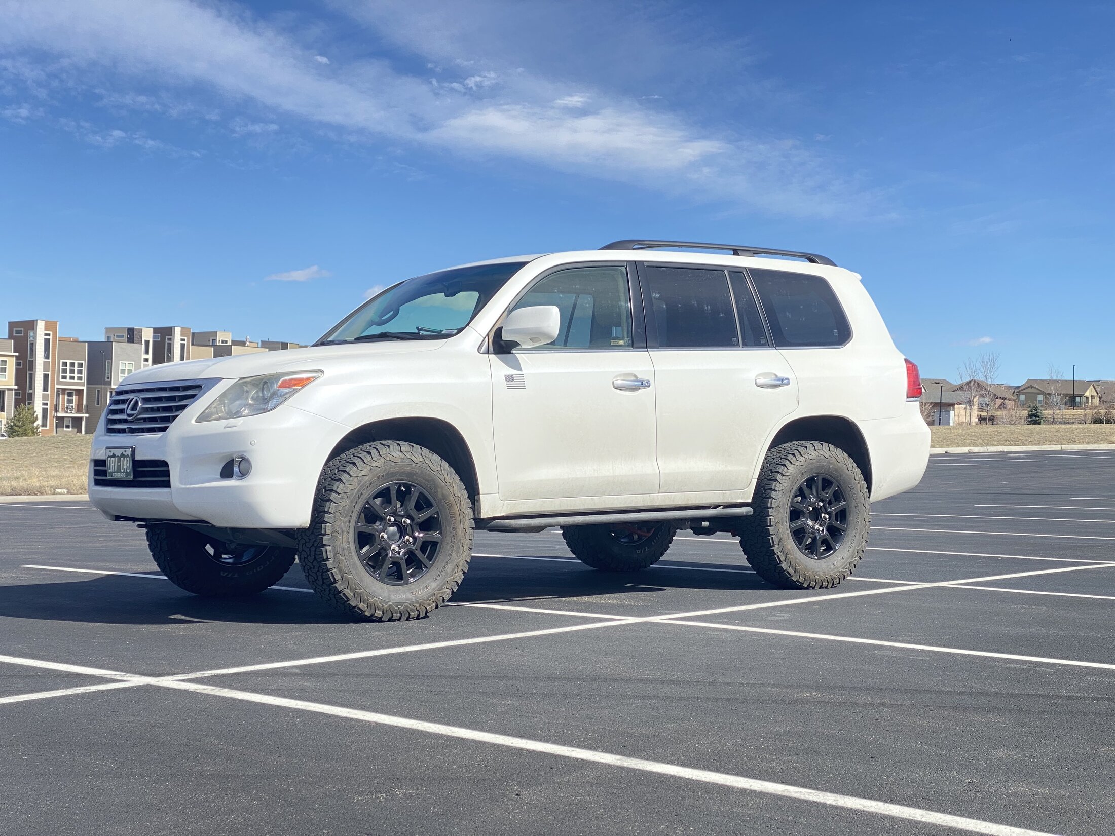

Love being back on a KO2. It was always my favorite tire back in SoCal. And since I run a full snow tire here in the winter time, not as concerned about icy/hardpack snow winter road performance. Off road I always felt the KO2 did great in snow. Eventually I'd like to get on some KO3s, but the size I'd like isn't released yet. For now, these still have like 12-13/32nds left (15 new) and were manufactured in 2024 so should last me a good while. They also ride sooooo much smoother than the falkens.

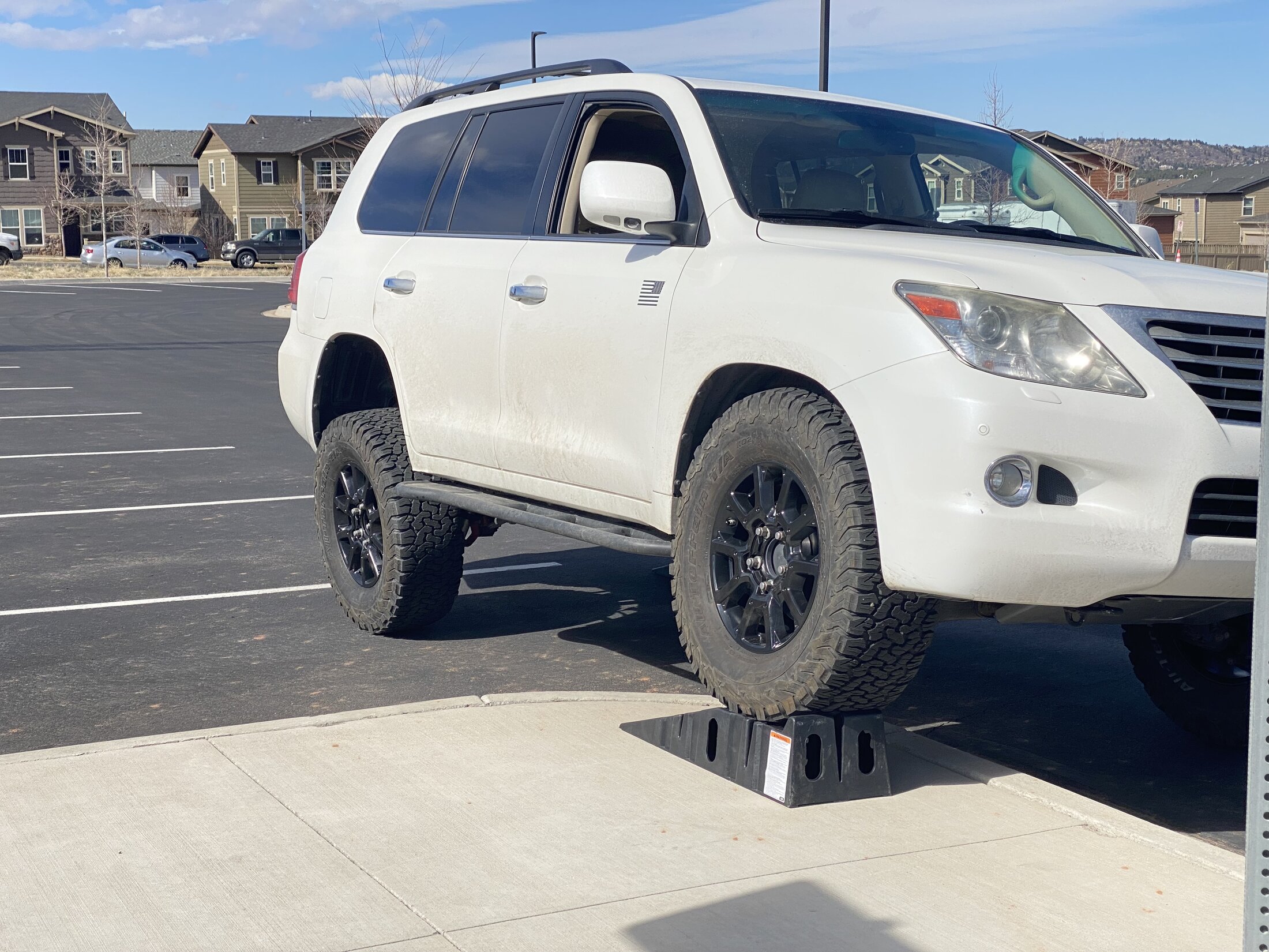

Committing to 35s this time around. So far everything clears great with all the previous mods I've done. But these do rub more on the front sway bar at full lock than the 295/70/18s did. Thank the extra width of the 35x12.5x18 for that. May take a page out of TeCKis300's book and clearance the bar a little. About 2" shy of the bumps in the photos--the best I could do to test for now. But should clear when even more stuffed. Just need to sort out the sway bar. Or only use 90% steering.
