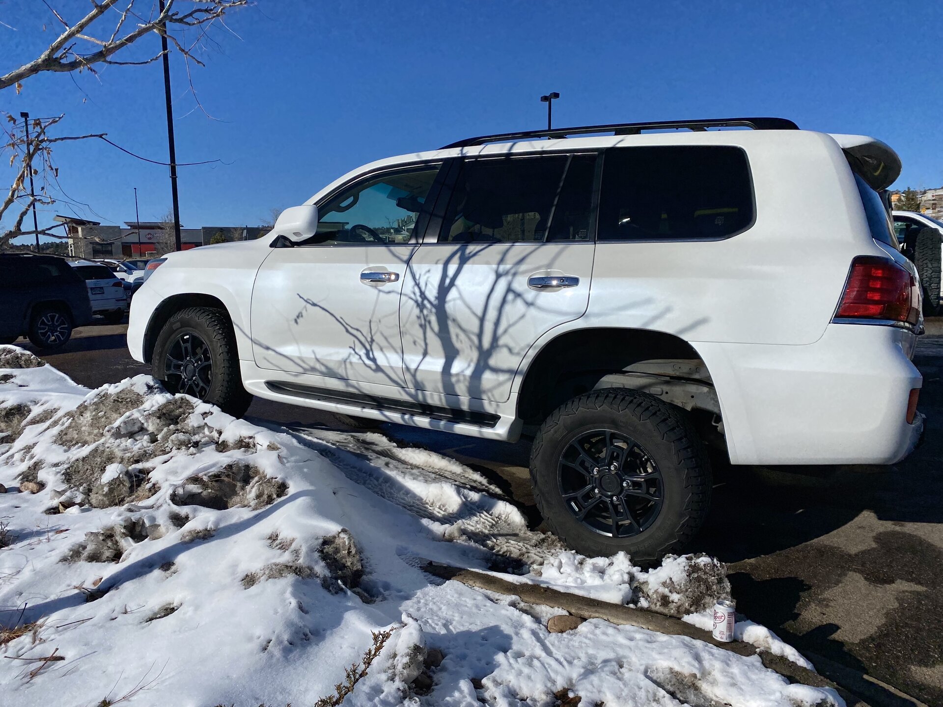

Pic for attention. That was as high as I dared to go without anyone to spot me. I wasn't in 4Lo and CDL was off and was already getting wheelspin. Could have definitely gone higher but too lazy haha.. This was my quick parking spot as I pulled off the road to use the facilities.
Anyways, got my summers back on. Even though they are close on paper, the 285/65/18 Nokian Outposts I have just look so small compared to the 275/70/18 winters that I had on. I'm shopping around and may go up a size or two soon. But something interesting I noticed is that when I threw all 4 tires in the back of the rig to go have them mounted, I had a visible negative rake. Thought that was weird since my original ride measurements after the lift said I should have 3/4 to 1" of rake. And the four tires were only 250 lbs or so in total. So I should have rake to spare for so little weight added.

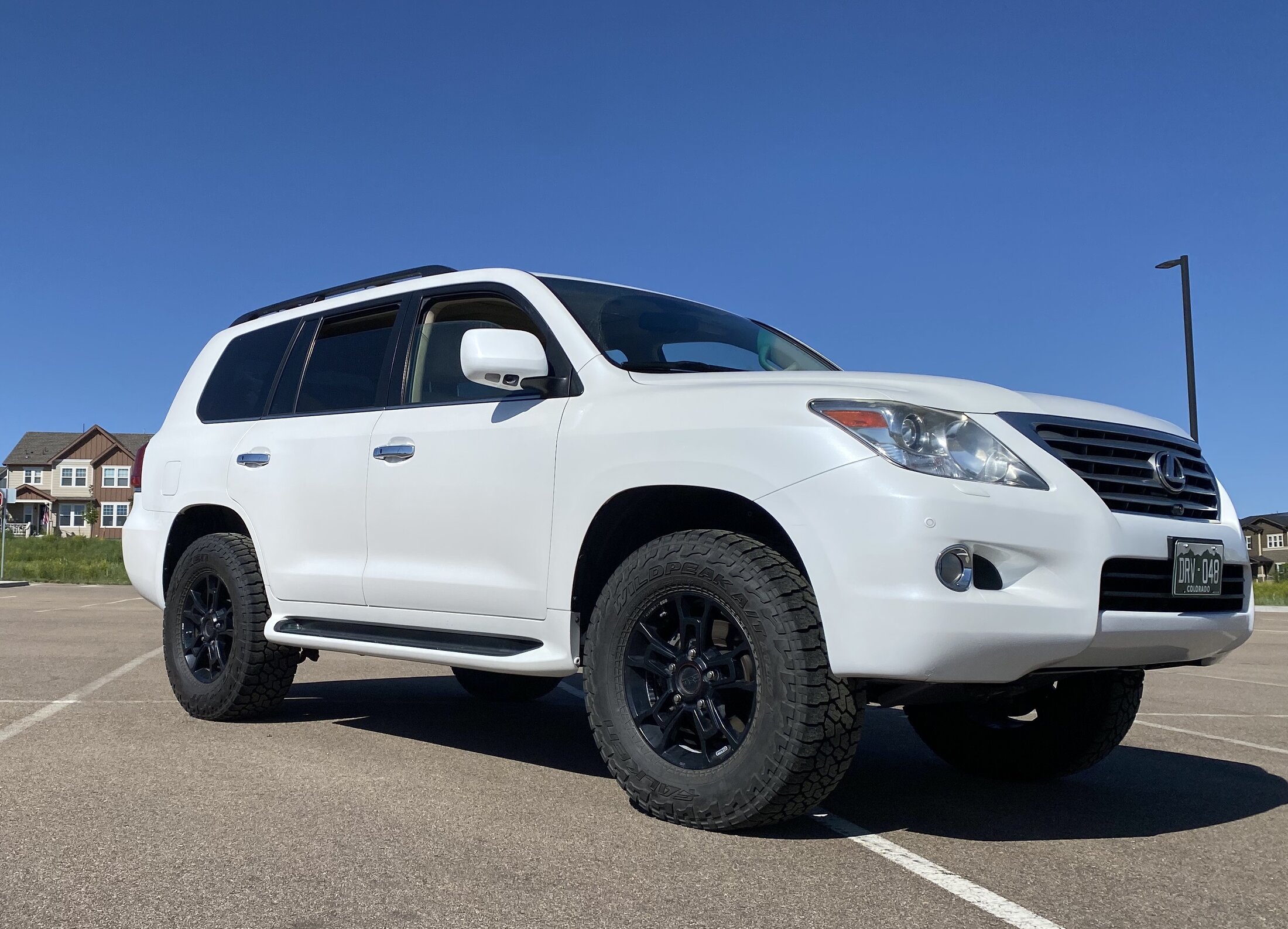

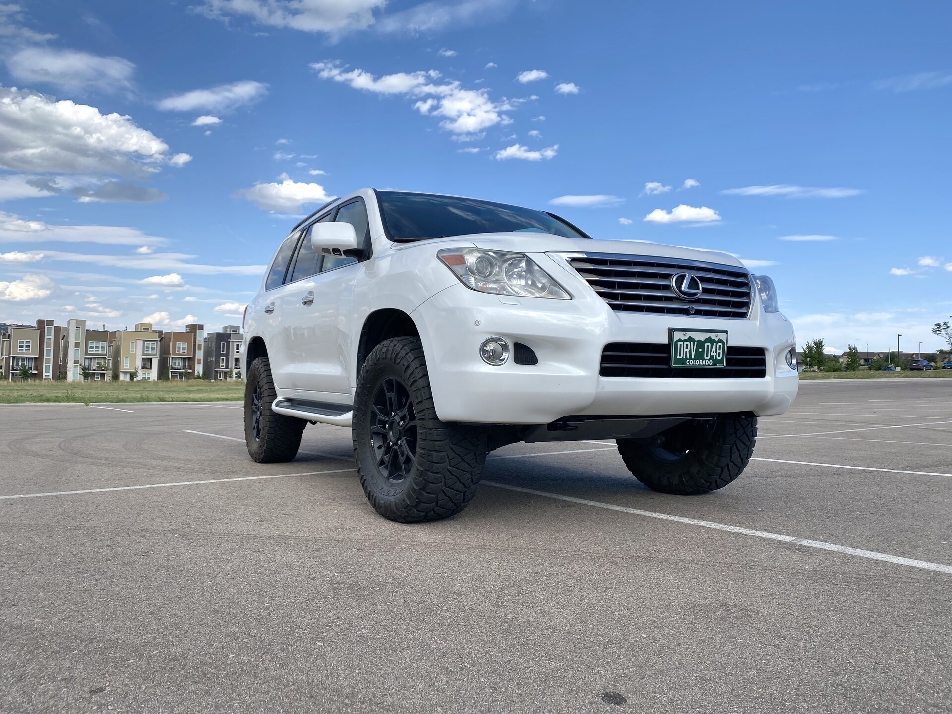

Got some new to me 34s mounted up this morning (295/70/18). Loving the look! Much more proportional than the tiny 285/65/18s that came off. Honestly not a huge difference in brake or acceleration feel either. You can notice it, but I was kind of expecting more of a negative effect.
I've got the 4 old tires in the back in this picture. Little over 200 lbs. Note the obvious negative rake from the sag. I've got Bilstein HD rear springs in the garage ready to install. Just waiting until I can get over this flu and I'll throw em in.
Got some new to me 34s mounted up this morning (295/70/18). Loving the look! Much more proportional than the tiny 285/65/18s that came off. Honestly not a huge difference in brake or acceleration feel either. I was kind of expecting more of a negative effect.
Nicely done. That's a GREAT tire size. Looking good!!
Thanks! I’m glad I went with this size, it’s perfect for most people imo. Was debating this and a 285/70/18. Went with used in case I change my mind but so far very happy with my decision to do the 295s.
Truck looks great! Love the Montero! I also had a Mazdaspeed 3 BL! Wonderful car, will never forget loading that thing full of vinyl flooring, throwing paddle boards on the roof, or going skiing! Now you have a truck to do truck stuff!
Swapped out the front 3/4" spacers for a 1" to get a better stance and to help stop the rub on my swaybar at full lock. Tiny tiny rub remains, but not nearly as bad as before. Also swapped out the normal bilstein rear springs for their HD rears. I kept the 15mm spacer on the driver side. Netted about an inch in the rear. I'm now sitting with about 1 1/2" of rake. 23 3/8" from hub to fender dead even on both sides. Easy install as these springs are about 3/4-1" shorter than the regular rate bilsteins, just with a thicker wire diameter.
Unladen, the ride is a little stiffer for sure, but I wouldn't call it harsh at all. The wife didn't notice anything which is a good sign. Definitely corners a little more flat. This should help my load carrying capacity significantly too. Last weekend I had about 700 lbs or so of sod in the rear and it sagged damn near a full 2". I take plenty of trips where I'm carrying that much weight or more so I'm hoping these will work well for me.

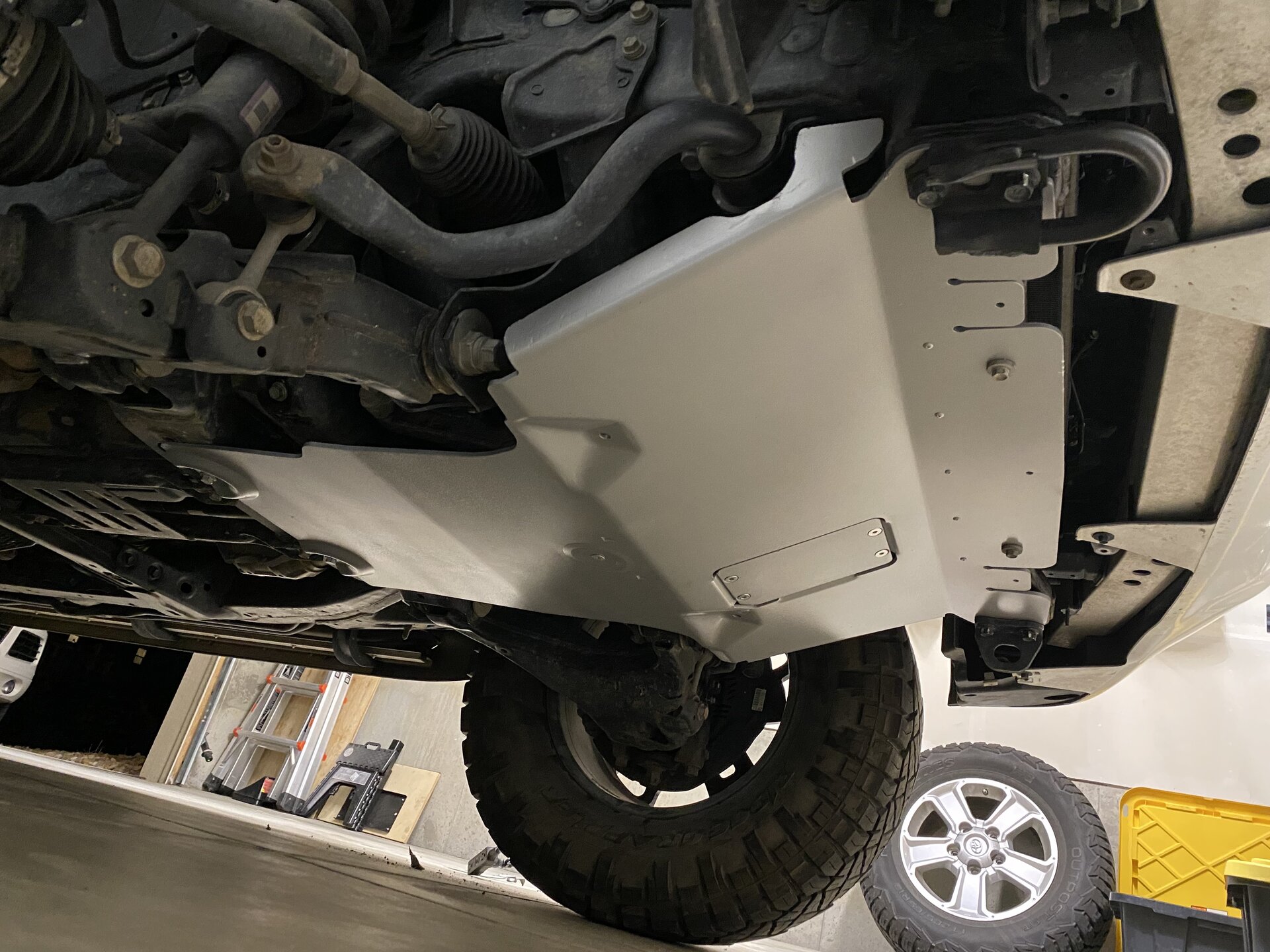

Snagged a early tundra trd pro skid plate for cheap (early ones had no letters) which fits with minimal mods. Also absolutely scored on a set of 4 tundra TRD pro wheels with 35" nitto ridge grapplers for a whopping $600! Decided to do some cutting, bashing, and heat molding to run the 35s for a few weeks for s***s and giggles then turned around and sold them for $350. 4 TRD wheels for $250 is absolutely wild. It's also a good trial run for when I eventually upsize tires again. I think I'm going to do either 285/70/18 or 295/70/18, I'm undecided. In either case, 35s were stupid easy to fit. Or I'm just not afraid to hammer some metal and cut some plastic lol.
Got some LC roof rails as well. I don't think I'd ever use a full rack enough to justify the MPG hit...though they do look good... And trimmed the engine bay heat shields because I'm already annoyed with having to take them off the 3 times I've aired up so far lol.
Great thread and love your truck.
How much modding did you need to do to fit the Tundra skid plate? Do you happen to know the part number?
Thanks!
Very minimal. I had to trim about 3/4” off the rear end to meet up with the factory transfer case “skid plate” that was it. All other bolts line up except for the two outboard ones in the middle of the skid plate. There are 9 other bolts though so I figured it would be good enough. You’d have to modify your crossmember or weld on a bracket to utilize the last two.
I don’t know the part number though. I just bought it off eBay. It’s a replica, but a decently made one at that.
