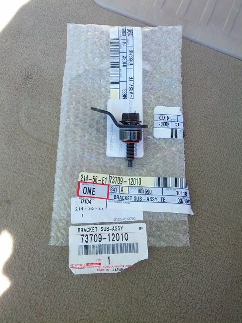

The tether + latch setup wasn’t standard in vehicles until 2001, so you won’t have any of the anchor points. Properly strapping a car seat in using the seatbelt only is fine, per SafeKids. BUT, Toyota sells an anchor that you can bolt to the floor of the rear cargo area to retrofit a tether.
Nice. Thank you! That’s exactly what I will hunt down. Where does it bolt to?

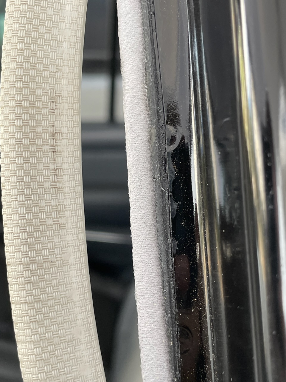

So this begs the question now. Can I retrofit 3-points from a normal car? I poked my finger into the C pillars and I can feel the hole there. Would anyone know if the captive nut is there, or is it a risk? I can’t take off the trim because it’s very carefully glued onto the C pillar so I’d likely damage it.
