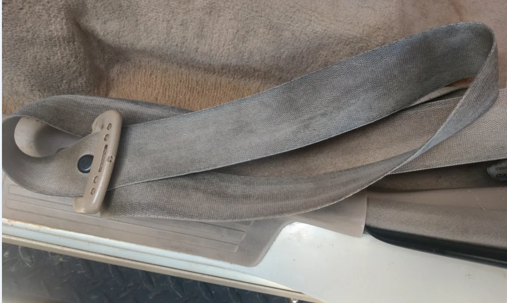

Any recommendation for cleaning dirty (17 years old) and stiff seatbelts as well as maintaining the soft/suppleness of the belt once it is clean or is a "re-belt" the only option?

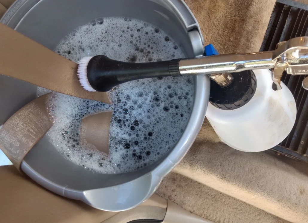

How dirty are yours? If they were really dirty you might want to pull them out all the way and clamp them to lock them in the open position and use laundry detergent and a pressure washer. Mine weren't that dirty so I just used a big bucket with hot water and laundry detergent. I let them sit and agitated it every so often. Just rinse them a few times until the water stays clean and let them fully dry before you let them retract back in.
Used a compressed-air Turbo cleaner with a bucket of laundry detergent. Now that the belts are clean, they retract like they should.
Before

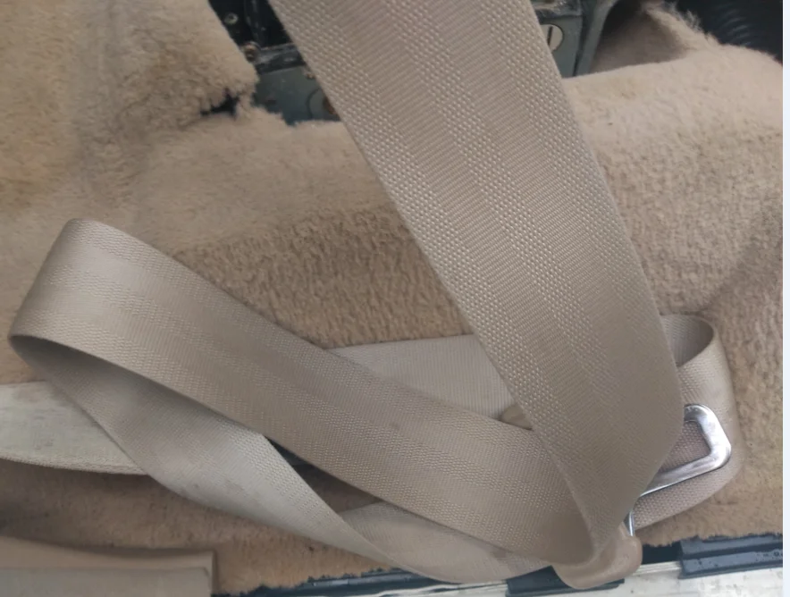

After
Perfect! Thank you all!

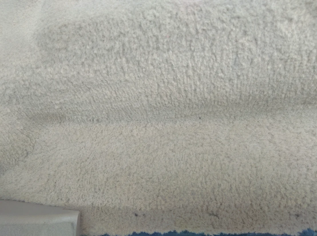

How do you like the Turbo cleaner? Have you used it for anything else other than the seat belts?
Carpet. It works well.

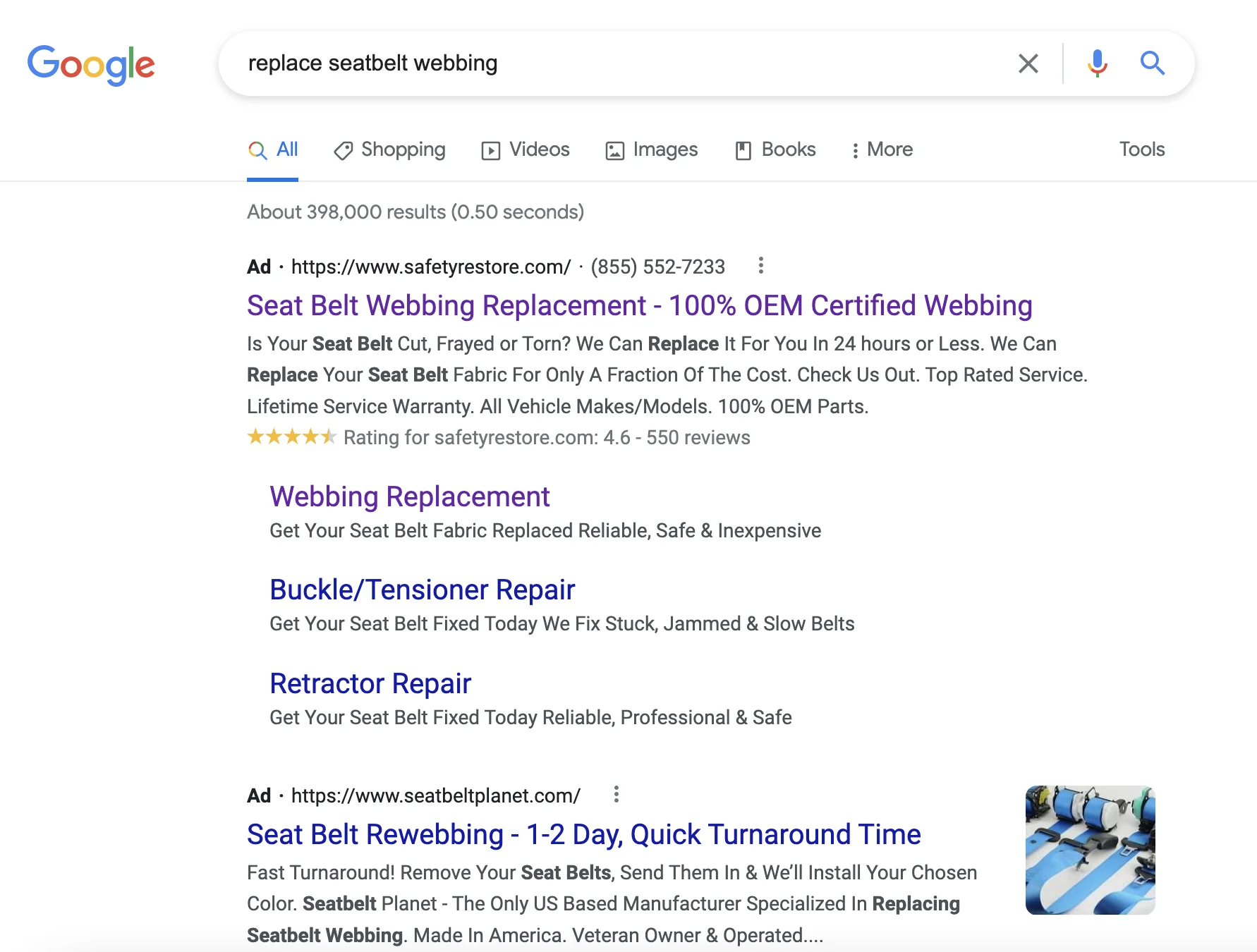

Nope but I do know there are a few companies that replace seatbelt webbing and clean/rebuild the mechanisms for about $100/seatbelt if you want to go that far
