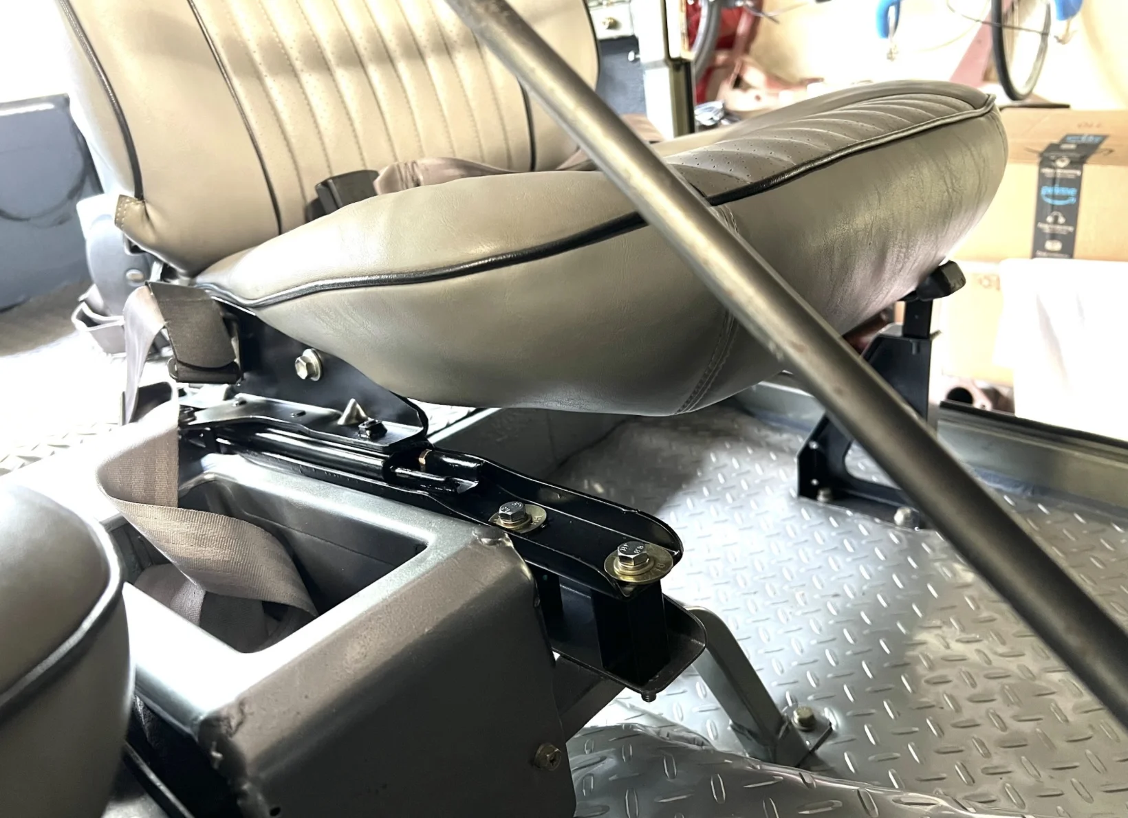

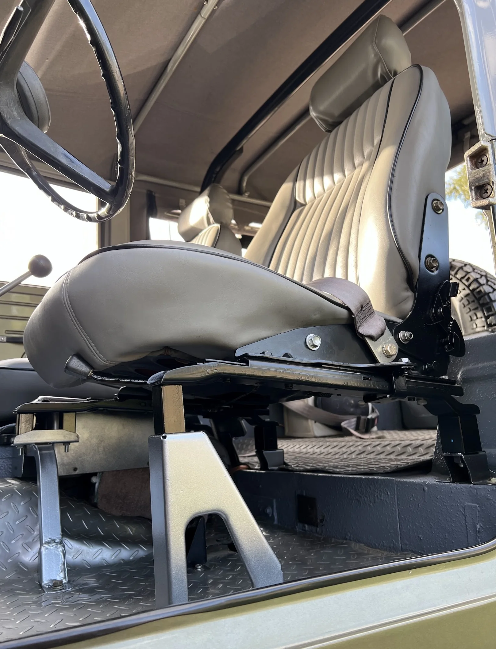

I had mine completely disassembled, cleaned, painted, lubed etc last year. It works great now. Let me see if I still have the pictures. If I recall, there’s a big steel roller inside and the tracks don’t actually rub against each other. You don’t have to drill out rivets. Oh, and mine is 1974 bucket seat.
It looks like you may be working on a 1980+ fj40 or other. I had my 1979 seat sliders apart last year and I
would avoid taking them apart if at all possible. On the inside of this channel are 2 small trays of very thin
metal. In the center of each "tray" is a roller wheel. The wheel sits loosely in this little tray. The metal on
this tray is very thin and easily bent / mangled by forcing it past the rivets. There is no replacement individual part
here if you mangle it too much.
There is a poor tactic for taking it apart by forcing these trays closer together .... and eventually you can get it
close enough to get clearance to pop the slide apart ... but I gotta tell you.....you're
going to mangle these little trays.
If at all possible get it really clean.....lubricate it a bit and slowly work it back and forth. Look for perhaps a mangled
front edge on these little trays by looking down the barrel of the slider. ... hope that it is not.
I "may" would try to take mine apart by removing the rivets if I absolutely needed to again. I'd have to look at
it closely again to see if I could replace the rivet. I did not find a good trick to get these apart without damage
to a part I did not want to damage.
I must have deleted my work pictures. As wimberosa stated, there are thin sheet metal cages for the rollers, and those are easily deformed as you go through the process of cleaning the rails. But they are also easily re-shaped as well. It’s a test of your patience to get them sliding on both rails correctly. Once you get the rails sliding the bolts can be removed. Align the holes in the rails with the bolt heads to get your socket on the bolt head. Be very careful to keep all the pieces, including the bolts, in the correct order of where they came from. Some of the bolts are slightly longer or shorter and have to go into the correct blind nuts or it won’t reassemble. There’s a spring loaded latch that engages the slots for the adjustment settings. I held that locked open with vice grips to make the work easier.
