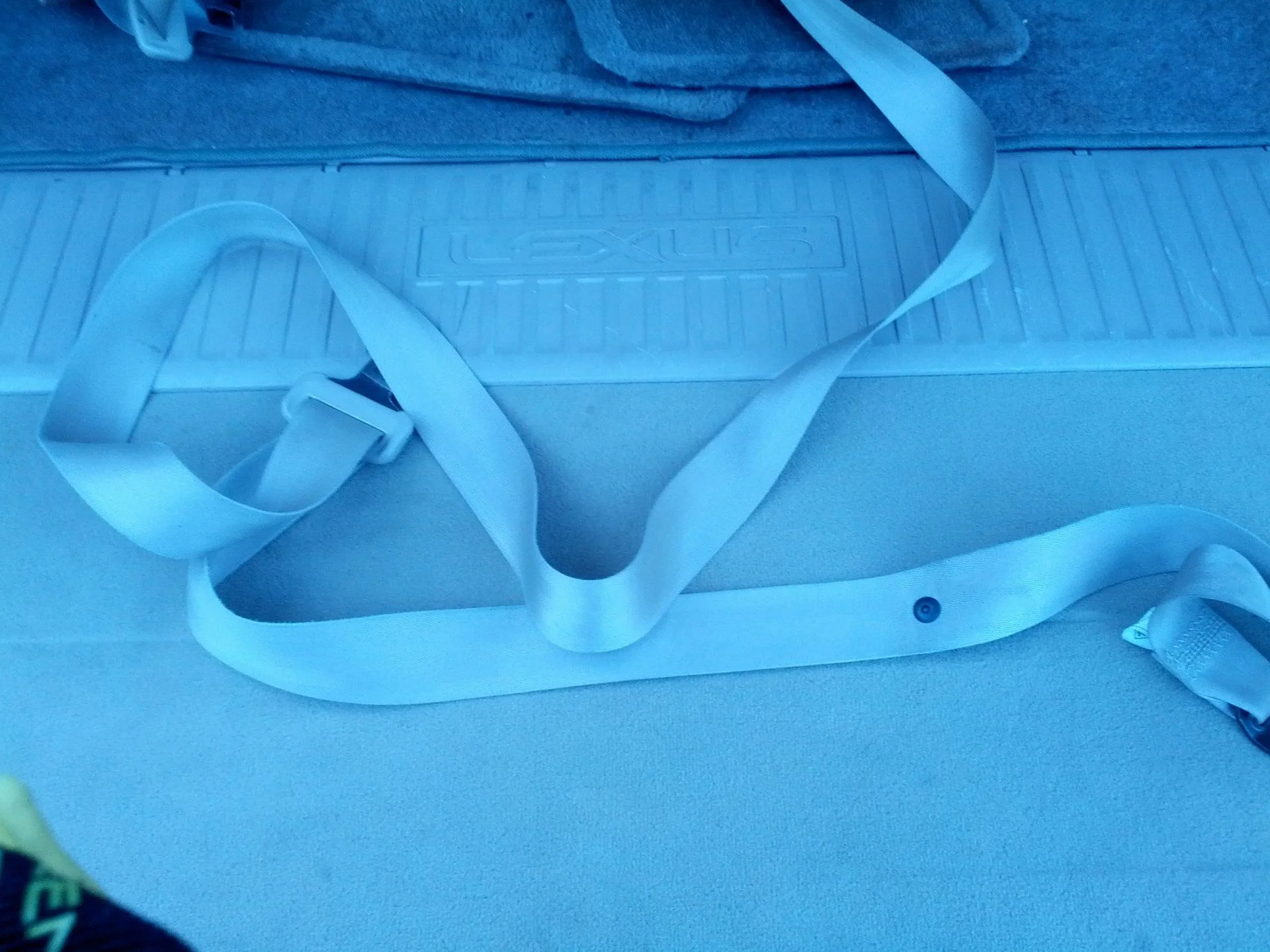

Hi all,
Another questions stemming from a '98 LX. The interior is on the dirty side (this is sarcasm).

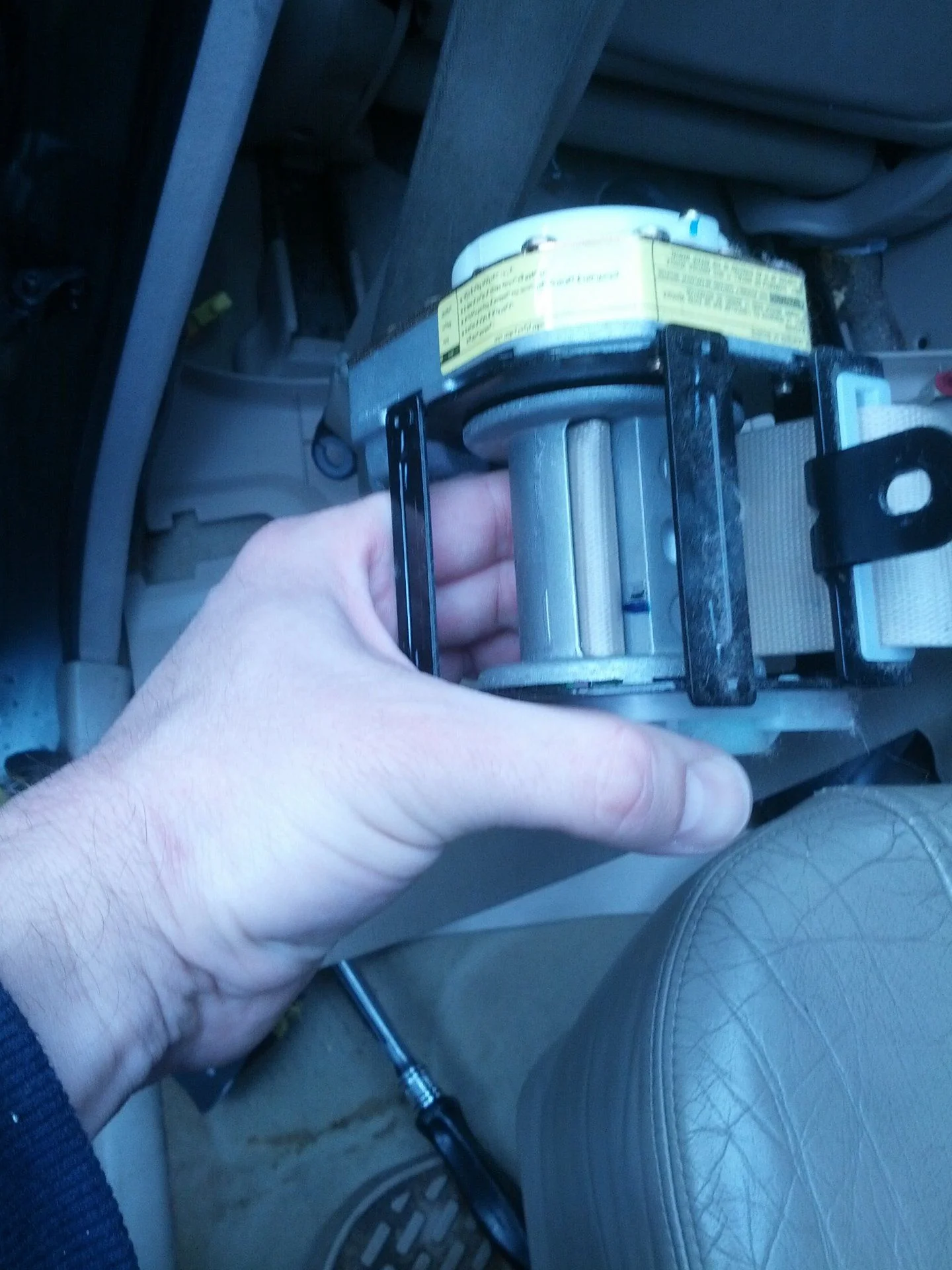

The drivers belt is exceptionally dirty and barely retracts. I pulled the side panel and the retractor, but I can't seem to figure out how to remove the belt from the retractor. I pulled the pin, but can't get the belt out of the cylinder. Before I destroyed something too bad, I stopped. Can it be removed? Easily?
How can I remove the shoulder anchor?

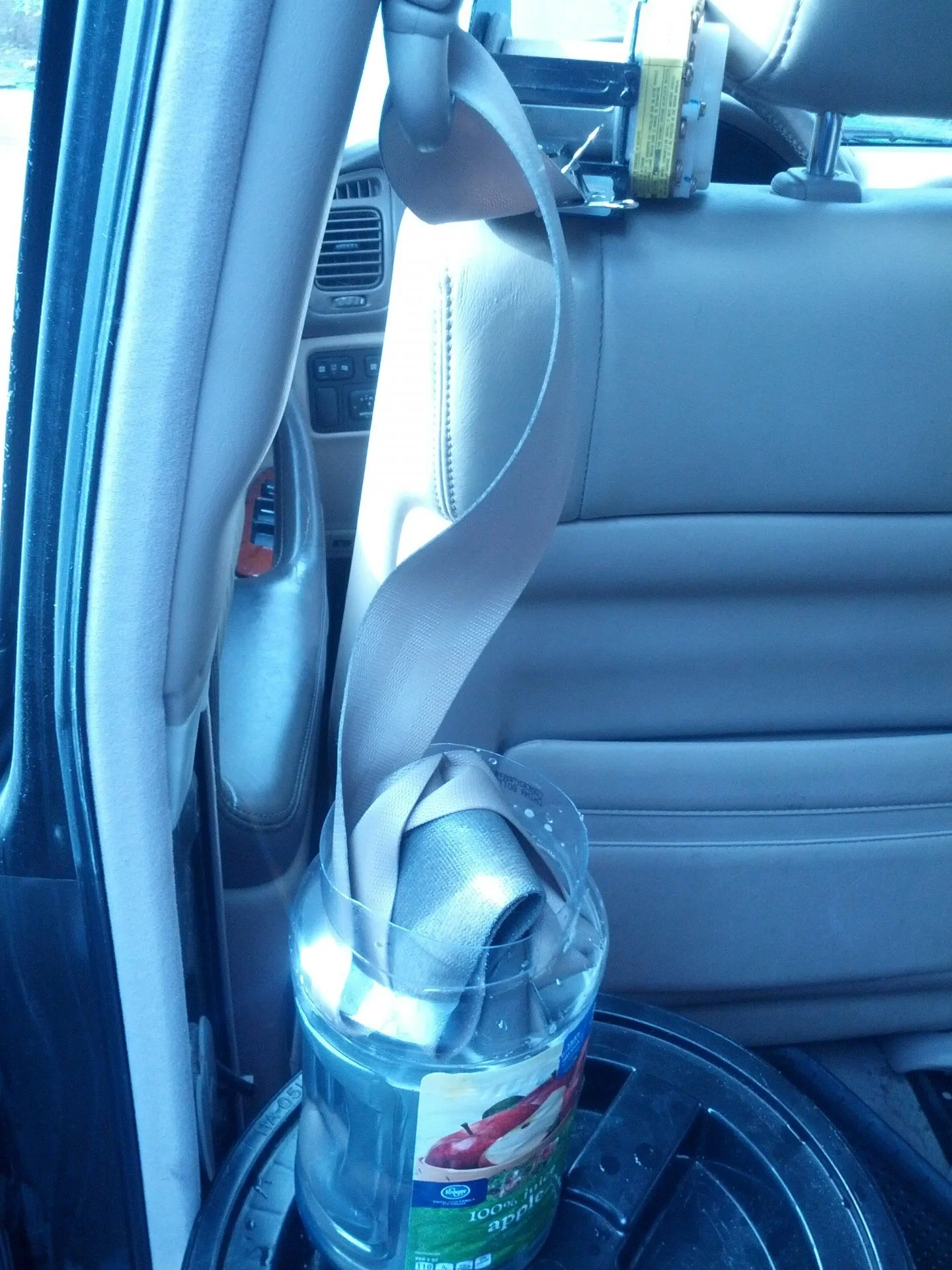

This is my current attempt at cleaning it while still attached, hot water with laundry detergent, propped up on a bucket as to soak as much of the belt as possible.

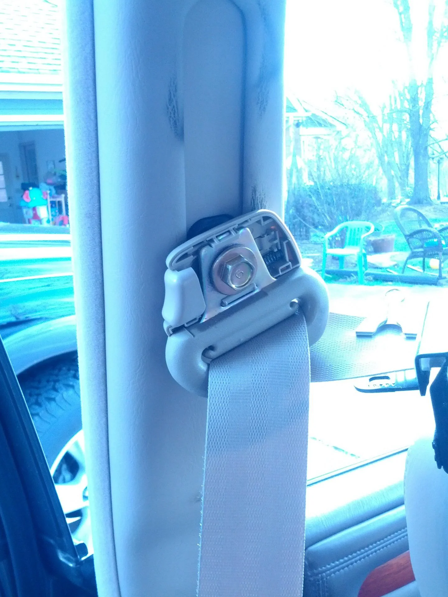

I found how to remove the top pivot point.
Now, hopefully I'll find how to remove the belt.
I gave up on removing the belt. I bagged the retractor and pressure washed the belt. Three out of six done so far. They look great.

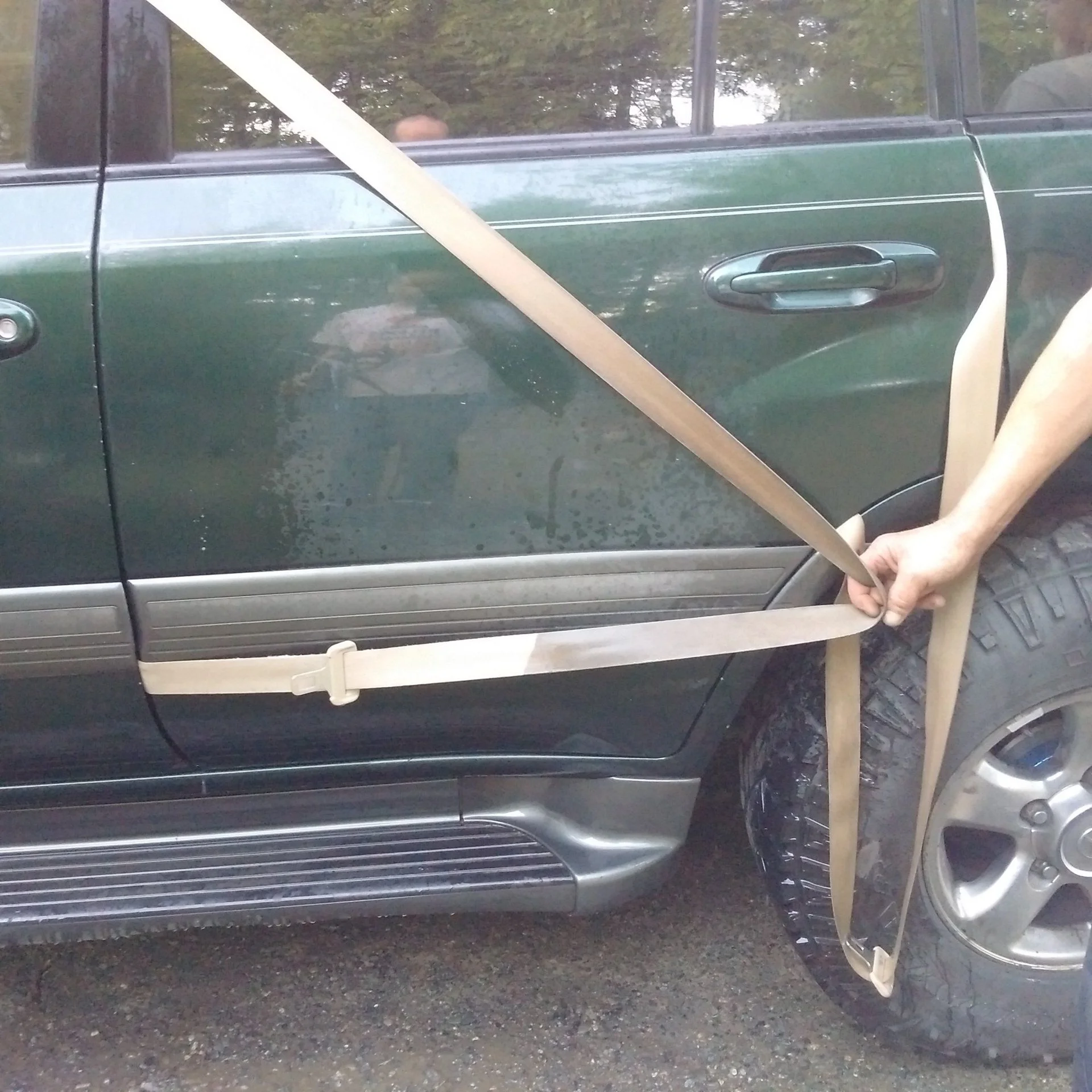

I put front belts back in today. Night and day difference in the belt feel and retraction. If you don't want to pull it all the way out, unbolt the bottom anchor and extend the belt outside the truck and close the door. Clean/pressure wash from there will make a remarkable difference too. That's how I wound up doing the second row and how I'll do the third row.

I also gave up removing the belt from the retractor. I suppose you could just cut it and sew another loop for the pin, but I went the direction you did. I added a little degreaser to the soap bucket, soaked for a few hours, rinsed with the pressure washer and then let dry in the sun for another few hours.
They came out looking brand new, retracting better and felt much softer. I wish refurbing everything else on my truck was this easy.

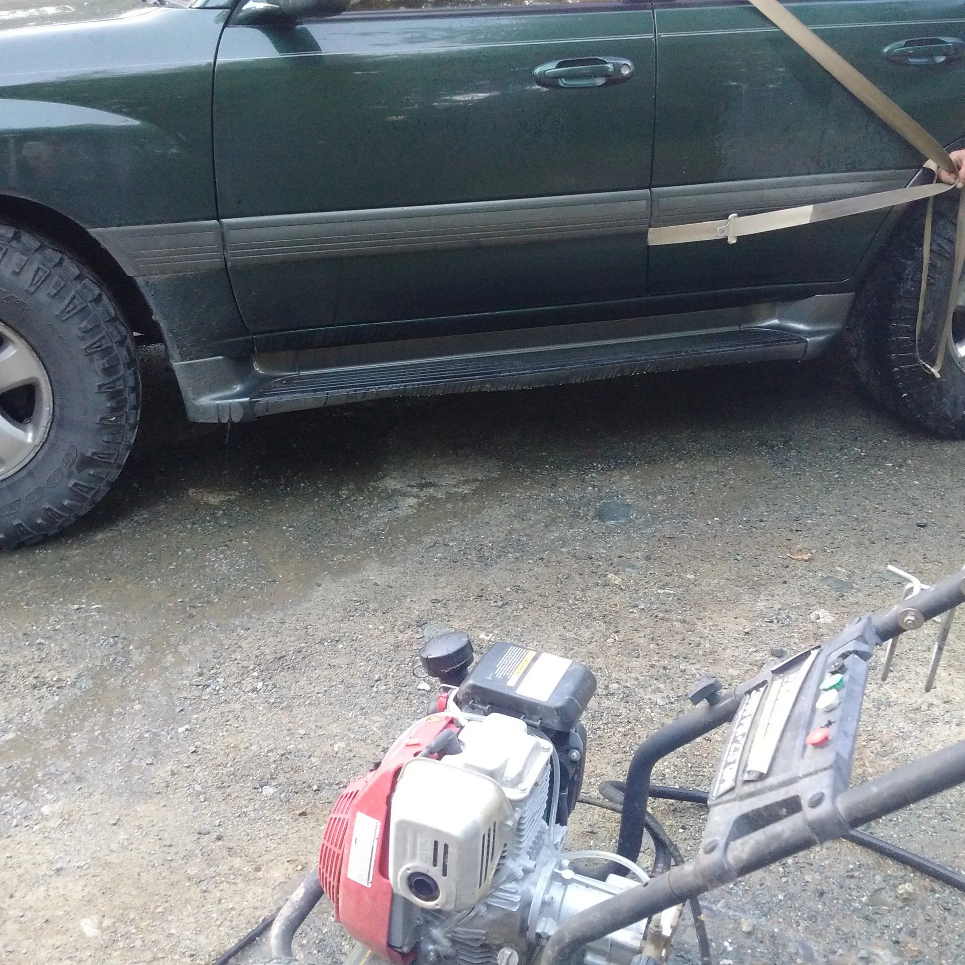

There is only a small section that gets dirty so removing them is probably not necessary. I took the easy route by extending mine out as far as they would go, closing the door and pressure washing them.
Couldn't believe the amount of grime that washed off. They now retract like new, and look like new.
Unbolted mine at shoulder and flor-point. Extracted as much of the belt as possible, used a paper fold back clip to keep it extracted. Put the belt into a bucket of soap water inside the car for the night. Next day rinsed several times and dried with a towel. Now they work like new again.
My advice is do not disassemble the retractor or modify your belt in any way. It's not meant to be taken apart and that part of the belt will always be hidden anyways.use mild detergent if any, and replace the belt if there is any visible damage/fraying.

Agree, only a small portion at the floor that you can stand on the running board or slider and pressure wash with the door open, the rest is easy with the door closed and a helper holding the belt and buckle and flipping it around against the body.
I Castrol Super cleaned the belts on both sides of the webbing and let them sit while I warmed up the pressure washer.
These pictures should tell all. Amazing, you just don't realize how grungy this stuff gets after 15+ years...
