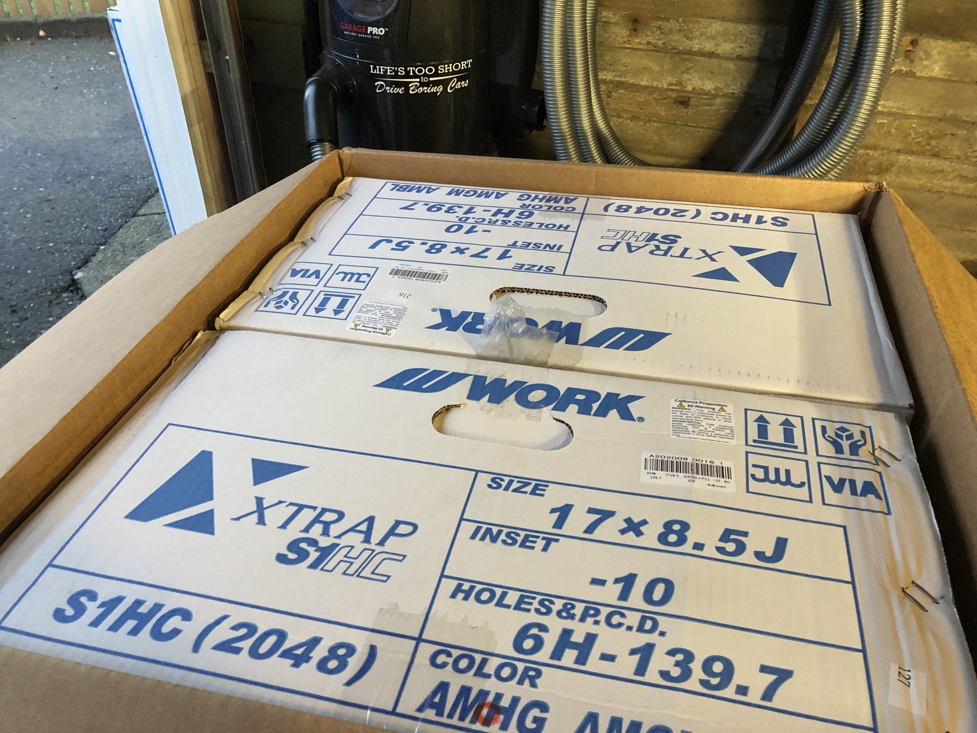

Wheels for the GX. We have had many sets of Work Wheels on cars over the years and always loved them. Not sure if im wild on the color but we will see, I think they will look good on the gunmetal with the chrome blacked out. I guess they can always be powder coated in the future if I dont like it. They come with white stickers but ordered a black set from Work to use on the wheels.

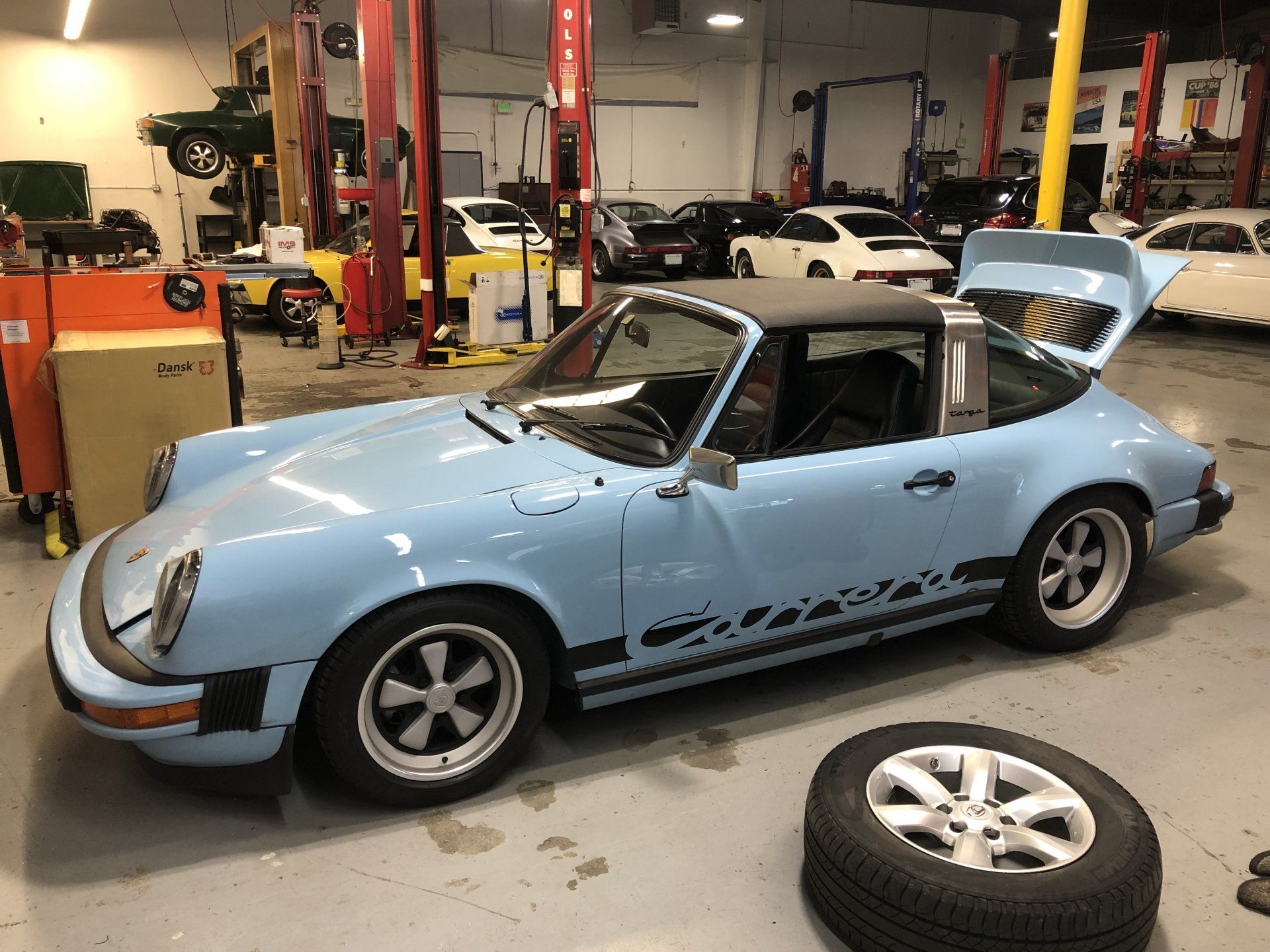

Have had the lift sitting in my garage for a while and finally got around to installing. Space was open at my brother in laws shop so installed there as opposed to in my garage on jack stands. Happy that I did because the passenger front was a bitch. Everything else went pretty easily.

I would kill to have access to a lift!!

They do a lot of air cooled Porsche in that shop. Its always amazing to go in there and drool over all the neat cars. One day I will get one lol
Good tip on the Vline group buy. IMO its overpriced at the non group buy price for what it is, there just arnt really any other good options.
Yeah I agree, but when you are the only game in town (and they are), you can name your price. All of the research I did on the Chinese Tesla style radios were not well received.
Very cool shop indeed!
Love the Targa! 😍
That little black nine-fourteener sitting up on the rack in the back reminds me of the one I had. It was a '74 that I dropped a 2.2 liter in it along with 911 suspension, brakes and wheels all around. It was like a street legal go-cart!
Im currently in the process of trying to buy a 69' 911 that I found at a guys house my company was doing some work for. I love the older cars just for that reason, they are like go karts. I have a 93 Civic hatchback stored away that I have owned since 2003, that was the last "gokart" like car I have owned and want another! Much more fun that all the computer aided cars now imo
